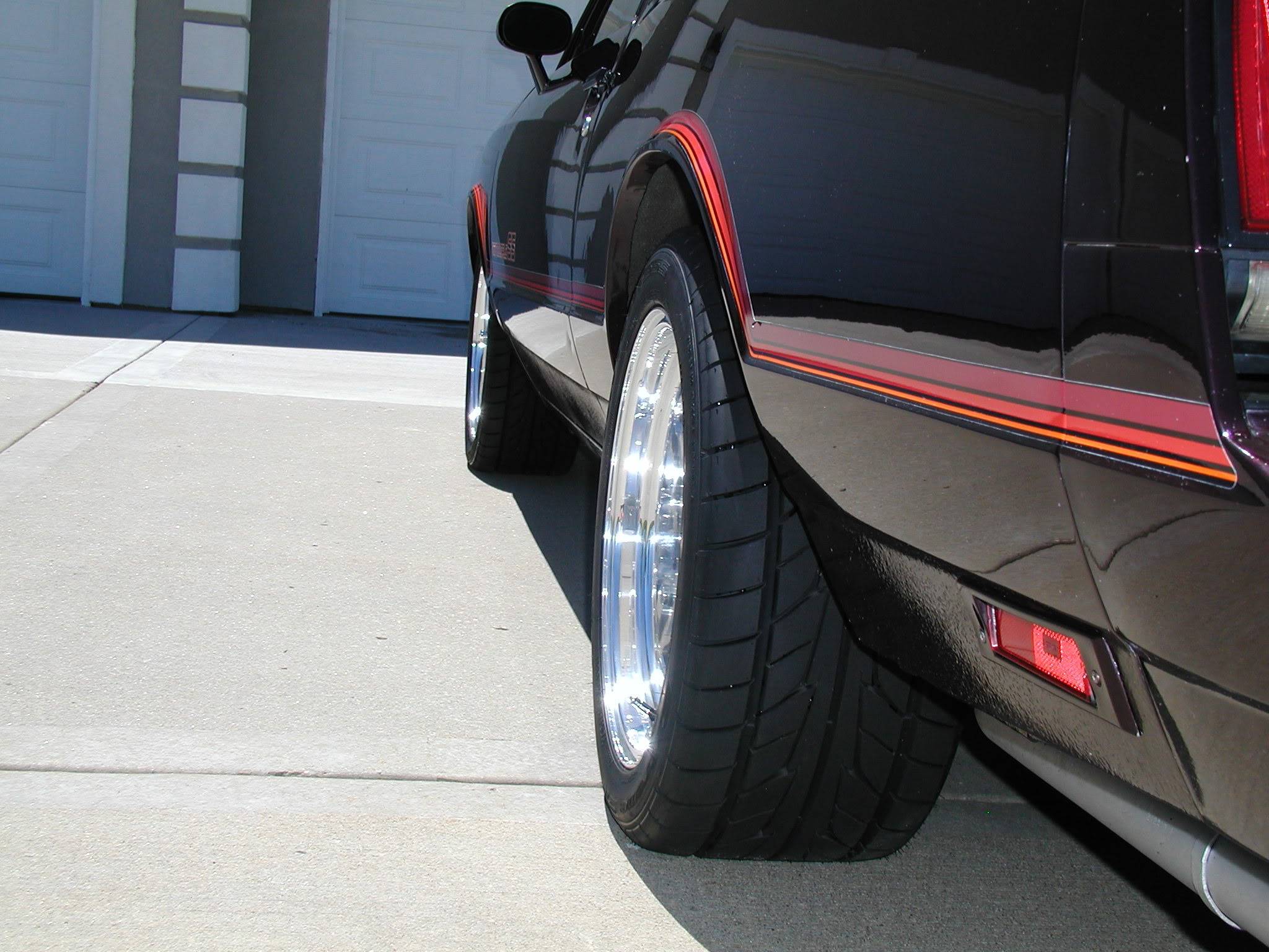

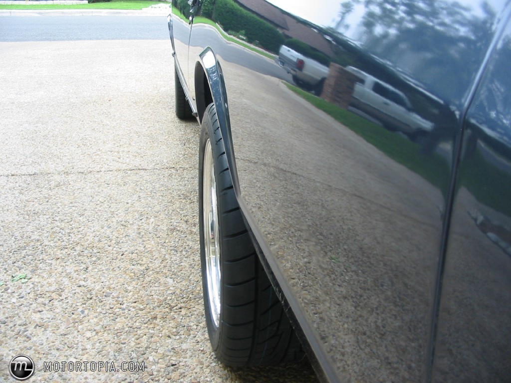

      Here are some pics, not all brands of the same size fill out the same, the BFG KDW NT
      I found to run a little rounder around the shoulders, the Nitto fill out more - IMO
      1) BFG KDW NT 275/40/17
      2) Nitto 555 Extreme 275/40/17
      3) Nitto 555 Extreme 285/40/17
      all on 17x9.5"
      HTH
      2) Nitto 555 Extreme 275/40/17 (courtesy of another member at MCSS.com)
      Dave
