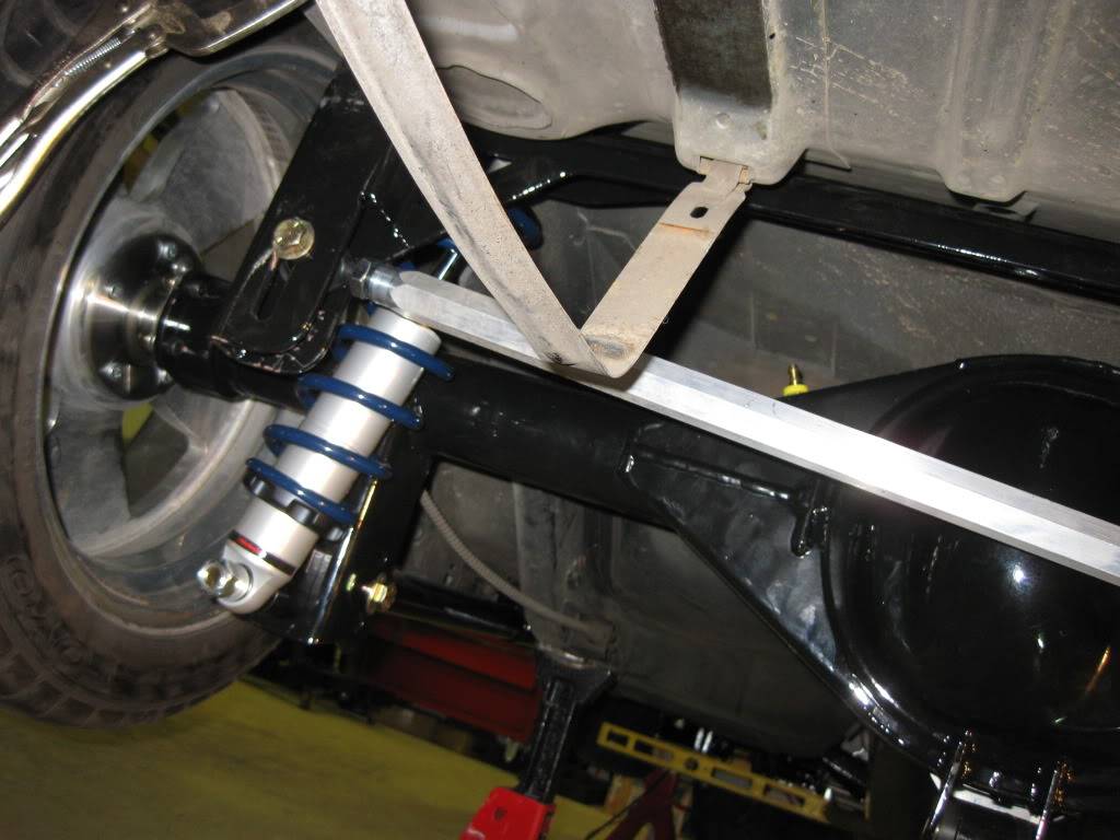

      Ride Tech Coil overs (500# fronts, 250# rears)
      ATS spindles, power rack, speedtech alum body mounts.
      Torque arm rear, with ridetech coils.

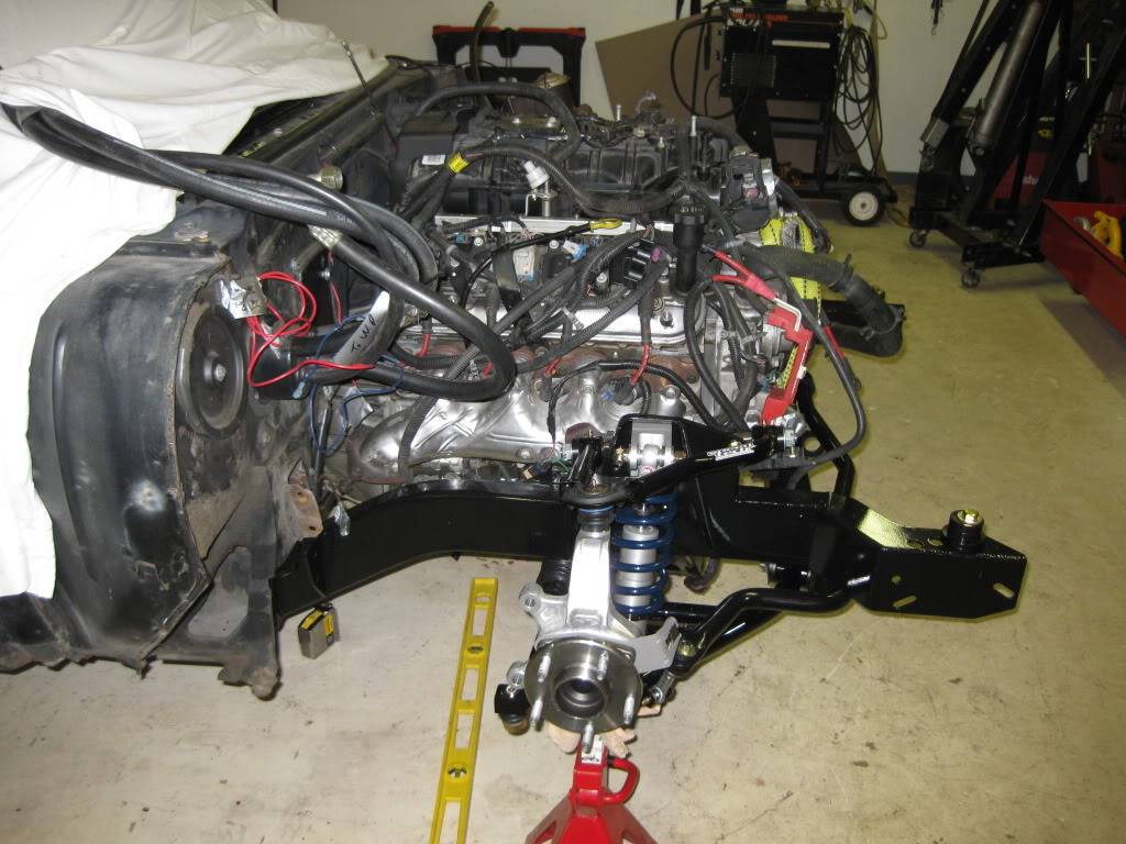

      Engine:
      L92 which will soon receive an LS3 intake.
      Still need to relocate the AC compressor

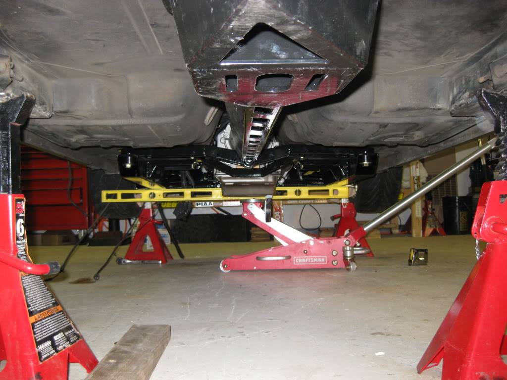

      Tranny:
      6L90e 2WD tranny with splined tail shaft.
      need to find a shallower pan, or modify a 6L80e G8 pan (for an extra .8" of clearance)
      Still need to have a drive shaft made.

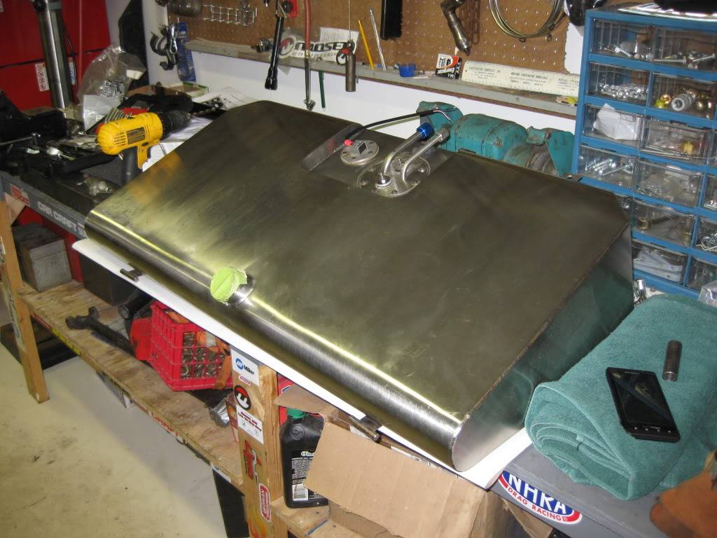

      Gas tank:
      Rick's SS Tank.

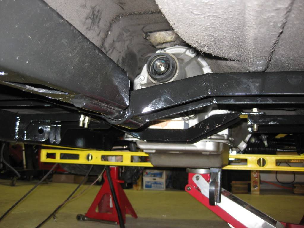

      Currently my Front clip and hood are in my front porch (I needed room!), and I am in the middle of putting the rear suspension in. Everything has been going rather well, and I was able to fit the 6L90e in with out cutting the tunnel apart (Thanks to Champ Pans and the speedtech sub frame).
