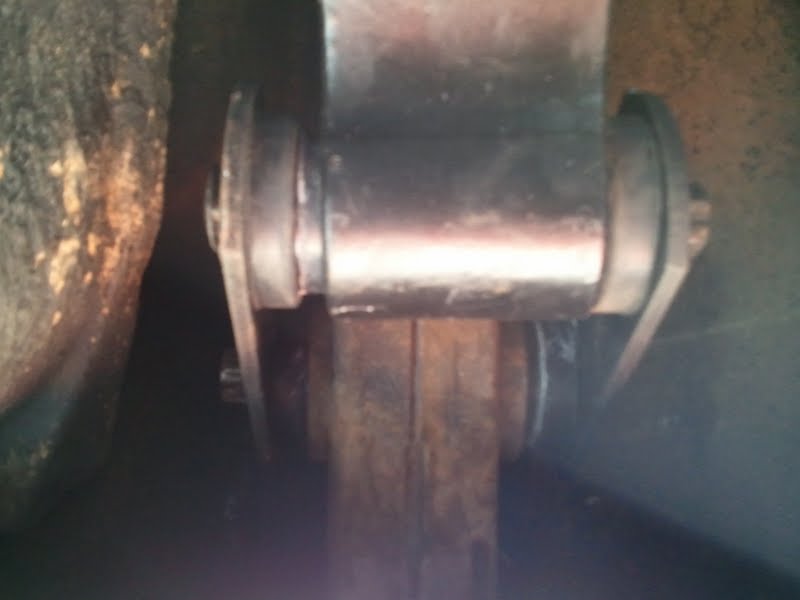

      I am installing new multi-leaf springs and the new bushings I got appear like they may be too long.
      The bag the bushings came in say "Hugger Performance Specialty Muscle car Products - Part #K00044 Rubber Bushing For Rear Spring".
      Each bushing measures about 1/16" longer than the orginials before the mushroomed head, but I realize the old one's were probably compressed. When I put them in the spring or frame, they touch each other and there is still bushing surface sticking out past the frame or spring eye.
      In this picture the nut is tightened up just enough to touch the shackle plate (no thread coming throug the end of the nut).

      Will they compress down when I tighten them or do I need to trim them so that the mushroomed head is flush before tightening?

      Had this same issue with Energy Suspension Polyurethanes. When I had put them in, there was air in one of them, and so it popped out. You just have to crank down and it'll compress.

      with some cars the longer bushing goes into the spring and the shorter ones go into the frame section. I like to shorten the bushings up so the metal inner sleeve is a bit longer than the bushings to prevent binding.

      There is no metal inner sleeve in these bushings. I guess I will try cranking them down and hope they compress.

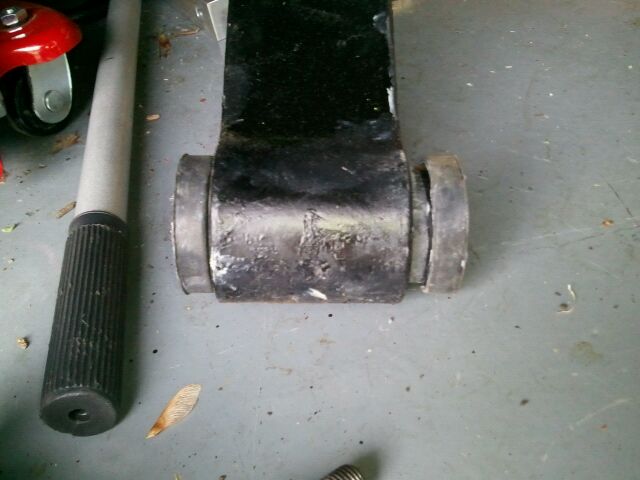

      Well I ordered new bushings from Classic Industries to be sure I had the right parts (Part # K979 - Rear Shackle Bushings for 67-69' Camaro) and they are the same length as the one's I have.
      When I put them in the spring eye, both bushing touching, and have one bushing head up against a side of the spring eye there is about 1/4" sticking out the other side before the bushing head. Crazy.

      I guess I will just trim one side down so both bushing heads are touching the spring eye, but it seems weird that both companies have bushing that are too long. That needs to be fixed.
