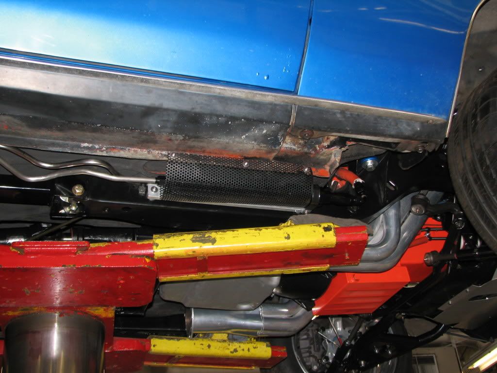

      I was worried about fuel overheating and plumbed in a inline fuel cooler on the frame rail:
      Its a 12" long Barry Grant inline with -10 fittings, but flexlite makes some framerail ones too. BG claimed a 90* drop, dunno about that but I figured on the framerail at any speed should be worth some reasonable amount of cooling.
