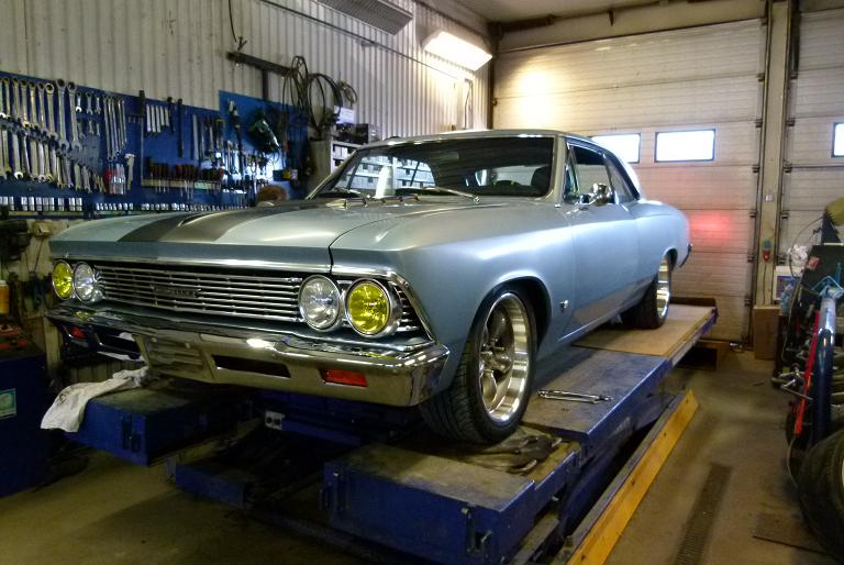

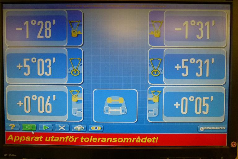

      Got the car back from alignment shop.
