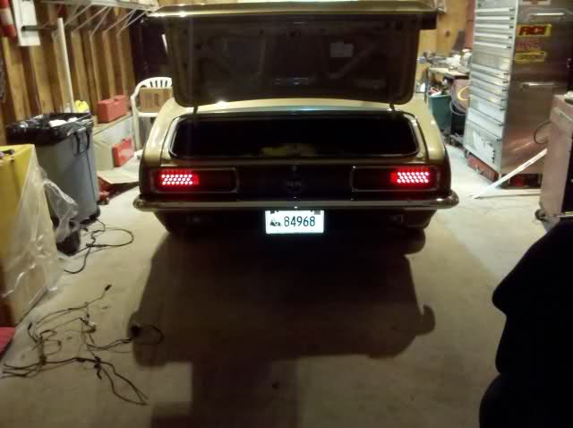

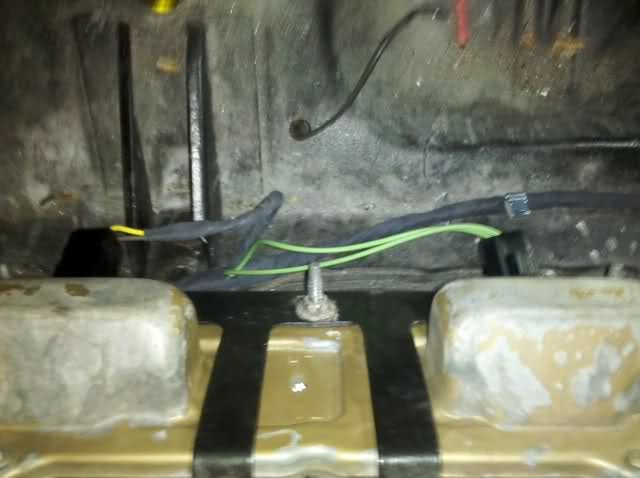

      I recently changed my damaged rear harness and installed a new one. I am having problems getting 2 of the lights to light up. I know the led lights are good they work in the other sockets. the 2 sockets that are are not lighting up are solid green wires. On the drivers side there is 2 green wires going into the pig tails and on the passenger side there is only one green wire going into the pig tail. What is odd the blinkers, brake lights, lights on, and emergency lights all work on the taillights that are working. Any help is greatly appreciated.
      Thanks Nick
      Driver side viewed from above the two green wires are not lighting up
      Passenger side from above again single green wire is not lighting up
      and how they look out behind the car

      I was online trying see if I ordered the right part. Is there a difference between the a standard harness and a RS harness? One thing i noticed about this is there was no rear back up light provisions.

      Normally green, in the tail light harness, would be reverse lights.

      That could explain why there are no reverse light provisions. I didn't know there was more than 1 rear taillight option for 67 coupes. I ordered a different harness that is listed as RS coupe. Hopefully its right.
