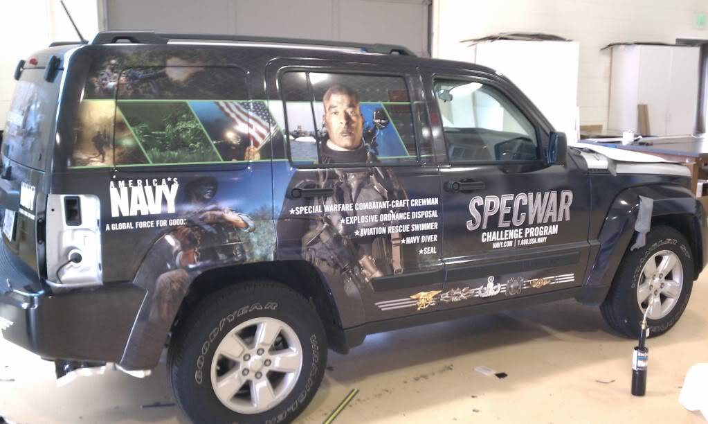

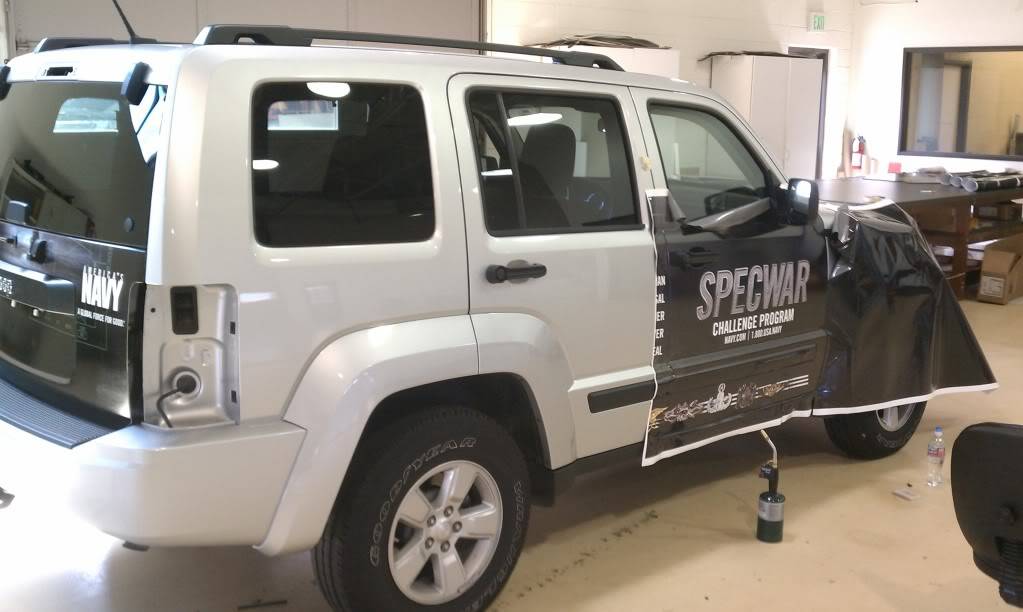

      Here's a wrap I did for the local Navy recruiter.
