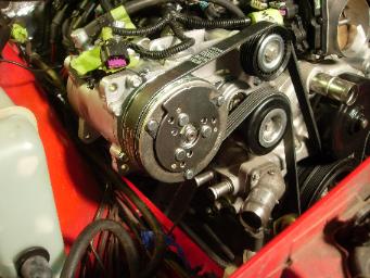

      Vette Accessory Drive on LS Engine in G Body
      Scot:
      I used the Vette accessory drive package on my LS3 Monte with CTS-v oil pan and ac. The fitment was good...had to notch the frame and crossmember rails clearance for the ac compressor and also the ac lines...can send pics if necessary. Do you intend to run ac? If so, get a Pontiac or Buick G-body condenser coil....the outlets are on passenger side of car as opposed to Monte w/ outlets on driver's side.
      Can't help w/ spacing the Vette acc package out for VVT, but attached are helpful links w/ dimensions for both the Vette and your existing truck acc package.... Mast is the only supplier I know of that supports VVT.
