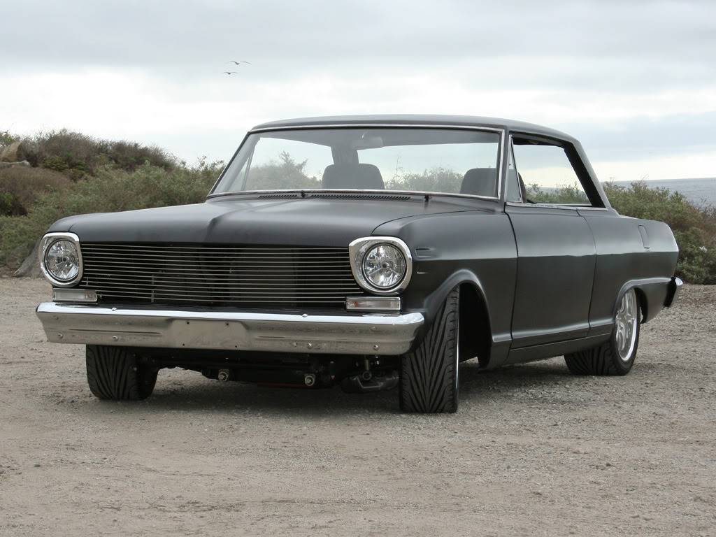

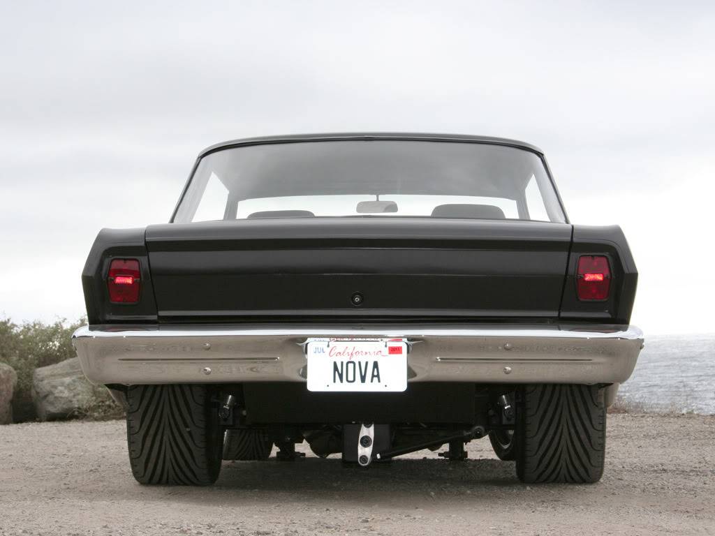

      And I did a tremendous ammount of research when I was in the market for wheels and tires. I had massive ammounts of room in the rear. And I wanted 315 tires. YES, you can mount some skinny sumitomo 315s on a a 9.5" wheel. And those tires would look stretched on a 11" wheel. But, you cant mount some regular sized 315s (GY, BFG) on a 9.5" wheel.
      Alot of the mustang guys will use sumi's on 9.5" wheels and they look good. I dont think Ive ever seen a GY or BFG 315 on a 9.5" wheel. Why? Prolly cause they dont fit right.
      Not all 315 tires are the same. JR
      GYs and Sumi 315s YES!! They are both 315 tires. Want some steam rollers with a nice "small" side wall, the GYs are pretty nice.

      Thanks for the pic, that is quite a difference. I knew that there were variations brand to brand but that is substantial. I was planning on BFGs or Contis. Maybe I'll go see my tire guy and order up 2 275/40 and have them mounted, then I'll be more sure.

      I settled on 10" wheels and 285/40 tires because I couldn't afford the next size up in the wheel that I wanted which were 12" wheels. Nuther 600 bucks a wheel. I really wanted 315 tires, but I could not swing the cost for 1200 wheels. 2400 bucks for two rear wheels didnt fit in my budget. Specially when I still have some other expenditures, like some real paint and an interior. Money is tight these days. JR
      The 10" wheels and GY 285 tires. Not too bad, they hook up pretty well in the turns. My lil 350 will still cook them in the second gear swap from the 700-r4.
