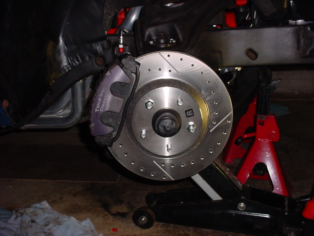

      OK then, does anybody have a pic of the C4 rotor with a C5 caliper, thats supposed to be the hot swap, anybody? Bueller?
      Delaware, OH
      1,379
      Here are a couple Steve. Not the best pics in the world, but C5 calipers w/C4 rotors nonetheless.
      http://www.danhardison.com/discs/DSC00661.JPG
      http://www.danhardison.com/discs/DSC00869.JPG
      Dan

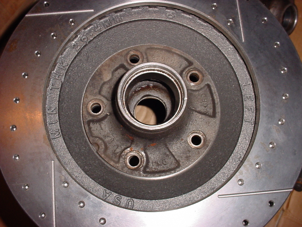

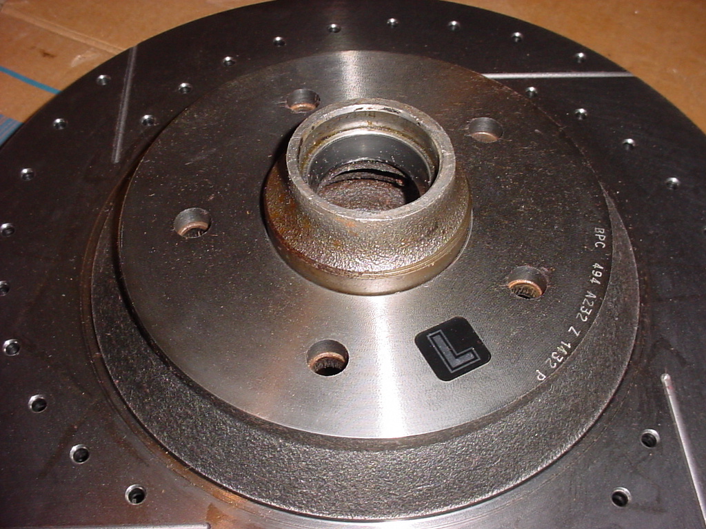

      Thanks Dan, I think I have the same, do you have any shots looking straight at it or a angle shot? I'm trying to see the hat part of the rotor, Thanks again, Steve
      Delaware, OH
      1,379

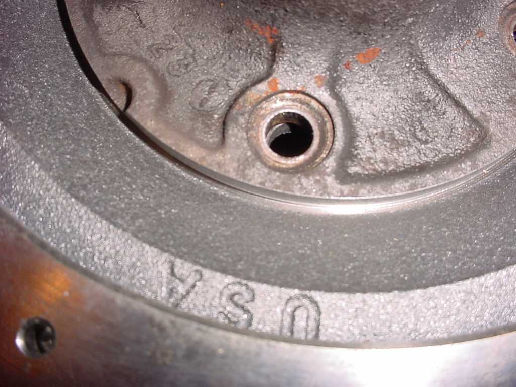

      Steve, I have a few others that show the drum hub mated with the rotor. I'm going to be pulling the rotors soon to paint them (rusting), so I can take some add'l shots then if you like.
      http://www.danhardison.com/discs/DSC00496.JPG
      http://www.danhardison.com/discs/DSC00497.JPG
      http://www.danhardison.com/discs/DSC00498.JPG
      http://www.danhardison.com/discs/DSC00412.JPG

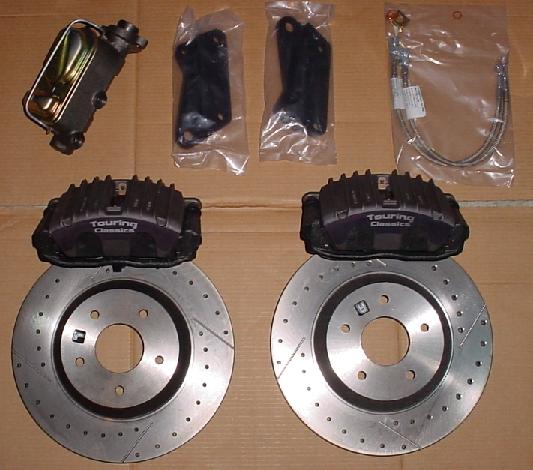

      Thanks Dan the 3rd pic is what I was looking for, and the BPC codes are close on the rotors, the 13" C4 has a addition to the hat, it adds a little metal, compared to the C5, Now to order the brackets, who did you get some from? Thank Steve

      I bought the entire kit from Touring-Classics (http://www.touring-classics.com), but they sell the front caliper brackets separately as well. Tell them I sent you!
