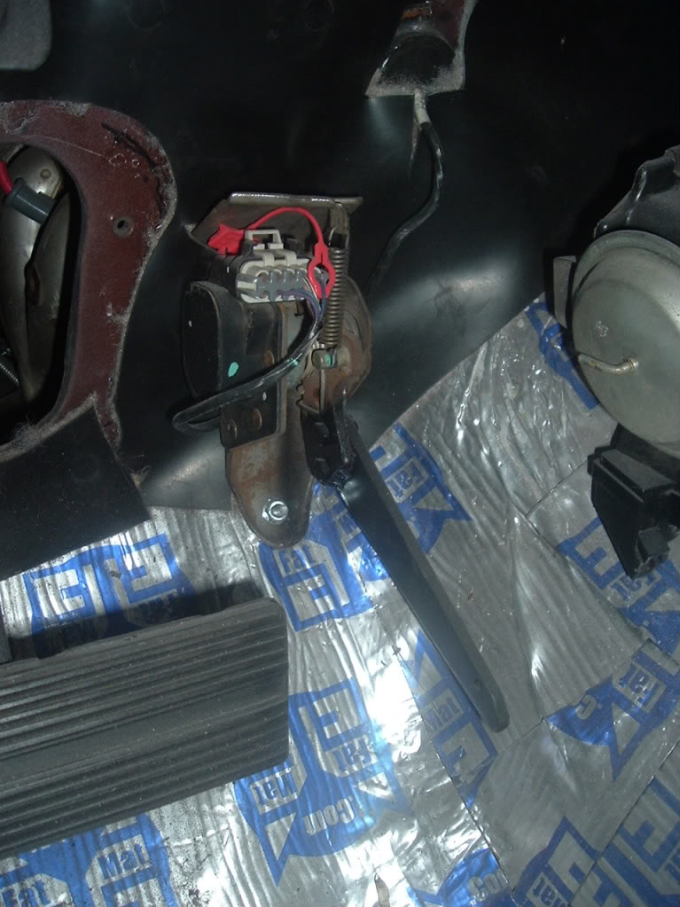

      FWIW I modified my truck pedal to fit my car by cutting off the arm and making my own in the correct lenght with a piece of 1/4" steel.
