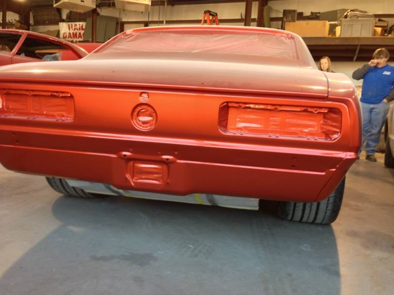

      sorta combining bmw valencia orange and prowler orange
      we have a hint of color

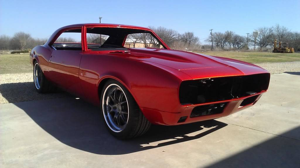

      Next im going to slam the car and test for any and all clearance issues. I was told a 18x9.5 wouldnt fit on the front without rubbing. Well my fronts are 18x9.5 with 6.375 backspacing and the front very low there are no rubbing issues ")

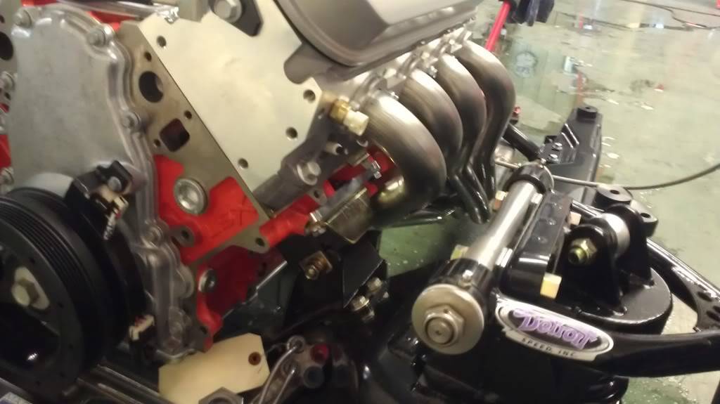

      and engine is trans is mocked up on my buddies 69 dse subframe
      its close so we are going to have to tilt the engine up some or mod the crossmember. chances are the crossmember will get flattened out.
      the adapter will need to be turned the other way. currently its touching the headers
      Overall the SW header clearance is amazing. they fit perfect in the subframe.

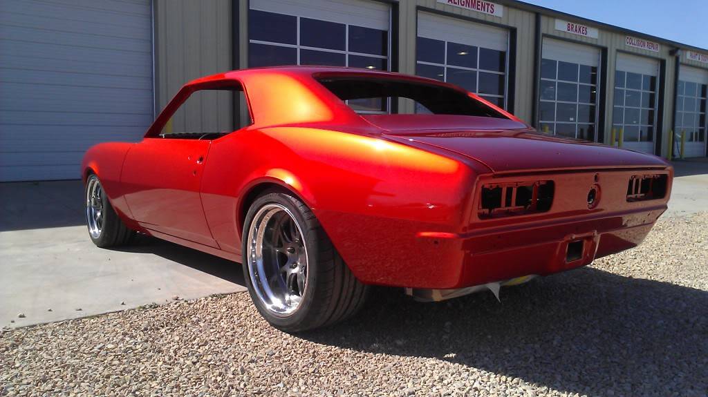

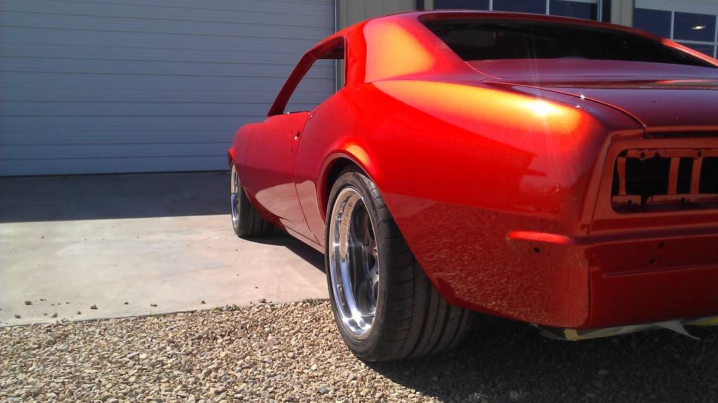

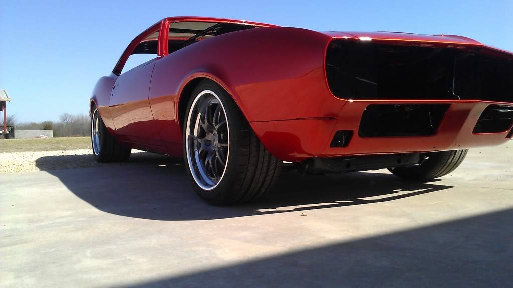

      car is now lowered, rear end is set in the correct location, car is slammed to the ground and no rubbing issues at all. I pulled the front inner fenders just alittle and i have plenty of clearance. I know DSE wants you to run a 18x9 on the front but i went with 18x9.5 at 6.375 backspacing and its PERFECT !!!!
      and i love this pic.
