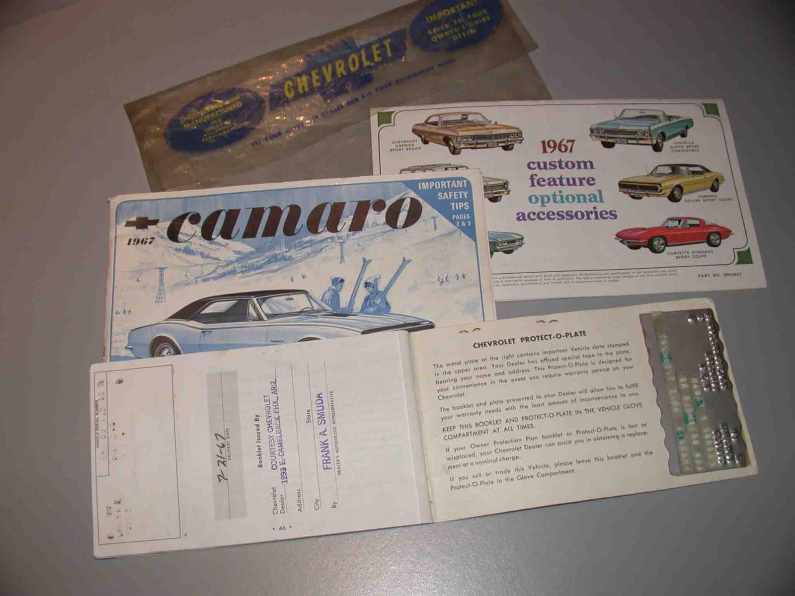

      I forgot to show the original paperwork for the car. The purests will be going crazy that I am cutting up this virtually rust free car.
      Includes the original protect-o -plate!

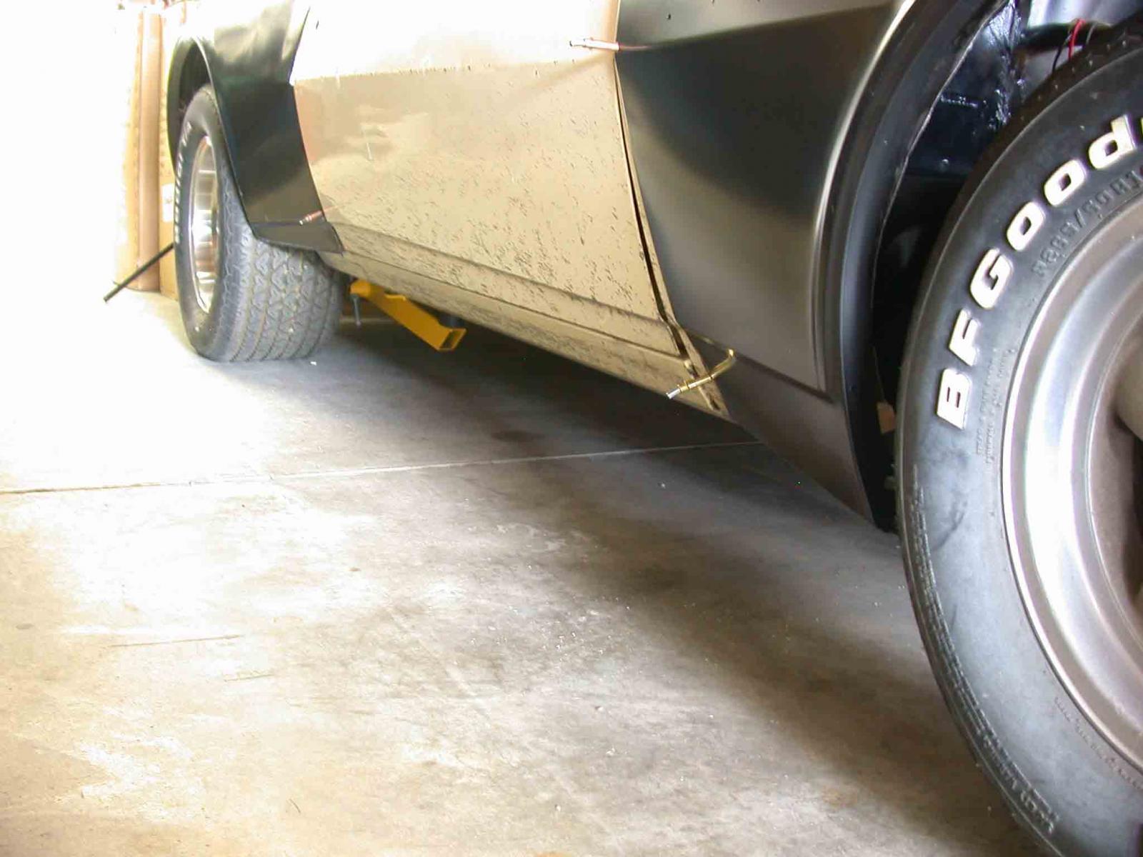

      Widebody = Not as Easy as it looks!
      The Pros on this site make it look effortless. When I pulled the rear fender skin out 2" there was a gap of about 1/2" at the top of the fender to the horizontal portion next to the sail panel. A release cut at the rear helped, but the horizontal bodyline goes up at the wheelwell. I think there is a widebody Mustang on the site that had 3 radial cuts above the wheelwell to allow the top of the rear fender to be pushed down. Will try this.
      My other concern is the Camaro sides wrap way under versus current slab sided cars. When you push the wheels out this exacerbates the potential for massive rock chips down the side of the car. I pulled the bottom of the skins out to get a kind of splash guard both in front and back of the wheelwell. But now it looks fugley (like an 80's Nissan. I think?). It has a conical shape that looks worse in person. Couldn't exactly capture it in the photos. I have since relaxed the amount it is pulled out at the bottom. It looks better and I will probably get it wrapped along the lower body after paint.
      I found some photos of Smokey Yunick's 68. I think my flares will look exactly the same. Also I will be doing a similar paint job. Just replace the gold with bright yellow and the black with dark blue.
