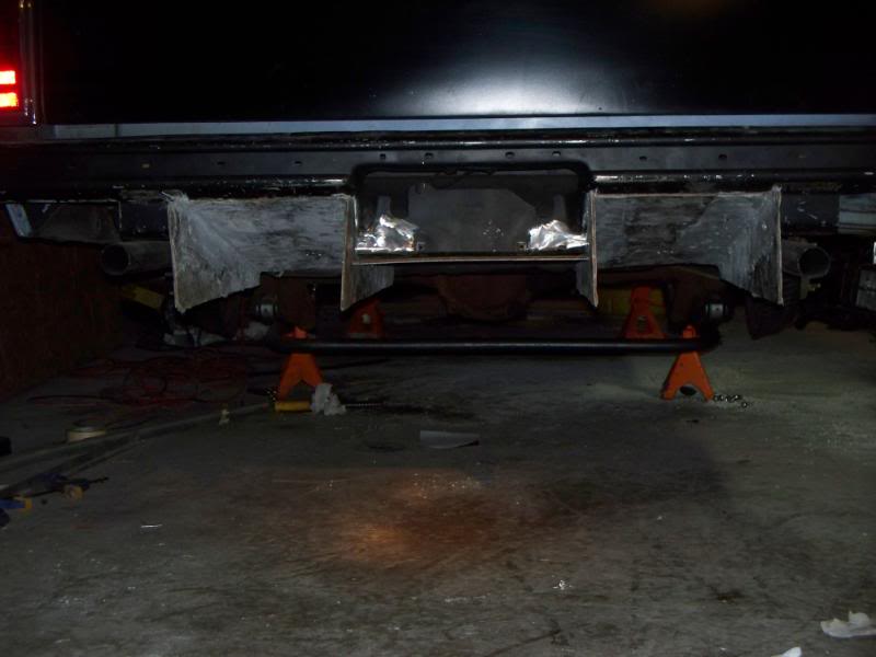

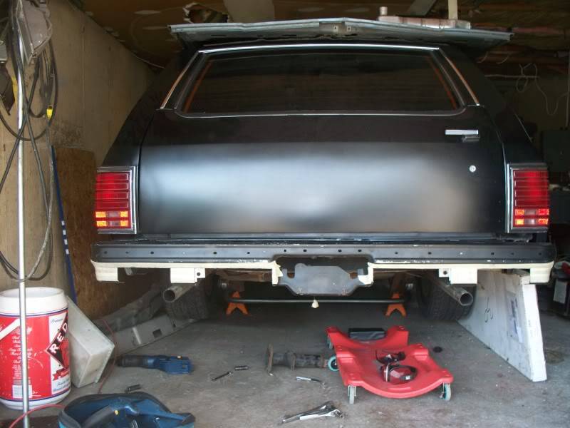

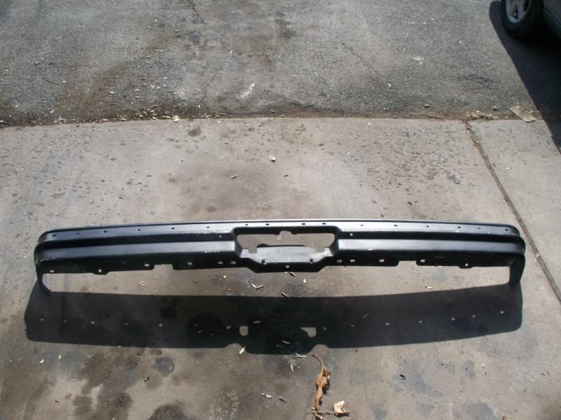

      Ok I am starting on my difffuser and since I have the computer in the garage I thought I would do my best to supply live updates. This is going under my 1984 Oldsmobile Custom Cruiser wagon. So far I have only cut the passenger side outlets out but I think so far it looks mighty good. Here is the bumper I started with

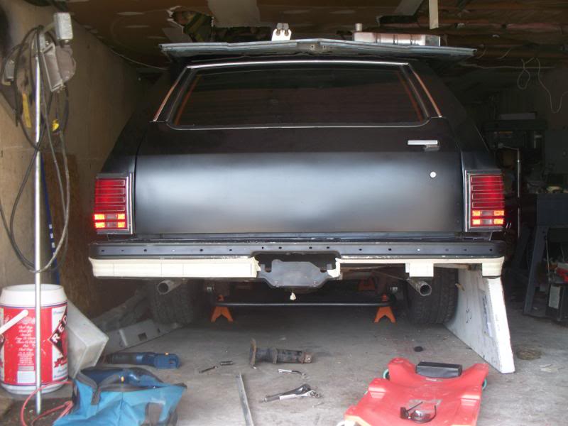

      Here it is after cutting out the outlets.

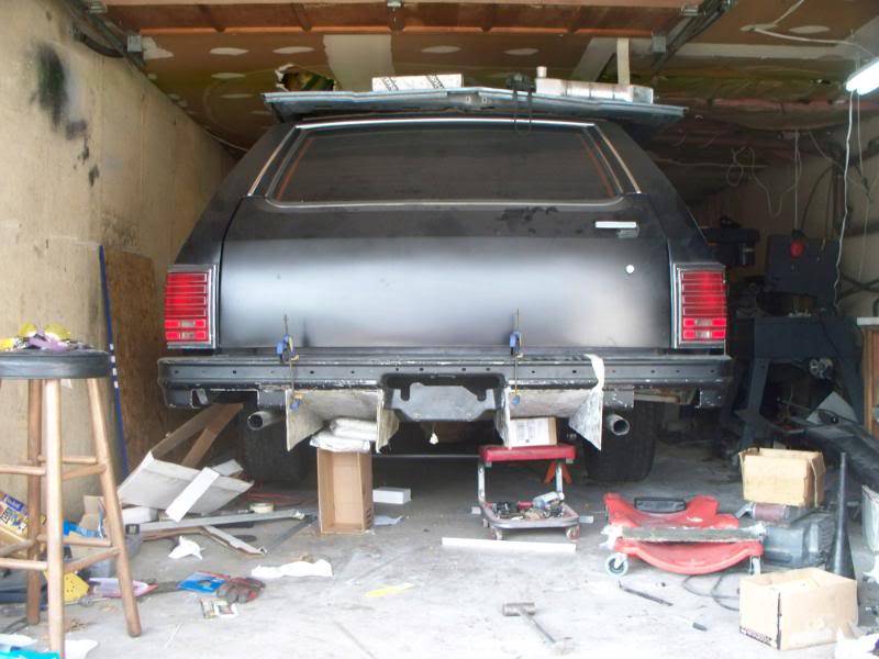

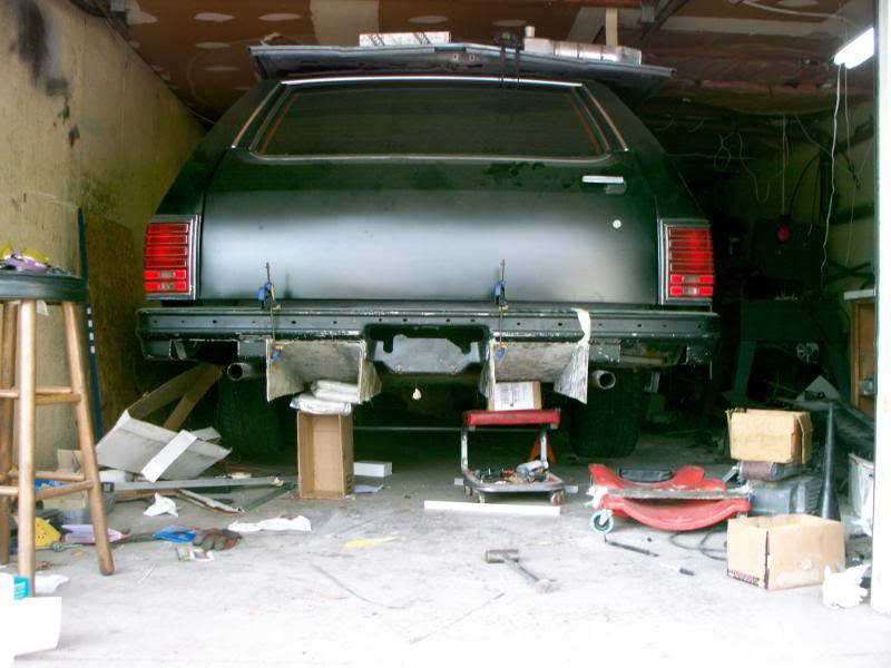

      And now both sides done.
      Now I will move onto the frame. I will be using aluminum angle. I think for the skin I will use sheet aluminum, but have considered fiberglass.

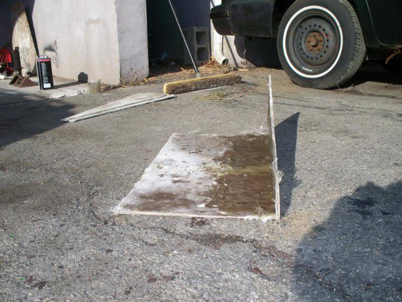

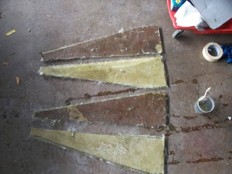

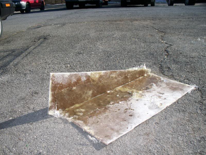

      Ok starting to make some progress. Here are the vertical fences that I have started work on. Going to do another layer of fiberglass and that might be it.

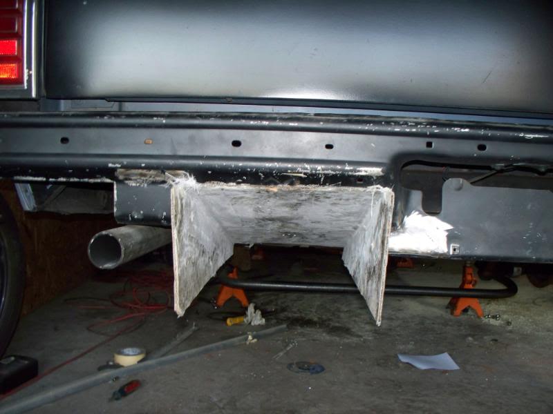

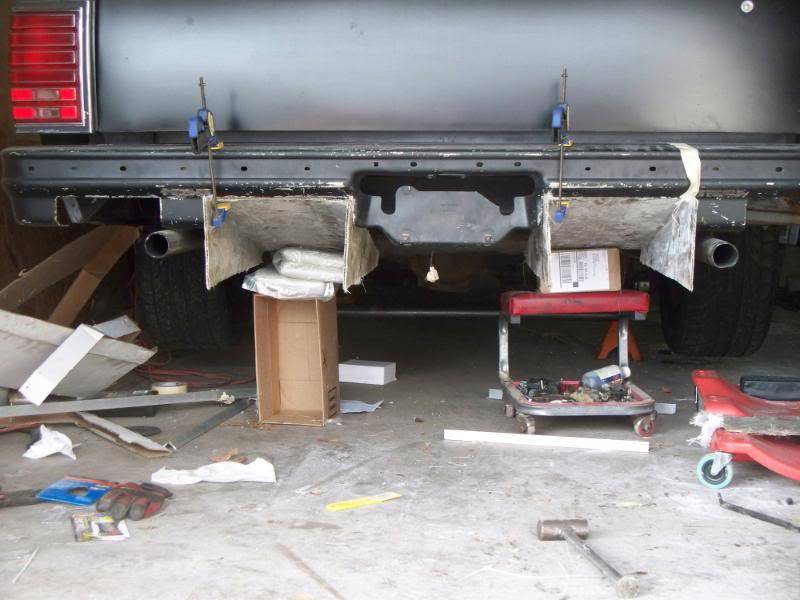

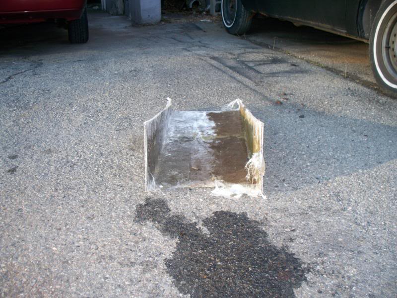

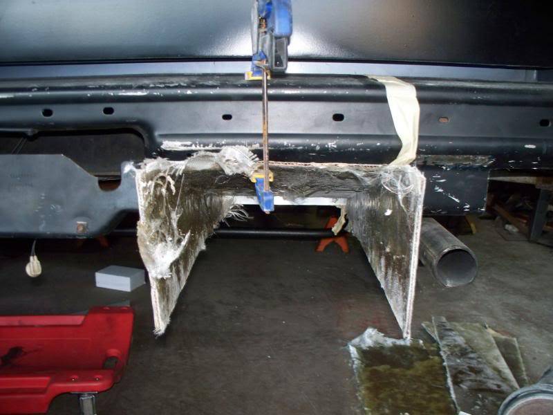

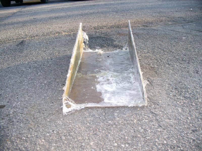

      Ok got a bunch done today on the diffuser. I have one tunnel just about done. Need to add a bit of glass to the tops of the angles for just a tick more strength altough it feels pretty sturdy now. And I need to trim the rear to fit the contours of the rear bumper. I will be using Dzus fasteners to hold it on. This way I can remove it so it will be easier to tie down on the hauler. Anyway here are pics of the latest progress. Let me know what you think.

      Some new pics. Both tunnels are done. They will need some final trimming but for now I need to get them mounted and then I can start on the center section. This is going to look so trick when done.

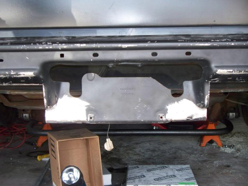

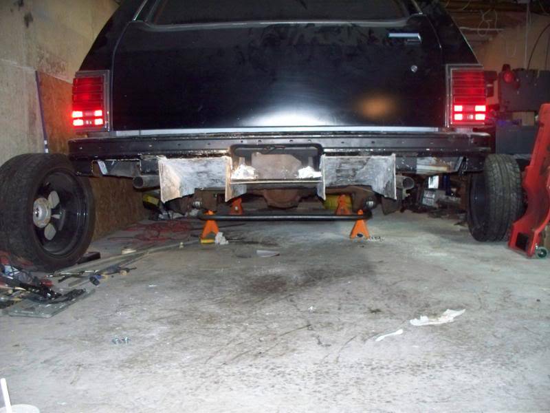

      Ok getting pretty close to completing the main part of the diffuser. I have both tunnels mounted with Dzus fastners and they are very solid. The center section is mounted with Dzus fastners as well. Hopefully tomorrow I can trim them and glass them together as one unit. I amd really liking the way this is coming out. Although I am not sure I can leave them that deep. Also I like hout they stick out past the bumper but that too might get trimmed back. Not sure yet. Ok let's get to the pics. The first if the spot where the license plate mounts. It is curved so that it doesn't match up with the plate. So we squared it off. Here you can see the difference from one side to the other.
      and here are both sides done.
      One tunnel solidly mounted. I had to mount the Dzus fasteners inside of the panel as I made the vertical fence too thick.
      Finally both tunnels, and center panel mounted.

      keep in mind that these if done correctly will produce negative pressure at speed so they will try to pull down off the car. You need to be sure that your fasteners and the surrounding material can handle the load, figure around 100 pounds per each piece would be a high figure.
      I am going to guess that your are building these more for looks rather than function. If you really want downforce at speeds then you need to start at the front and work your way back. All under hood air flow has to be controlled, under the car needs to be flat and smooth, front splitter to divert as much air around the car as possible, side skirts are a must to control air from leaking in or out from under the car and a decent rake helps too. The diffuser will help accelerate the air from under the car and works best with a spoiler mounted just above its opening which is not possible with your car. Another note is to route your exhaust into the very beginning of the diffuser, this speeds up the air which will create more downforce

      Steve, not building them just for looks. More looking to clean up the underside air and get it out cleanly. The way my car is the fuel tank is very forward of the rear bumper. So the air is able to come across the tank then come back up and hit the one crossmember and get caught by the huge rear bumper. I figure this will be much cleaner for the air to exit Kinda hoping it doesn't produce downforce, although it sure looks like it could. Are you thinking it will produce downforce? It would be cool but not until I get the airdam done which might not be in time for RTTS. I do have a great idea for and airdam/splitter. I have been studying the aero articles in he advanced section and think I need test equipment before hacking a hood vent on my car but I bet one would help. All a matter of where.

      If your fuel tank is in front of the diffuser then I would say that is a good thing because the bottom of a tank is usually quite smooth so that will aide in streamlining the underside of your car.
      The entire purpose of a diffuser is to create downforce, its what they are designed to do. Im not sure if yours will produce a measurable amount tho, it will have to be relatively low to the ground to work. Also like I posted, it really helps if you have the other aero stuff in place. A front splitter and flat belly really help. The diffuser is supposed to speed up the air just before it leaves the underside of the car, this creates an area of negative pressure in the diffuser and thus downforce.
