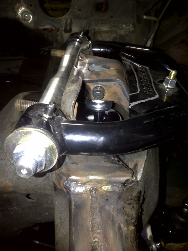

      What made you decide to recess the top and weld it. My buddy talked me out of it.

      Any more pics of your setup? Did you re-drill the upper holes for the control arm yet? The directions are wrong.

      Quote Originally Posted by TBART70 View Post
      Primarily to allow for better access to weld the top. The other reason being that I once I fit the bottom edge of the bracket, there was a little bit of interference with that lip. I could have cut down more off the bottom edge, but just decided against it. Having a solid bead ALL the way across the top just makes me feel better about the install.
      I am not using Speedtech's control arms. I am using Hotchkis pieces. Hotchkis moves the lower ball joint to allow for more caster and that is the route I chose.

      The upper control arm mounting holes are lowered for camber gain, also using the ATS spindles.

      nice welds

      I know why. I am just on the fence as to whether or not I will do that with the Hotchkis arms. So by that logic, you are using the standard height ATS spindles? Or will your camber curve be very aggressive? And what are you doing for the steering arm?

      Quote Originally Posted by dipren443 View Post
      TBART.
      Nick
      I misunderstood what you meant by the lowers, my caster will be 4.5 to 5.5 when done. camber gain I think was 1* per inch of travel if I remember correctly.
      I'm using the tall spindles, speedtech has a whole kit with steering arms and all the linkage, they moved some stuff around and made it better. It is not overly aggressive, I have the numbers written down some where.

      Sounds good. I am running stock spindles. I had a long discussion ages ago with Marcus at SC&C in regards to the ATS spindles. It didn't seem like an advantage at that point. ATS hadn't figured out the 2nd Gen steering arm issue at that time. Since then, I have not looked into the AFX spindles.
