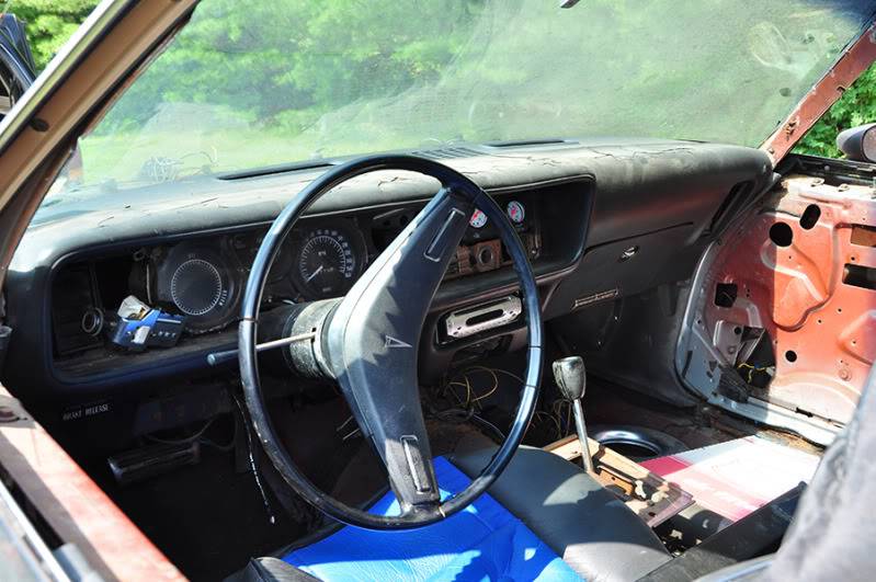

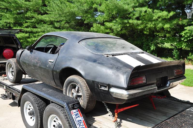

      Thanks guys,
      Here are a couple pics from the first day we got her home.
      I've got her all stripped down other than suspension, doors and deck lid now though.
