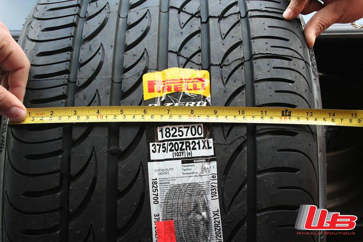

      pirelli 375/20/21
      so whos gonna be rocking it? if i didn't get such a good deal on my wheels i would have gone with a 21" rear to use it. funny thing is, it is cheaper than a good deal of 19" and 20" tires!!

      That's a big one, 15.4" section width. I wonder if the sidewall would look to small

      No manufacturer has those wheels OEM. They don't look a true 375mm by this picture. But they are cheaper than PS2 for some reason. Pirelli USA does not recommend going wider than 13" (12.0-13.0 only). If they were true 375's, you should be able to run a 14.5" wheel. It looks like a 345mm to me
      Kumho makes that size and they would fit a 14.5" wheel - and they're even cheaper than Pirelli's

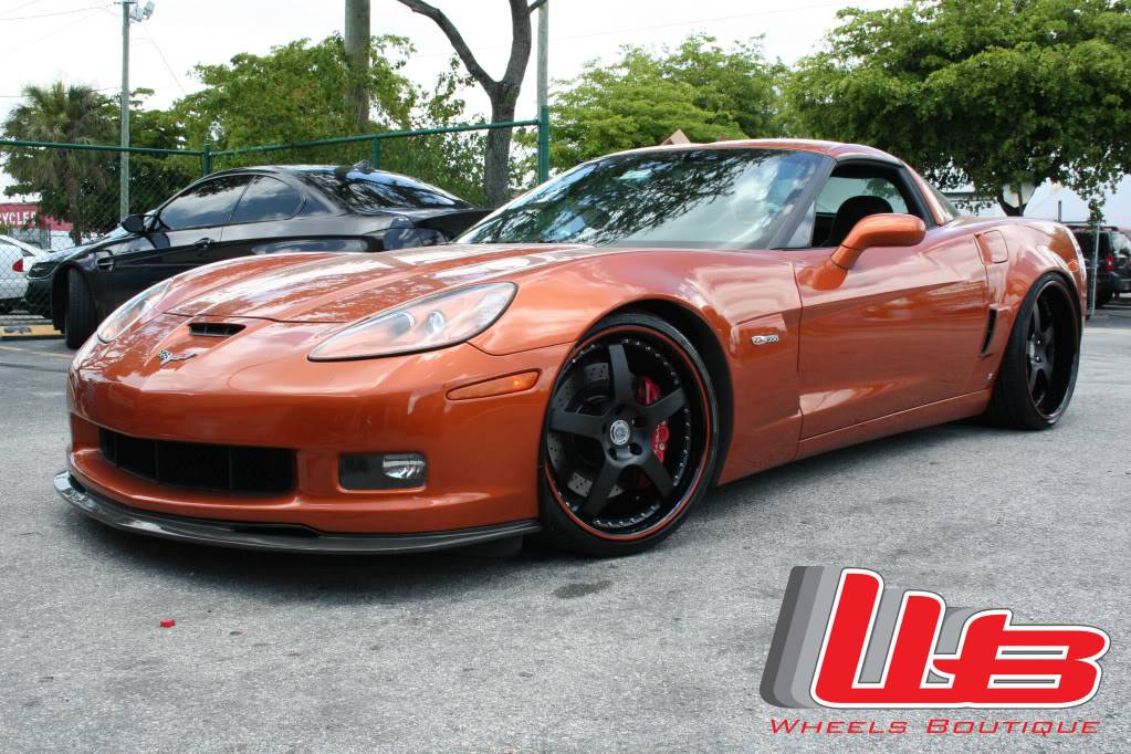

      This car has the 375/20/21

      Lots of vettes run 13" wheels in the rear without a tub, but 14"-14.5" will stick out unless your run an aftermarket widebody kit that some people sell

      sure looks like a 345 tread width to me too.....?

      WAY too big...not the width, but the wheel diameter and tire profile...even for the Z06.

      I agree - still like 19's out back on a C6
