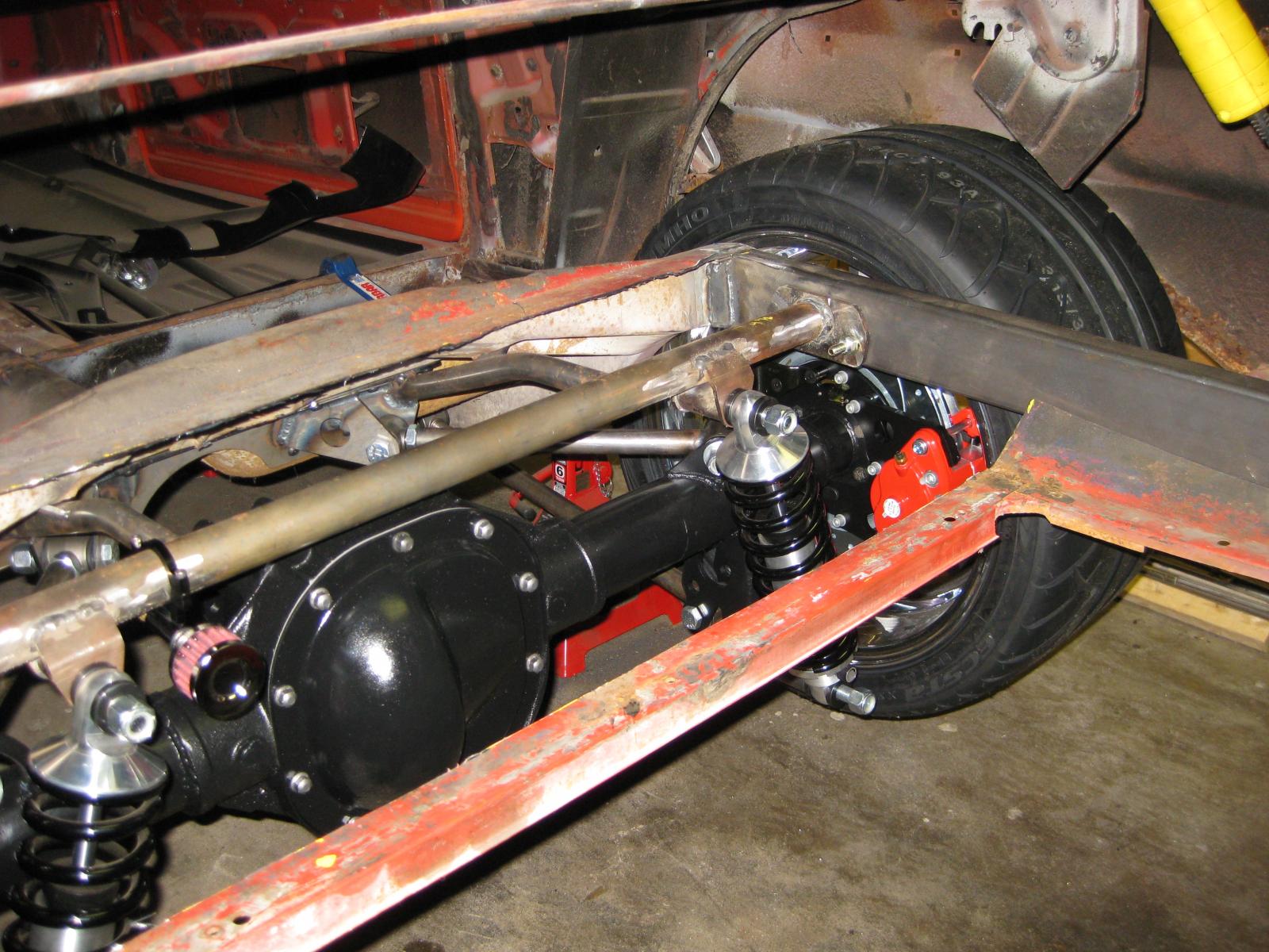

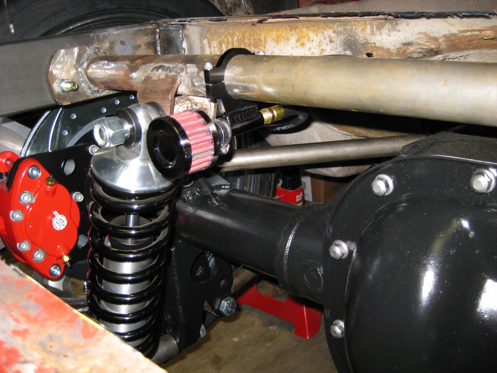

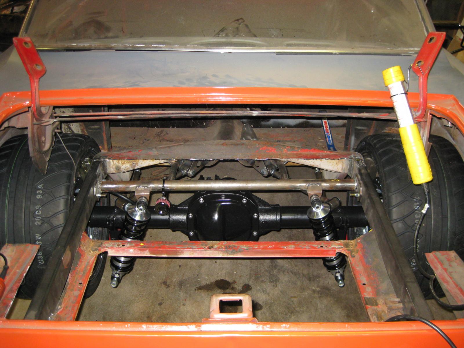

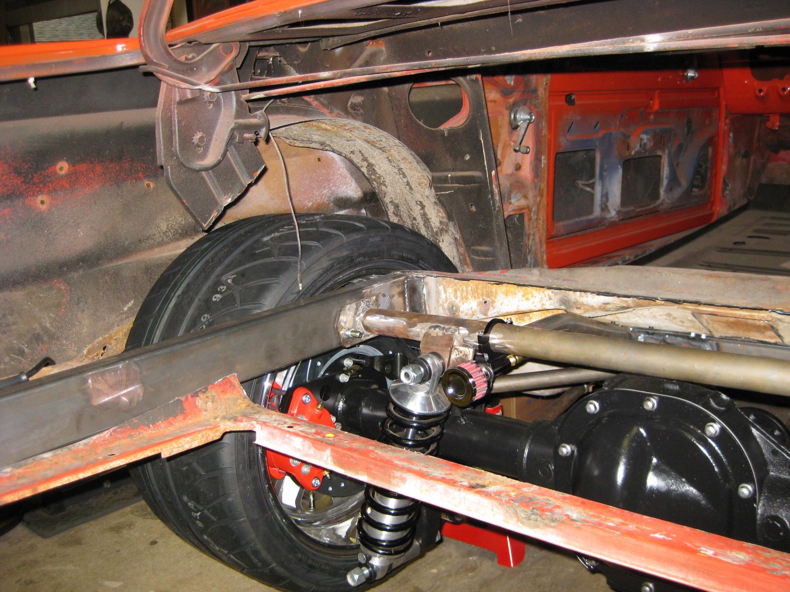

      Here ya go, hope these help. I think I has some other pictures somewhere as well, still looking.Name:  March 10 2012 017.jpg

      Thanks for the pics LowFast.that's really gonna help me out when I get to that point.about how many hrs do you think you have in just that back area?
    11. #271
      Texan Back in Texas!
      675
      Its hard for me to estimate the hours in this as I am just a hobbyist and worked on it when I have time. For strictly the frame rail relocation, modifying the TCI rear 4-link and then installing it all i would say probably around 20 hours, a large portion of which was cutting out the rotted inner fender wells and the "design on the fly" work of figuring out how to get everything properly adjusted to not only fit but also function.

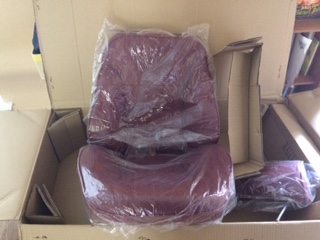

      I did get my new rear buckets not that long ago. I have not set them in the car but should do that this weekend. I will have to build custom mounts to keep them low to the floor but they should fit nicely in the space with the custom built flow through console/trans tunnel.

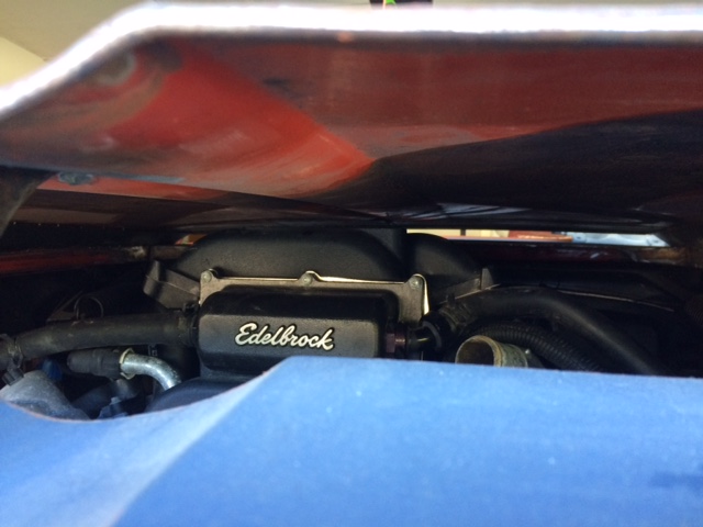

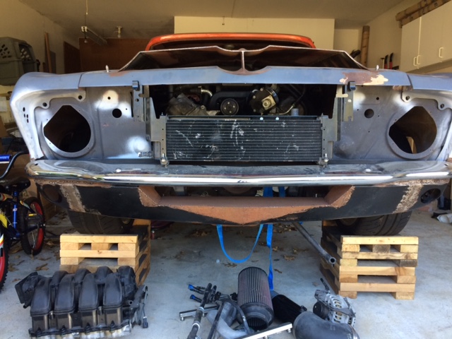

      I picked up a used Edelbrock E-Force supercharger for a steal. Luckily the hood scoop I built clears it with an inch or so to spare. It is not the prettiest blower but with some paint and clean-up it should look good. I can safely get around 500chp/500ctq safely out of the stock 4.6. The blower came off a wrecked Saleen Extreme with a built engine putting down over 650hp to the wheels, so it has the potential should I ever decide to fortify the engine and dial it up. The heat exchanger/intercooler will fit nicely into the front valance cutout, it is a Shelby GT500 unit (just set it on top to show relative size).

      All four of the Procar buckets are set in to see how it all fits. ended up with more rear legroom than anticipated. I plan to "sink" the rear buckets into the rear deck/firewall alittle for more room and for a cleaner look. I am really happy with the quality of the procar vinyl and stitching. A good product for the money. Sorry about the plastic, but gotta keep'em clean until the glass goes in which is many moons away.
