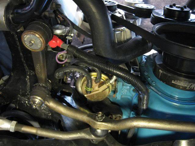

      I don't remember seeing an idler arm with grease fittings as you described, if I'm reading it right. Always down like this.
      Moog replacement arm, hotchkiss sway bar. Dave is right, some (most) replacement arms are larger at that pivot point. Mine hit the big Hotchkis sway bar. Hotchkis told me to try another brand. Delco and the Spicer brands may have a smaller body, maybe try those. I ended up loosly installing the idler & sway, prying them apart and tightening them down. The bar just touches the grease boot.

      The Replacement I received looked just like the one you have pictured. Does not fit, not even close. I will look into the other brands with possible smaller Pivot area. Thanks. Maybe one of them will fit, spicer or delco. I also have a front frame brace under the sway bar bushings, so hopefully something clears. If the factory one does, something should.
