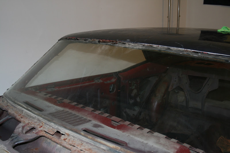

      For my 30th b-day I picked up a project car. A 1968 Pontiac Firebird that turned out to be a real basket case. I picked it up locally, knowing it needed a floorpan and at least one quarter.
      Unfortunately, I didn't inspect the car as well as I should have before purchasing. Although I still think I got an OK deal, I could have saved myself some time. After disassembling, the list of parts to be replaced grew to just about everything.

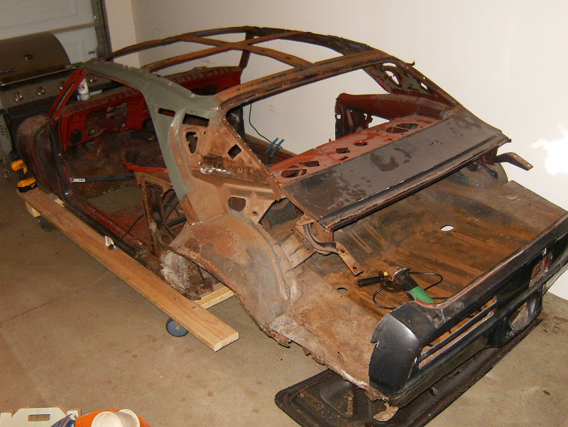

      So disassembly continued probably further than it should have...

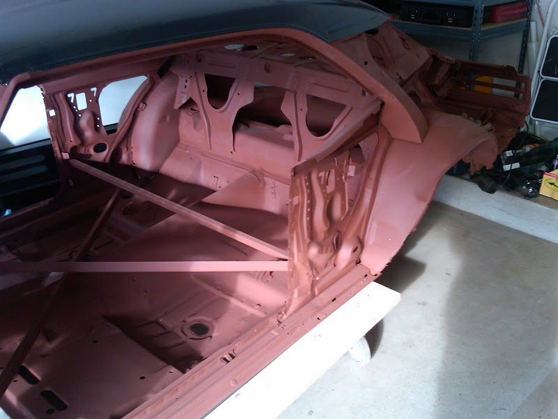

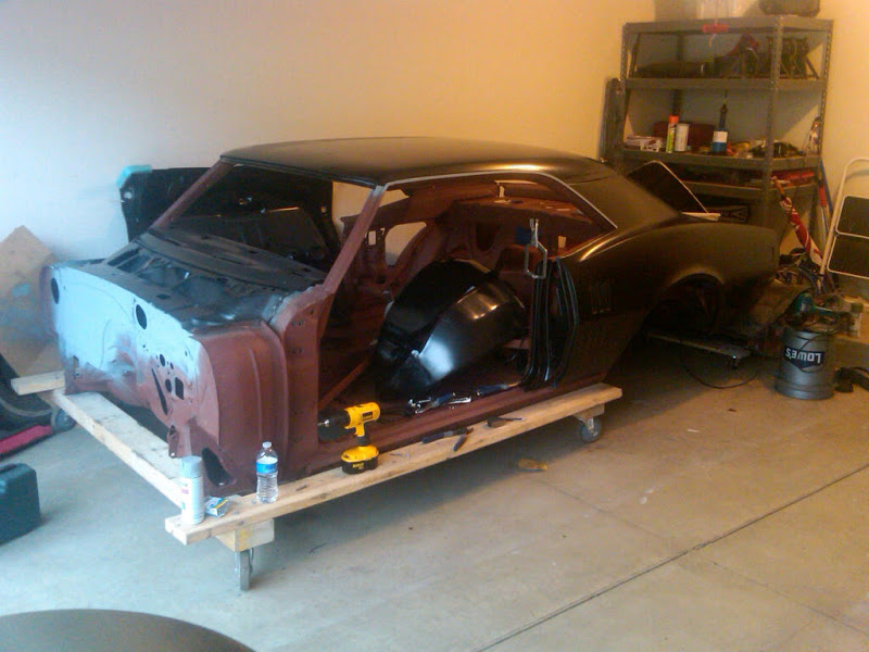

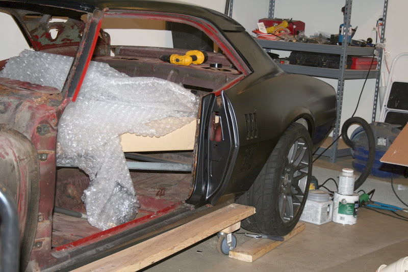

      At that point, I started accumulating new metal. Fitted the new roof a bit (inner structure still needs a bit of repair). And just roughed in a quarter as motivation. Wheels belong to my G8.
      That's where it sits for now. Garage is cleaned up and car is cleaned out a bit. I need to get a replacement for the door pillar reinforcement on the driver side (first ever quarter replacement, and I destroyed it). Lots of fitting, trimming, and repairing in the future. Hoping to get the metal work done by end of summer (a bit later than I originally wanted, but such is life). At least the parts are waiting on me and not the other way around!

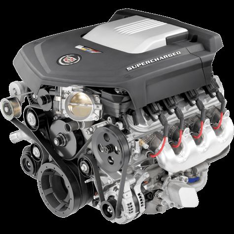

      Really wanting to put an LSA into my Bird. We'll see, I'm years away from an engine. But, I have a question. Will the alternator need to move? I'm guessing so. Just run a Vintage Air Front Runner?

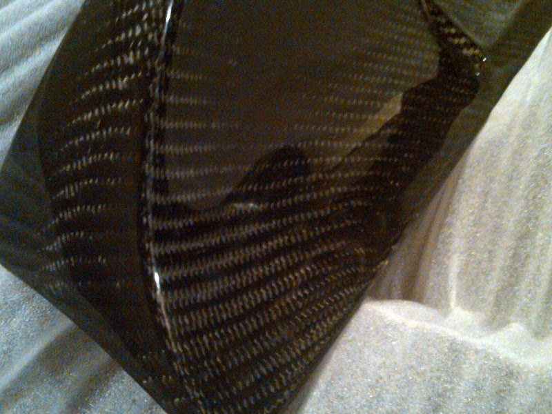

      Diet Spoiler. Thanks to the guys at Anvil and to whoever returned this spoiler for no reason!

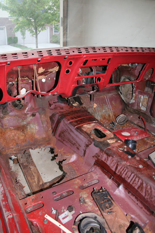

      Car was blasted and primed at Michigan Sand Blasting. They came and picked up the car last Monday, blasted, primed, and returned the car today. It was blasted with Starlite and primed with Kem Kromik primer. Didn't go with epoxy simply because there is still a lot of metal to remove and the extra cost just didn't make sense. Very happy with the blast and prime - perfect for what I needed. Overall no real surprises except that the rockers are also swiss cheese.

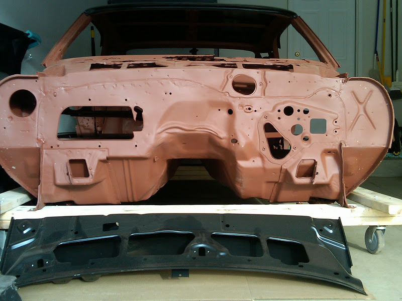

      Been awhile since I updated on here.
      Final rendering is done...
      Cowl and fill plate are in...
      Question on fill plate... Should I weld every single spot or is every half inch ok???

      I asked some firewall smoothing questions in a thread I started here: https://www.pro-touring.com/showthre...thing-firewall
      Maybe some of the folks that responded can give you some advice. Looks like some of them really did a good job. Hope this helps. Love where you're going with your 'Bird.
      I'm going to weld it up solid but I have read that thread. Thanks!

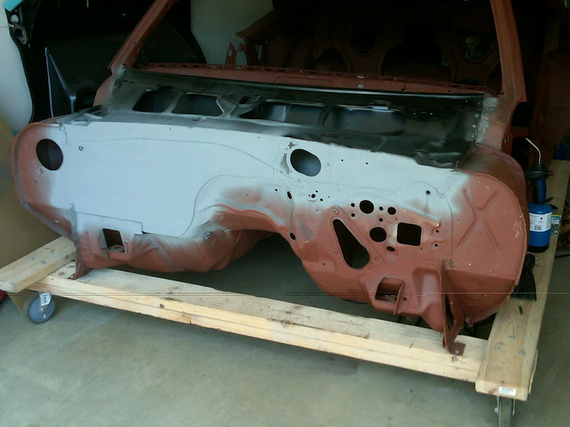

      Drip rails are welded in. Panels were test fitted and I'm happy so far. About six weeks ago, I was working on trunk pan remove and replace. DSE mini tubs are waiting to be installed after that is finished. This is more or less where it stopped.

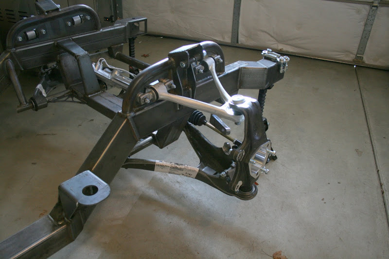

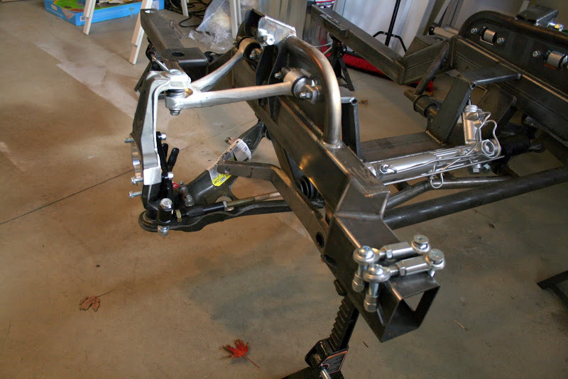

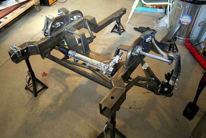

      JRS Apex C6 Front Suspension is in... took a bit longer than planned to get it here, but it's here. Still missing a few bits and pieces, but I test assembled most of it this weekend. Once I get the missing pieces, the frame will go for e-coat and final assembly will be done. Overall the quality seems pretty damn good, especially on the frame. Some long and impressive welds.
