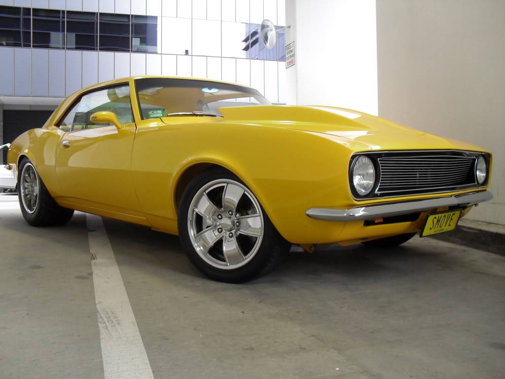

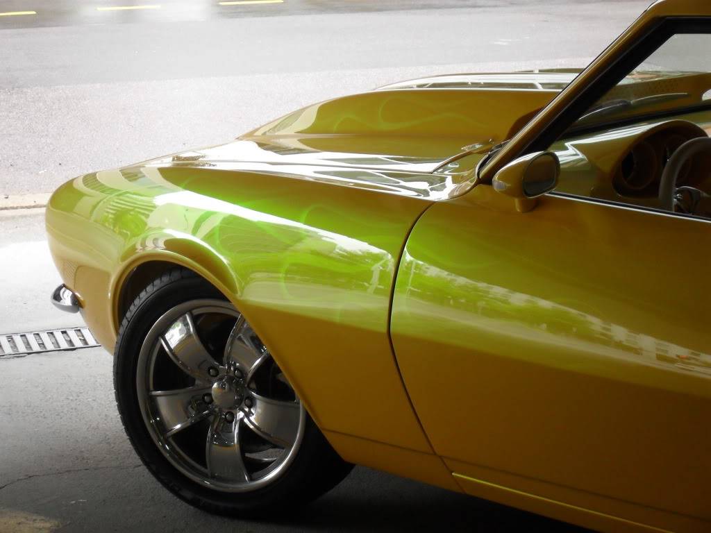

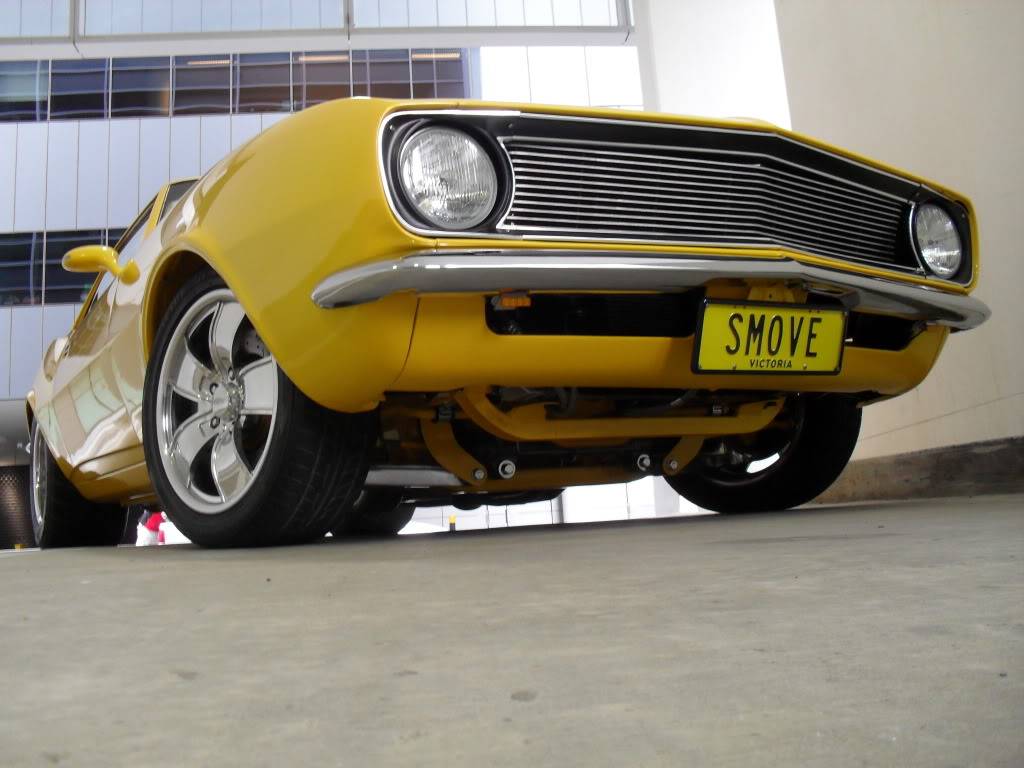

      Some completed pics
      On Sun 9th Jan Street Machine had the car for a photo shoot. We got all set up and it rained, so under cover we went. While waiting for a new location, I took with my cheapo 8MP camera these shots....not as good as the professionals but hey...

      Sweet ghost flames.

      she is pretty SMOVE

      Paint colour is intriguing Chris!
      285
      Quote Originally Posted by MrBlonde View Post
      Yellow base, PPG Vibrance Sunshine Pearl (5 coats) then another 5 coats of the same pearl for the flames

      Quote Originally Posted by 2blownstangs View Post
      she is pretty SMOVE
      luLz I am sitting here saying S-Move tying to figure it out. I'm pretty good at mad gab though.

      Excellent paint execution my friend. Love the flames.

      I love the yellow underneath!!!!!!!

      great looking Camaro, color looks awesome with the sun hitting it. Hard to tell for sure from the pic but is the windsheild flush mounted, if so do you have any of the fab work documented. I like your rear tires, are they 335's? i have 335/30 18 and was looking for somthing with more sidewall hight on them maybe 45 i havent seen to many options for 335's or 345's.

      Thanks Chris. The car came out great and that yellow with the flames is fantastic. Nice license plate too. Enjoy driving her.

      Quote Originally Posted by jnd View Post
      Yep flush mounted. I have a number of build threads on a few forums inc here, but the most detailed and comprehensive build thread is here http://www.USMuscle.com.au/Forum/showthread.php?t=115
      But in summary, we welded a small piece of metal inside the frame to fill up the "gap" that would be normally filled by the chrome mould. Then just used standard rubber off a newish car, and had my screen guy just install as per a new car, took him under an hour each window
      Tyres are a tad bigger than 335.
      They are 390 x 40 M&H Drag radials. I wanted bling + sidewall. So 17 inch rims, 330mm discs, but huge 15.3" width rubber with nice sidewall tucked way up under the guards
