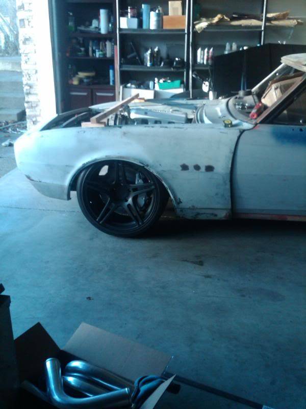

      did a search and to my enjoyment, i will be the first with this set up.
      adv05.1 forged monoblock in 19x10 and 20x13
      just a teaser pic as lots of body mods are happening. think of an 80's street fighter, build in 2011 mixed with a gt-1 race car. will look bitching, or, it will look like crap and the whole thing hits the smelter! haha

      Very nice looking hoops in satin black. Can't wait to see both them with tires mocked up under the flaired fenders you are talking about.

      i got them from jordan at adv. the blue Z06 on their site was his car and these are actually the wheels off of that car. got them for a great price. normally these would be $6000+ for just wheels.
      being a single forged billet, they are about the lightest wheel you can get. i am toying with the idea of removing all the black pc and just running them raw. they look sick in raw and seeing all the tooling marks so people not in the know will figure out these ain't just run of the mill cast wheels.
      what set were you looking at? check with a place called wheel addicts. got a quote from him on a new set and he will blow anyone away on price on the adv's.

      bro, I thought you were going with the poked wheel look??? What happened?
      low is all I know..

      i still am. the pic of the front is just bolted on. no way i could turn the wheels like that. got my spacers now and flares coming tomorrow.

      the backspacing on the front is 7". rear is 8". using a 1.5" spacer on the front then flaring. that will give me full turning radius. the good part about the rear is now i can just get a truck 9" rear (65.25" wide) for a dime a dozen and use the same 1.5" spacer on the rear. that will have them sitting how i want on the car.

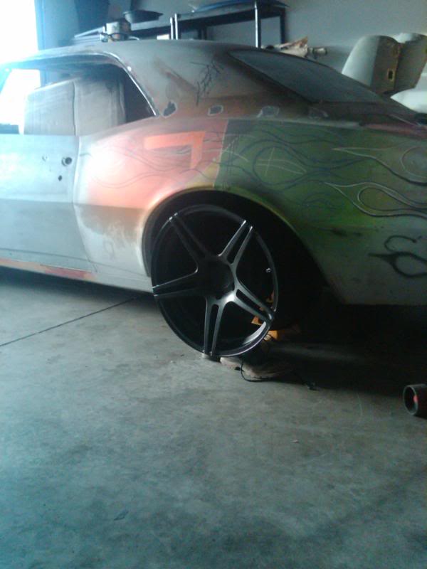

      the wheels are really more a flat black. too flat for me and appears to allow it to stain them too due to the pourous nature of non-glossy paints. so i need to strip them anyways. will be going a 70-80% gloss (easiest to maintain) on the wheels. i have an idea for the paint job, abit off the wall, lol. satin black starting at the front spoiler, then traveling all the way over the top of the car and down the back. windows will be tinted, and all window trim will be satin black and glass flushed out.tailights and rear bumper satin also. sides to be either candy green or the new camaro green. then a satin black and silver graphic down the sides about 2-3" thick. only chrome on the outside will be just a camaro emblem on each front fender.
      one thing i can't stand though is the transition from gloss to satin and having the paint edge. i am toying with the idea of doing the candy green and seeing what a satin clear over it would look like. then the whole car would be satin. cool idea, but i just don't want to do it and then the car appearing unfinished. all engine bay and underneath will be satin either way. so if i didn't like it, it would just take hitting the car with a few coats of gloss clear and problem solved.
      it is only whats in my head right now. gonna wait till exterior is finished and just see the attitude of the car and the direction it is trying to go then make the final descision.

      well to say they are just temporarily positioned is an understatement! if you squint your eyes you can kind of get an idea on the direction. should look abit wicked. with some shortening here and there and lots of fill in, it will be one of a kind!!
