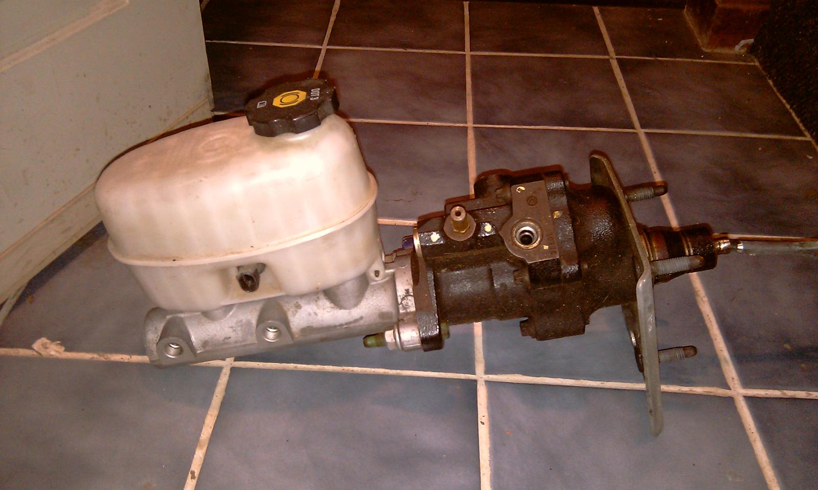

      I will have all of your answers for you this weekend. I am swamped at my day job and need to fine tune those detailed instructions for you. I will be doing that Saturday morning. Please post pics of the HB unit you have Humbler. There are super industrial sized units that are far too big for our cars and I just want to make sure you do not have one of those.

      Will do tonight.
Size:  171.3 KBHere it is..
