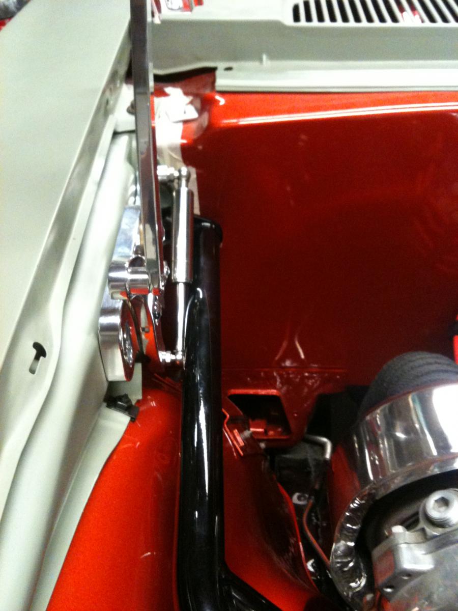

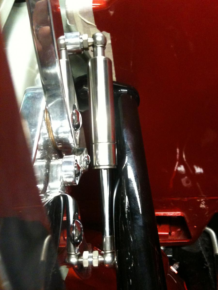

      Fesler hood hinges wont clear the handle bar the strut is hitting the bar , going to try to get the strut closer to the hinges.

      Thanks for the pic.......Super interested if there is a way to have both products on the car...without hacking either of them up too bad...

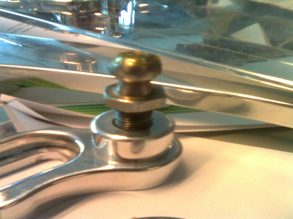

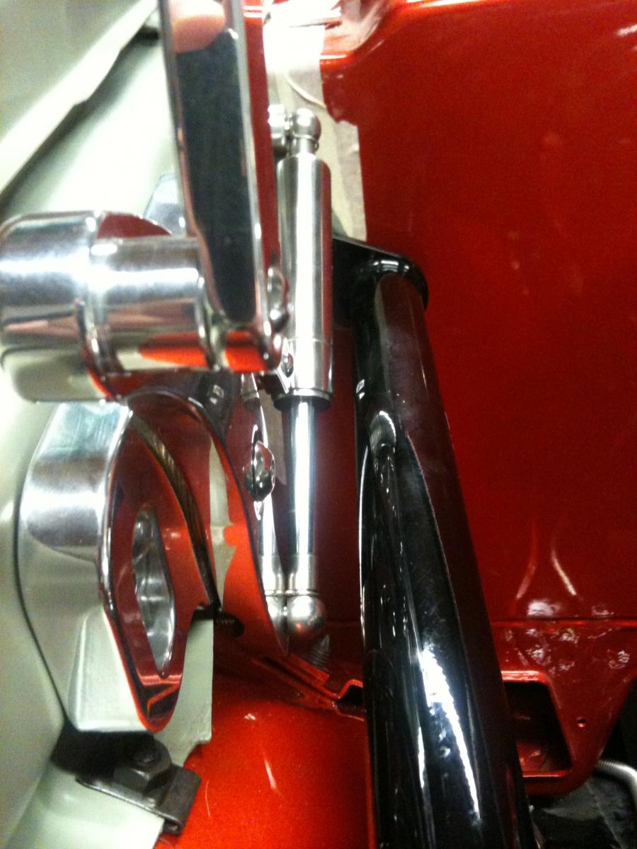

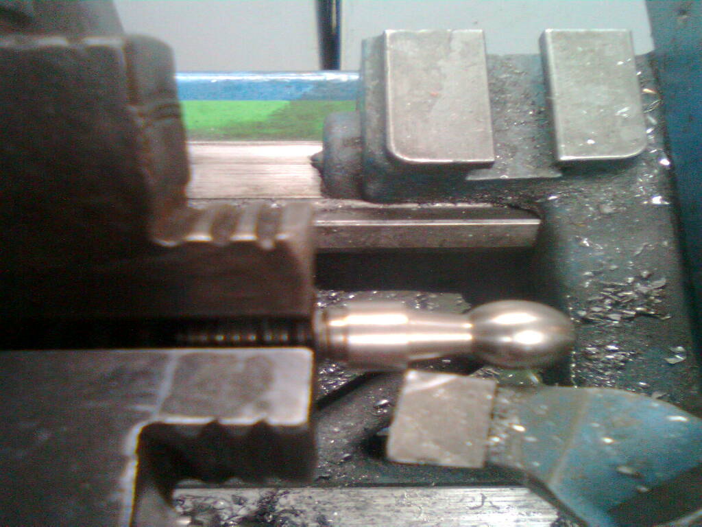

      Did some machining on the mounting for the strut.
      And now it fits nice.

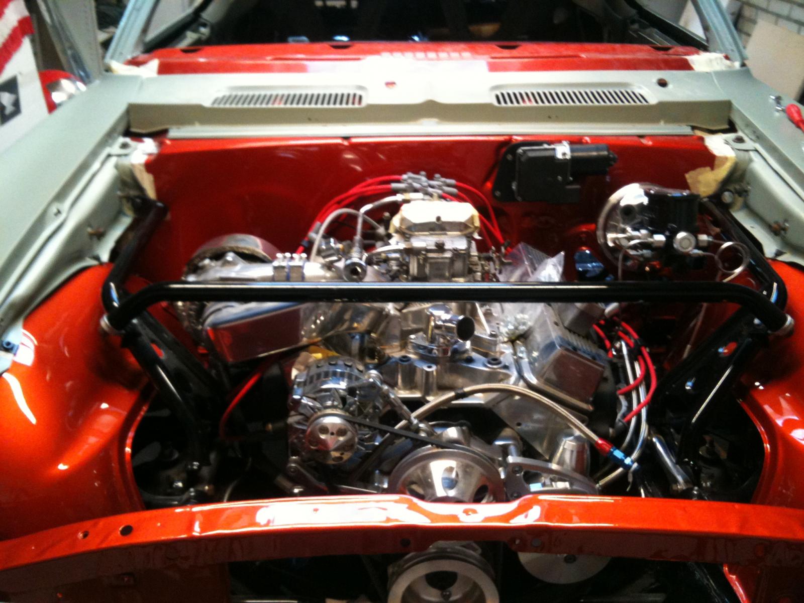

      Nice fix. Got any overall photos?
      Clint - '70 Nova "restomod" cruiser & autocross family car
      Jan 2007
      Netherlands
      72
      Quote Originally Posted by TheBandit View Post
      Here is the Bar installed.
      Erik

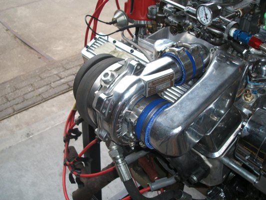

      what is that on the pass. side of the engine?? Turbo?

      Yes that is a turbo. This system is from martin industries and has a Rajay 300EE flow turbo with a carbon seal ( it’s a draw trough system).
