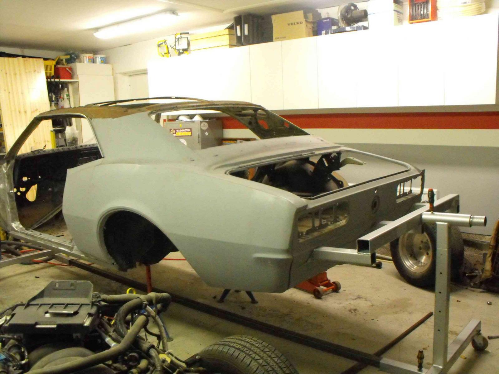

      Hello my name is Daniel and live in Sweden and this is my car
      Bought a Camaro 68 and LS1 & T56 from NM and the car suposed to be rocksolid
      I'm going to do almost all the work by my self. Body work, motor and wiring (never done but i have to learn now) a whole lot of forum reading and i'm not king in english.
      My setup so far. I'm buying the parts from USA through friends in USA so feel free too make offers..
      Parts with stars * I have
      DSE Subframe connectors *
      BRP motor and trans mounts *
      Mini Tubs by modify new stock inner wheel housings *
      Porsche 996 front seats * and non stock interior. I like the festler door panels
      Home made Firewall Fillplate *
      DSE Body Mounts & Bolt Kit *
      Almost all outer sheetmetal *

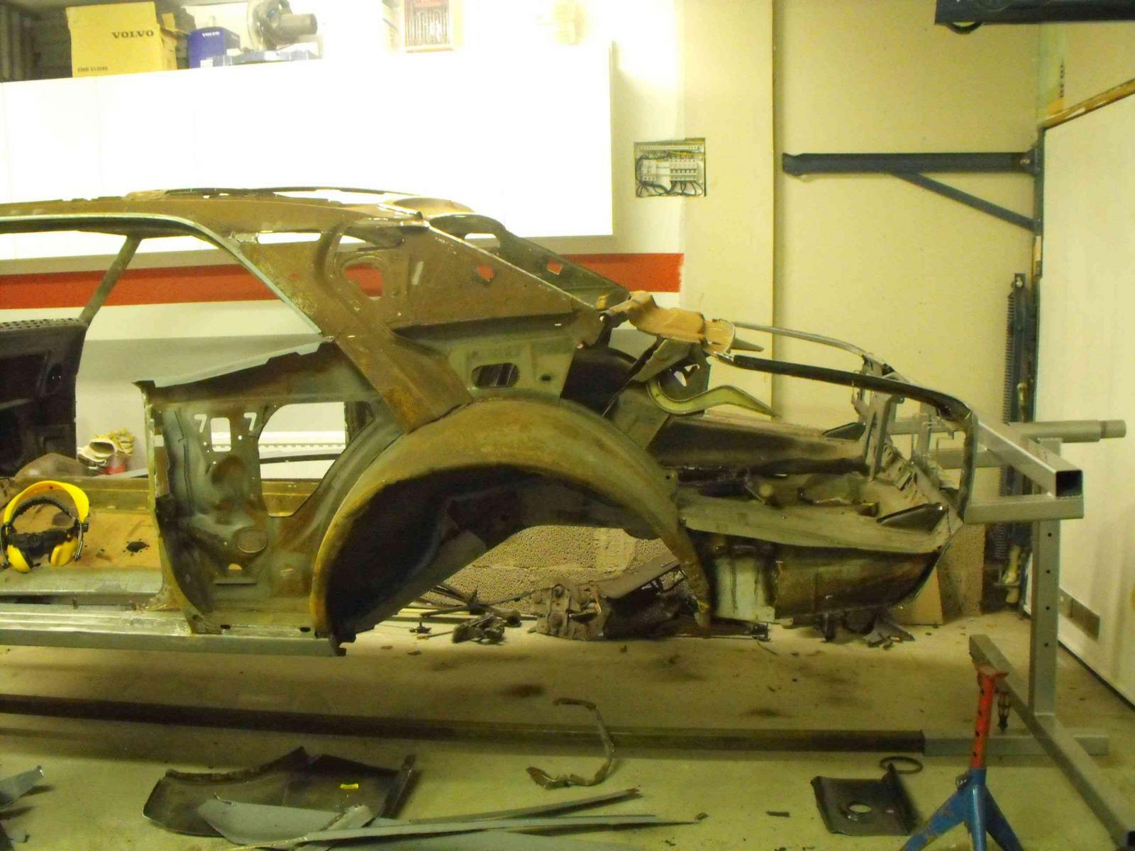

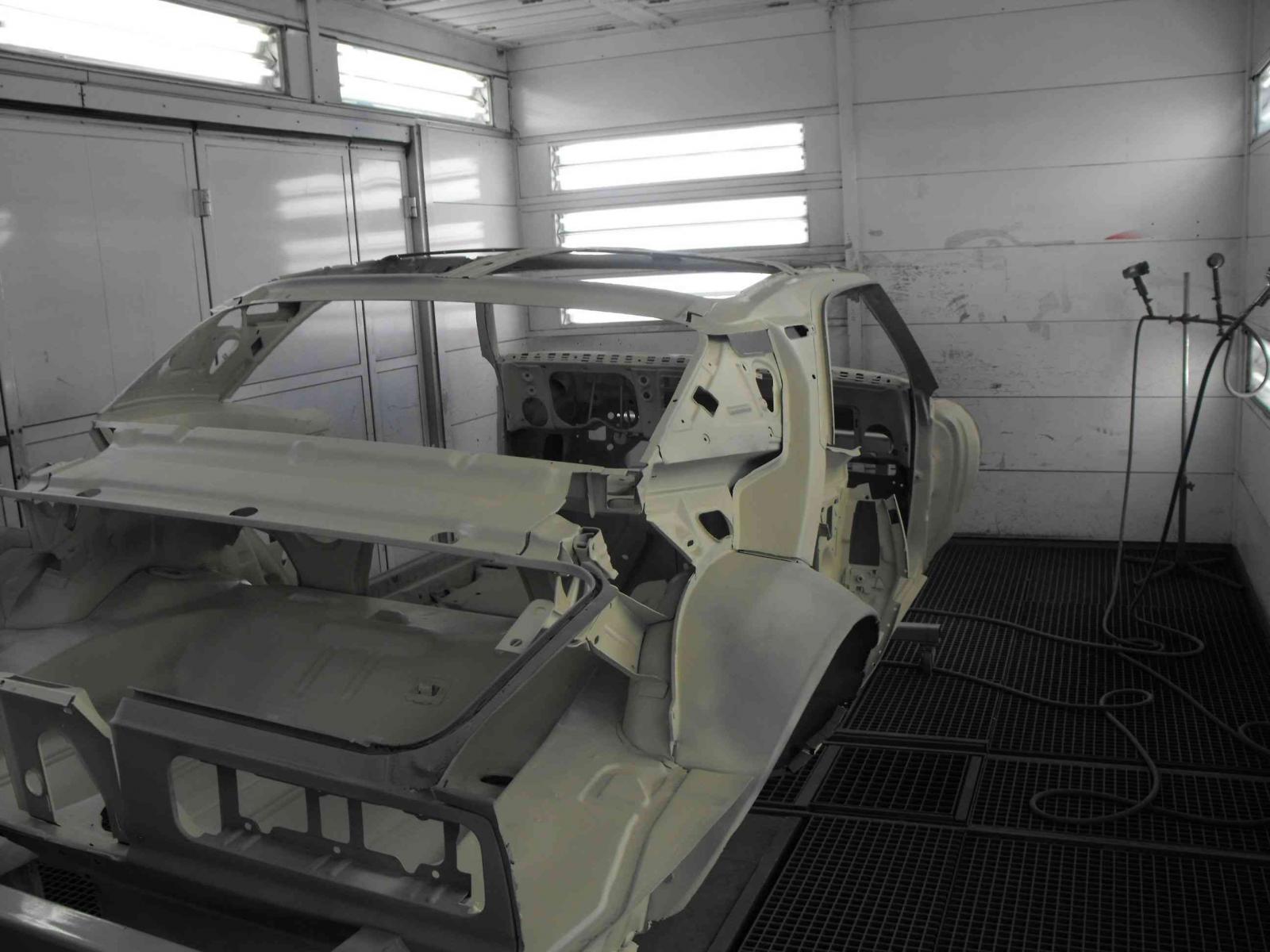

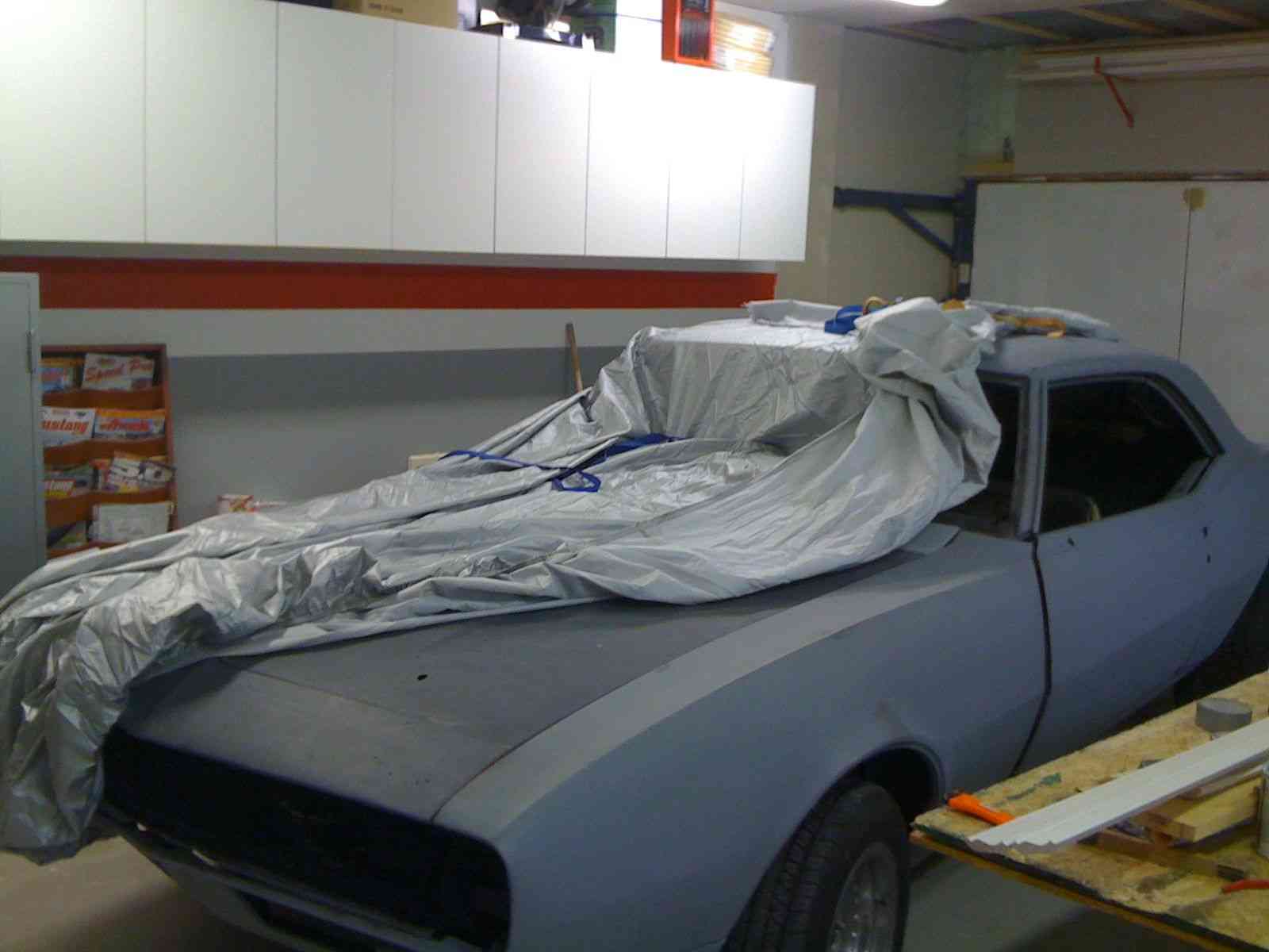

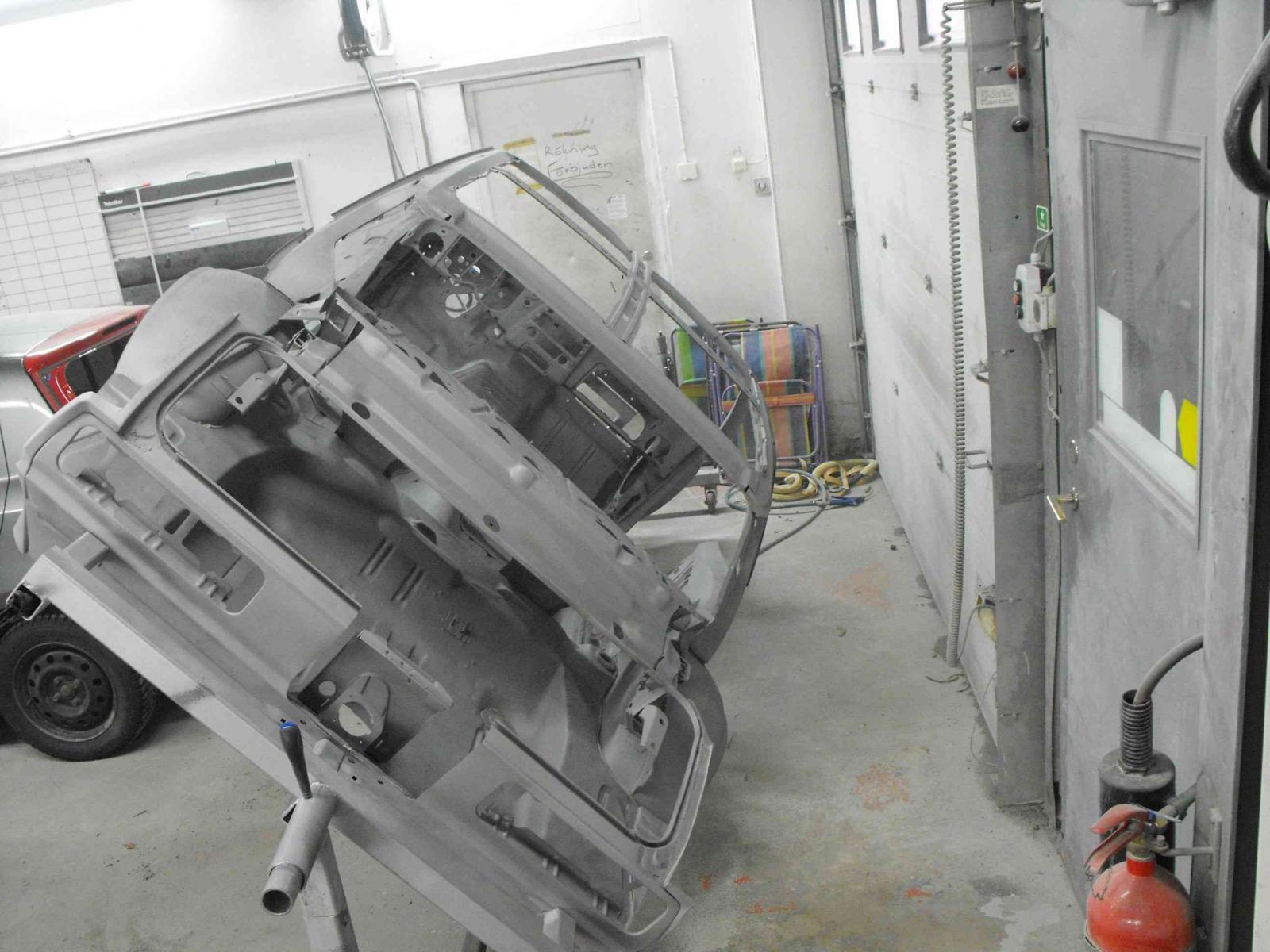

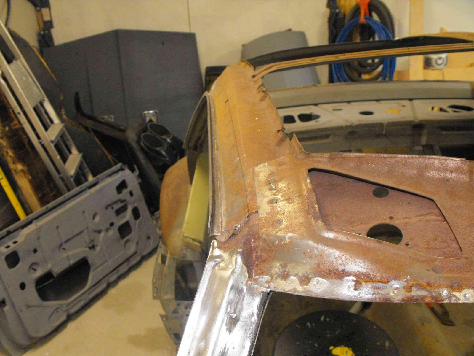

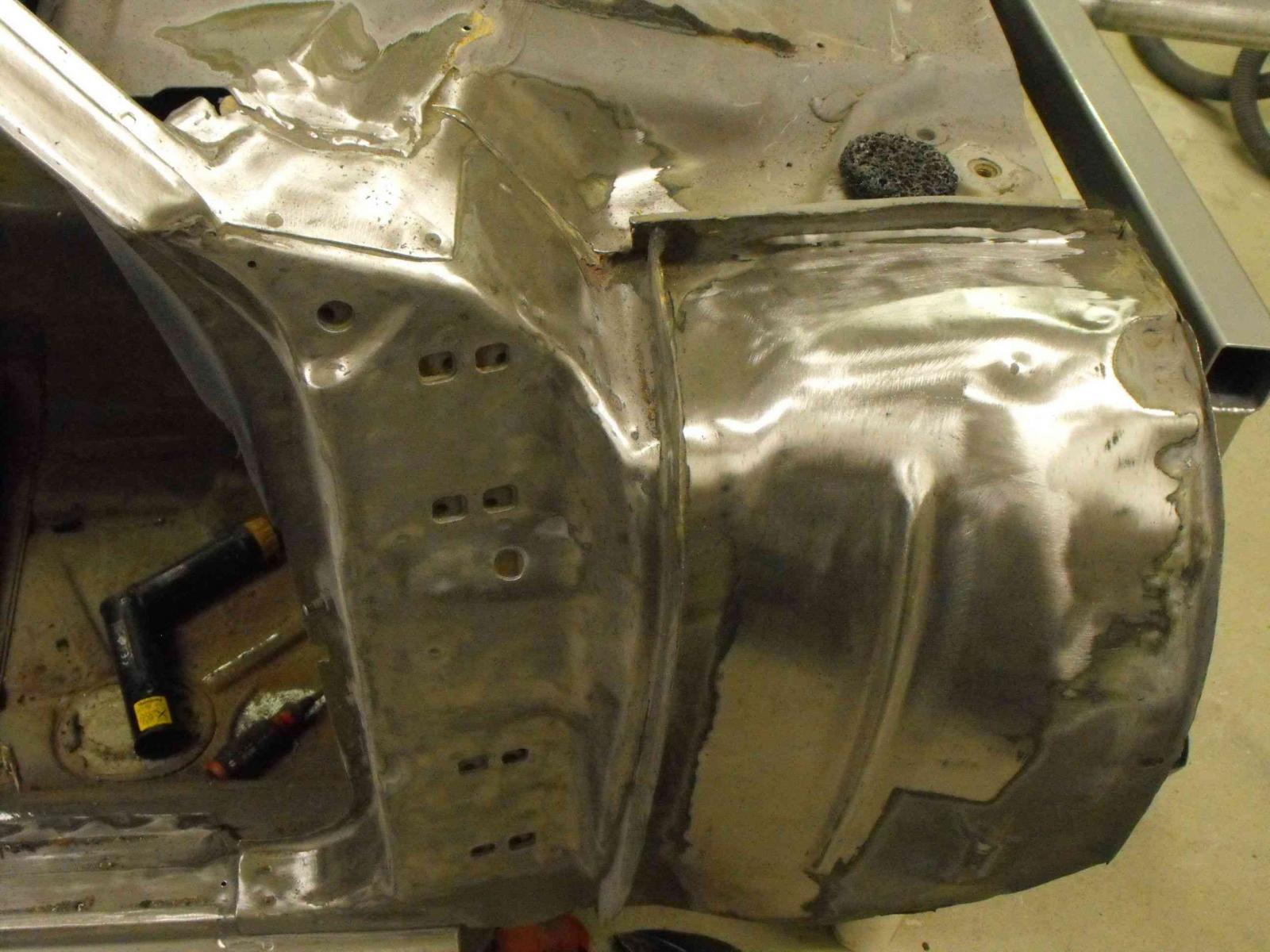

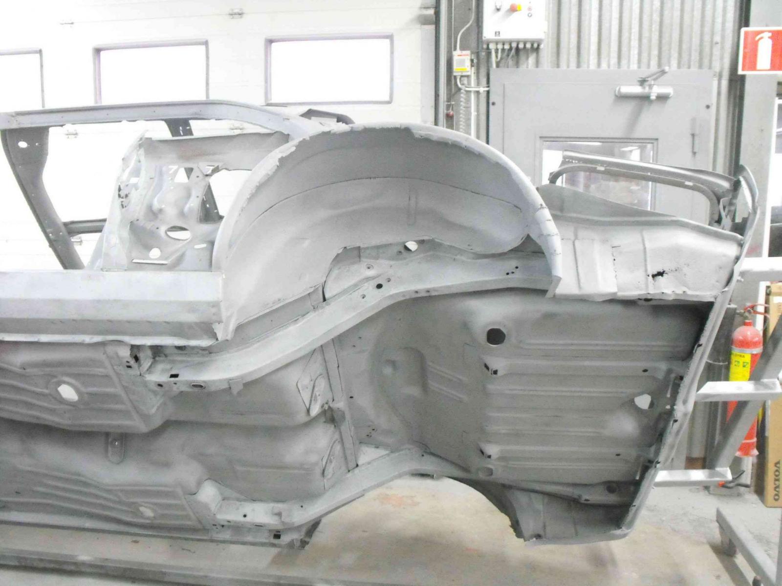

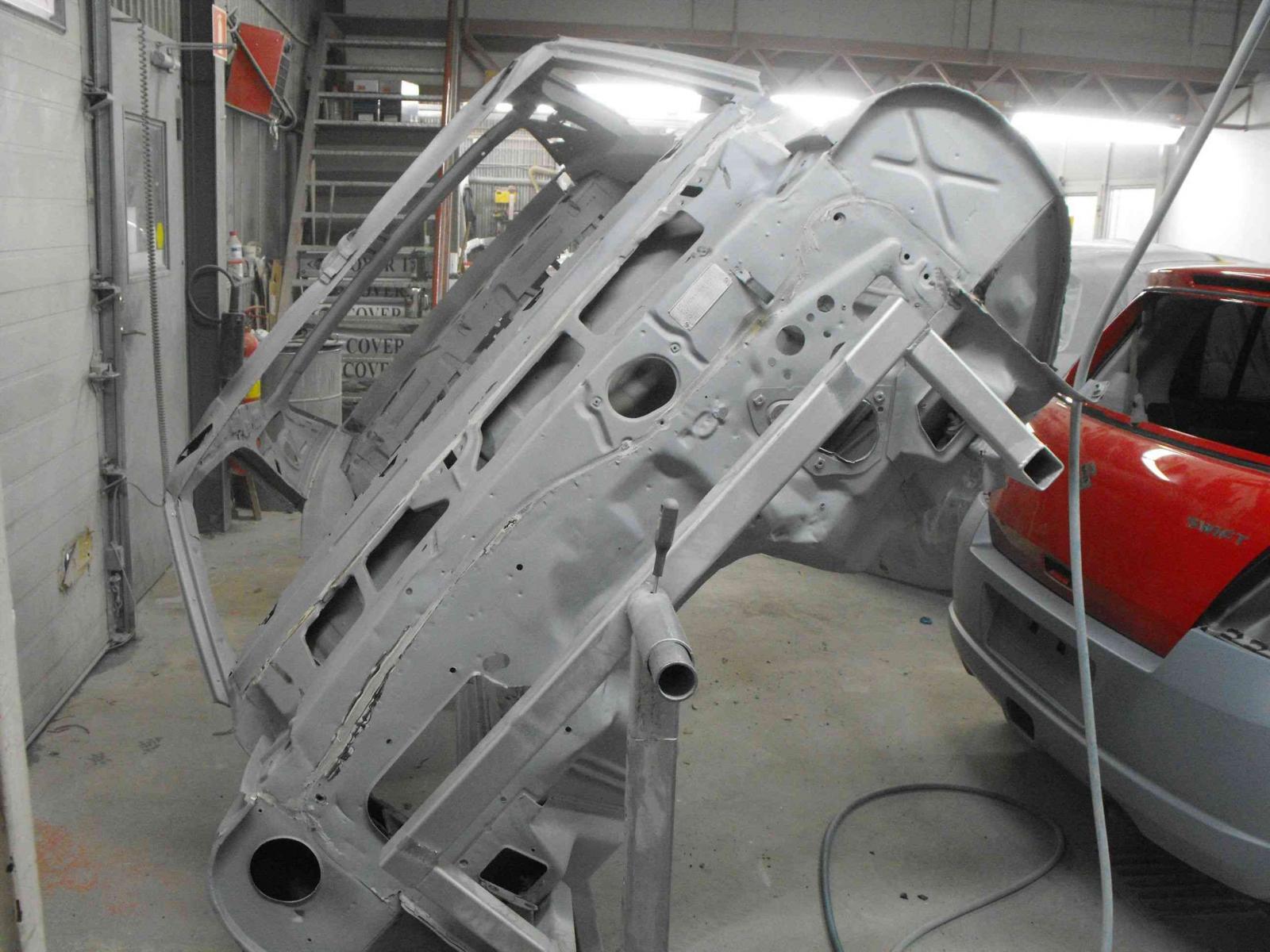

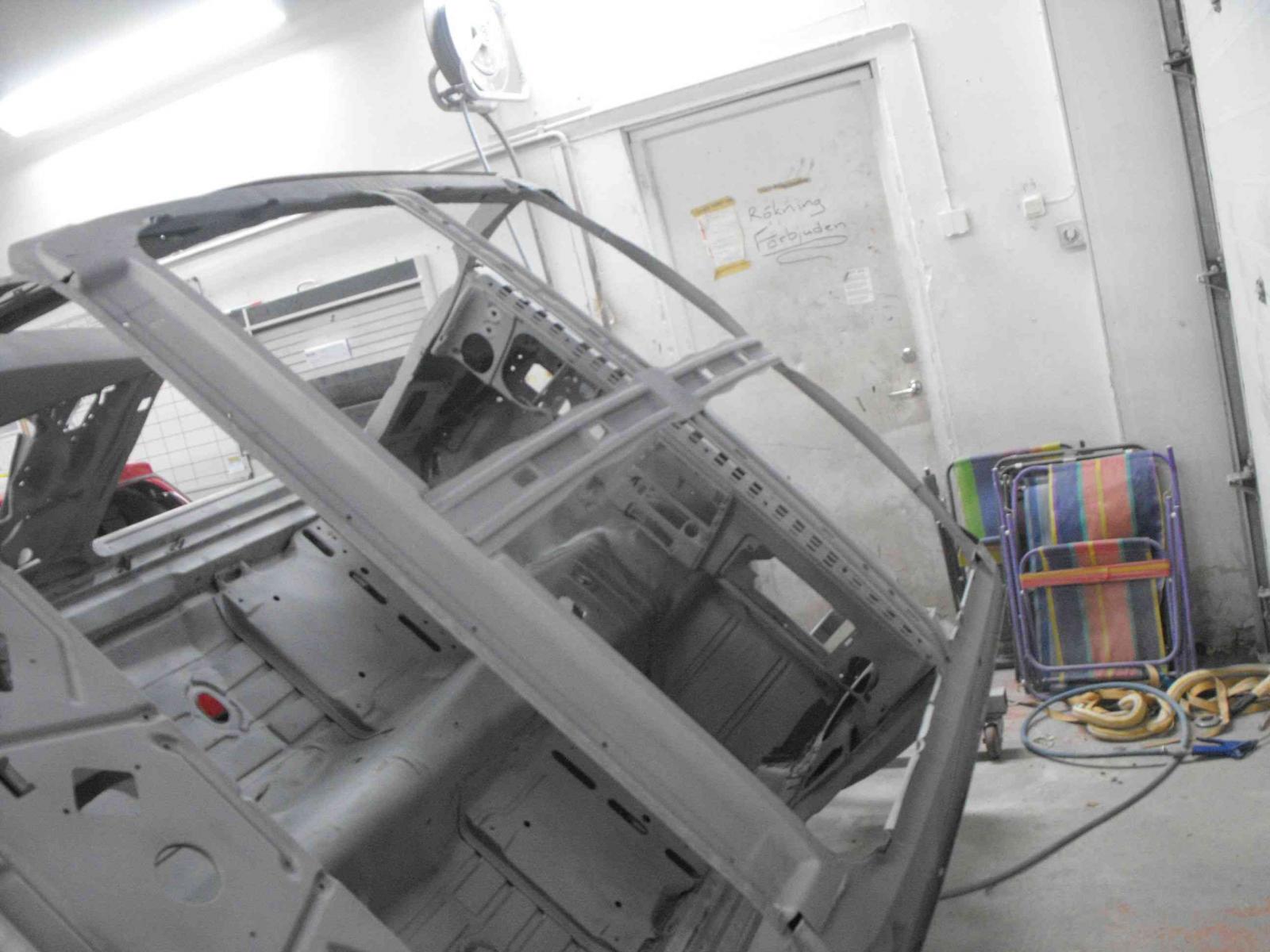

      This is my progress so far

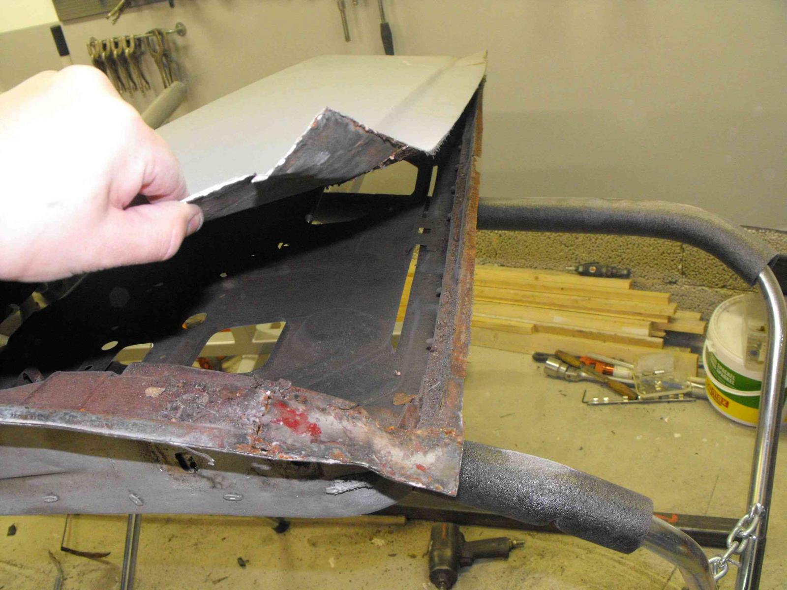

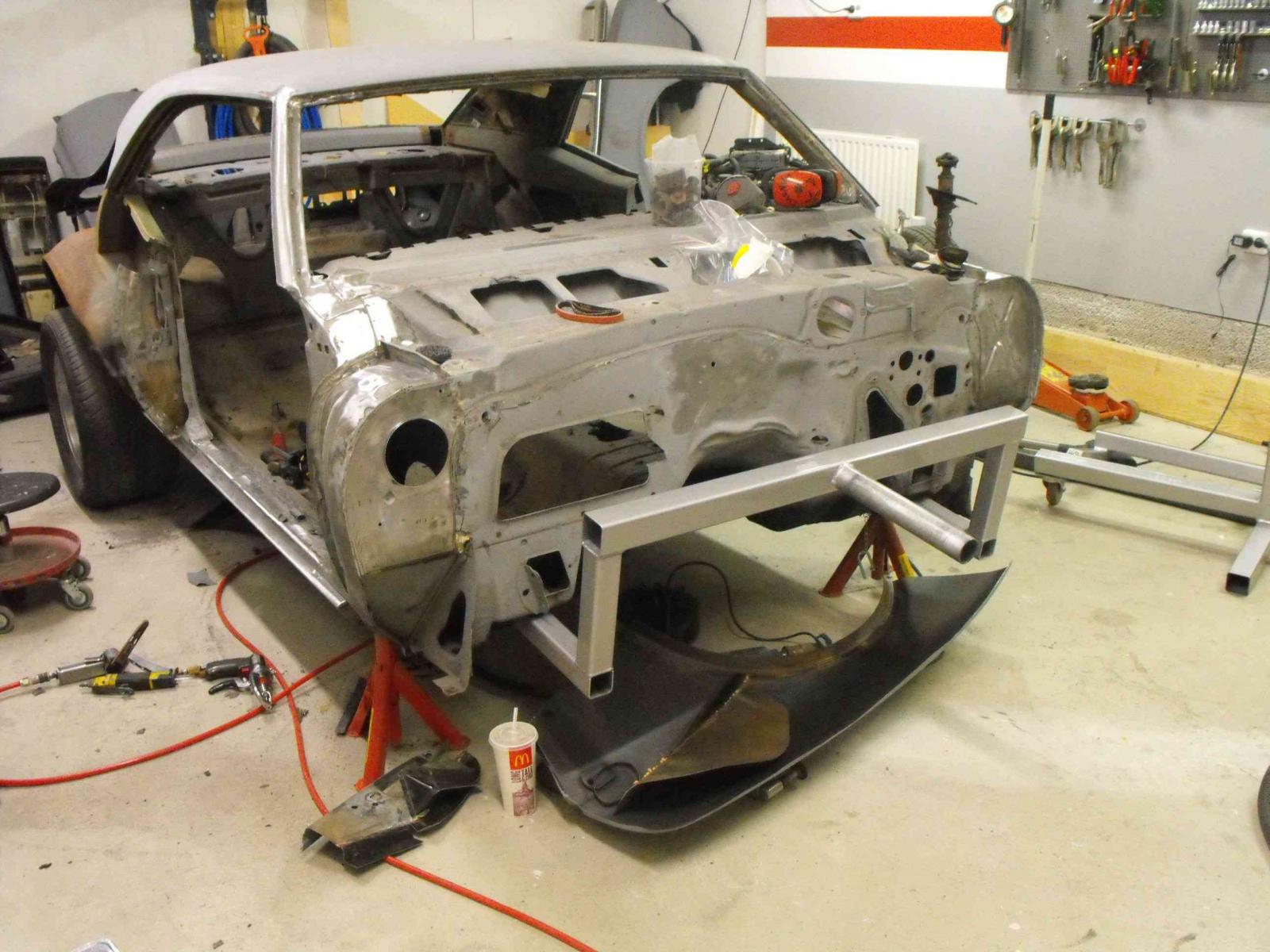

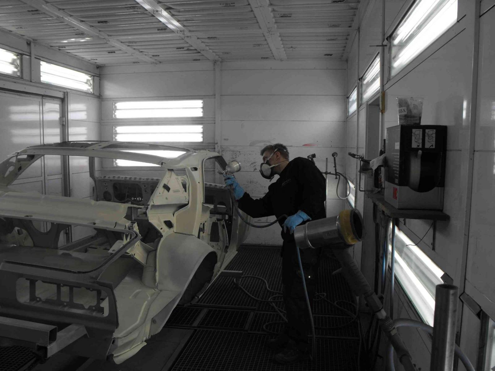

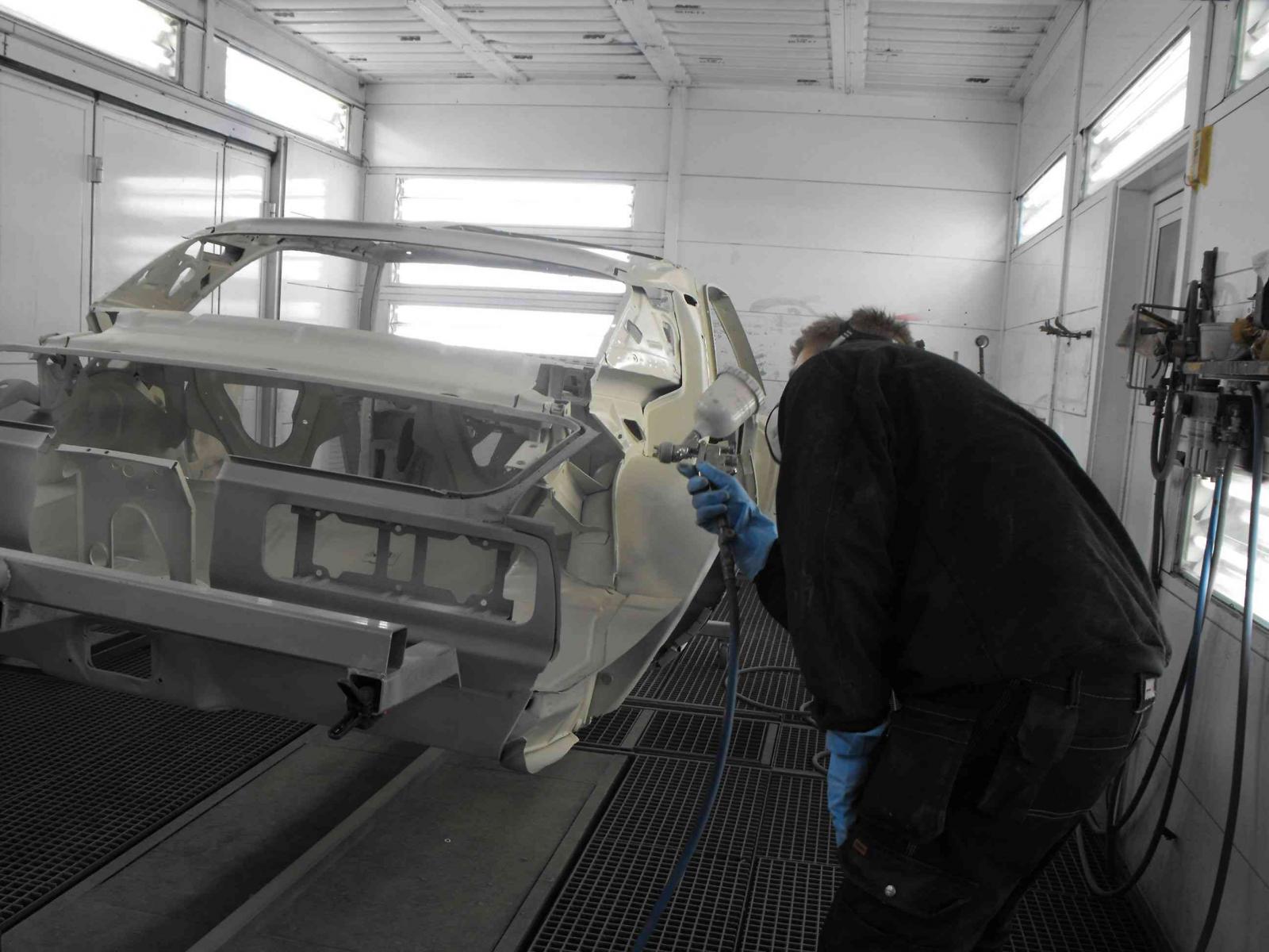

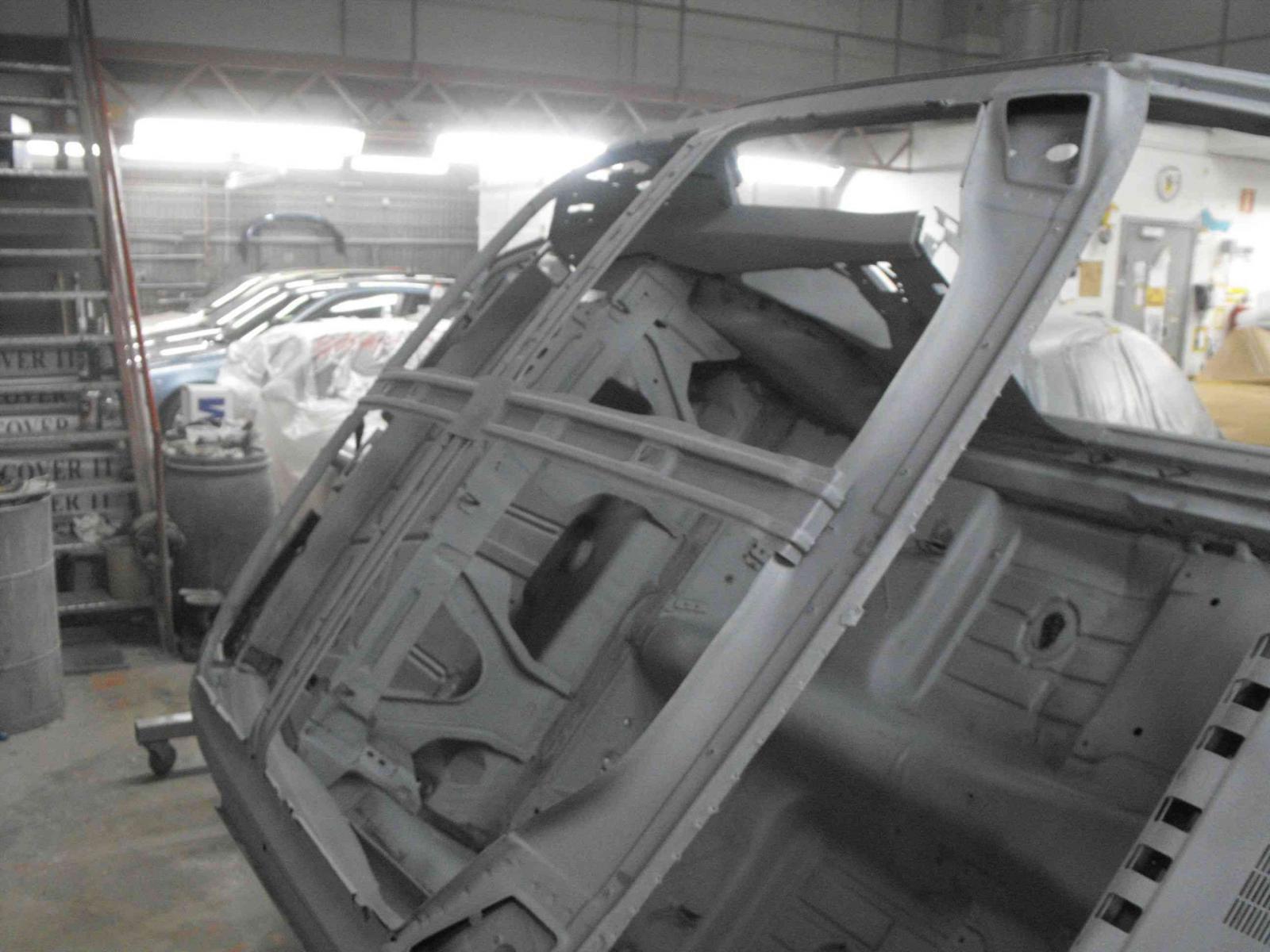

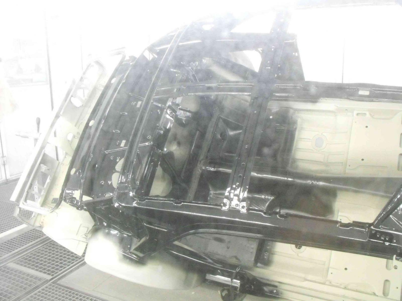

      Cut out all badly replaced metal. Sand blasted all inner structural. Epoxi primer and some paint underneath
      the new roofpanel and other panels.

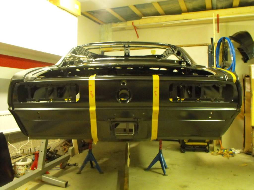

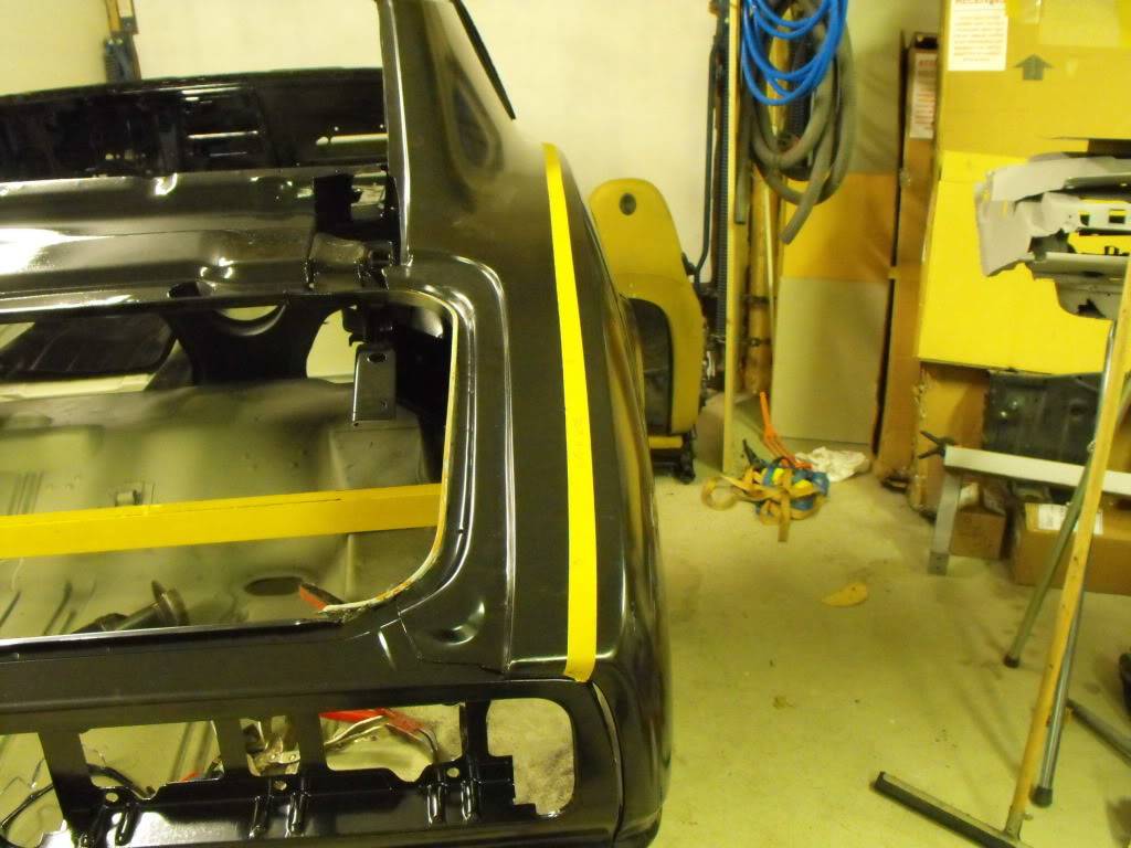

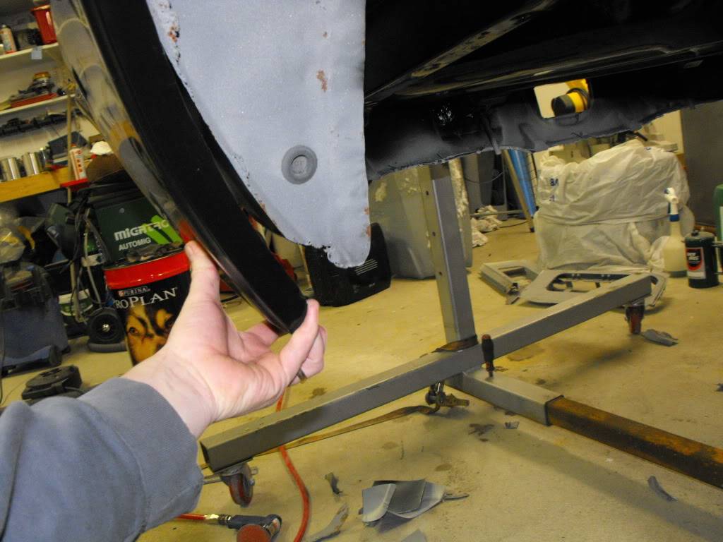

      Wide Ass what do you think?
      Cut the quarter left side of the tape and make it about 2" wider
      Cut the tailpanel and move it to keep orginal space to the quarters
      Turn bottom of quarter front and back
      What do you think, shall I proceed!!!

      To late to turn back now.
