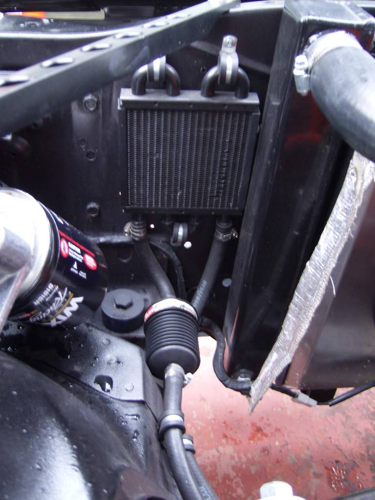

      Its raining outside but i snapped a few pictures for you,,,, I like the ARG stuff the paint on the steering box is a little thin, my box started to show some rust about 3 months after i mounted in(paint it before you install), you don't need too wild of a steering cooler I used Derale #13212 kit, here's How its mounted right next to the radiator on simple rubber coated wire loops, easy to remove and work around
      and on the radiator support i cut a hole so the cooler has its own air flow
      the magnafine filter is the same one that David Pozzi recommended on his website here is a link to them Magnafine

      Woodbine, MD
      2,770
      Rod,
      Can you snap a broader pic of that p/s cooler...so it shows what is around it and the general area where you mounted it? Thanks!!

      heres a picture of the radiator support on the initial build before it was removed for repaint
      and with the radiator mounted

      Its a nice cooler but the amount of volume in fluid might be a little pricey (should add about 2+ quarts to fluid amount) that's why its great for transmissions and it is designed for transmission that run at a higher fluid temp, and with the small cooler the fluid cools in smaller amounts and returns it quicker to the pump (just the consensuses here in the shop) it was hard to narrow the answer because everyone said no! with different reasons (it was a damn funny discussion) we sell both in our shop so it doesn't matter to anyone about the sale of a part, just that it serves its purpose

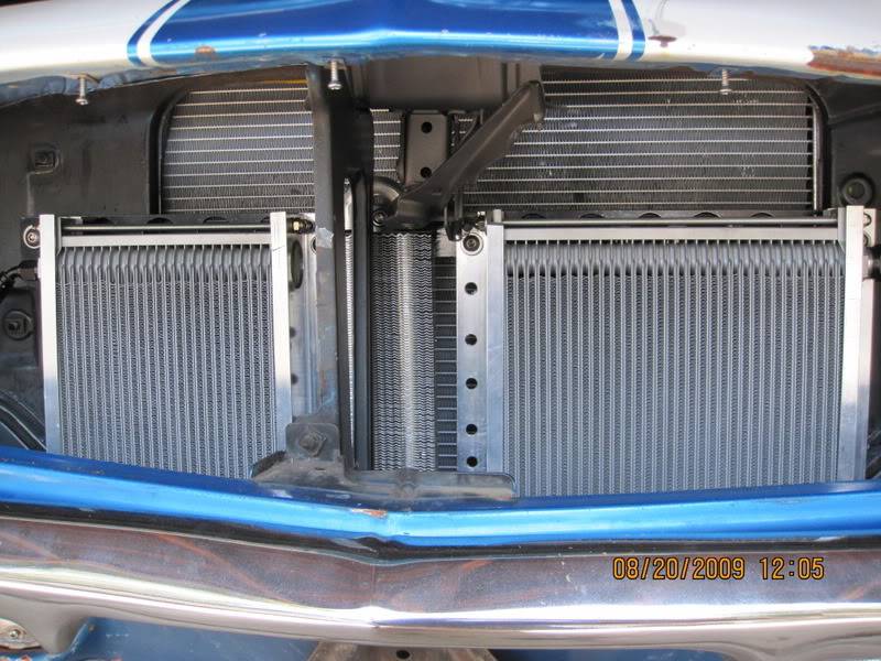

      Hydroboost here, with hopes for some track time so I wanted a P/S Cooler. I was able to stick a P/S cooler between my Trans and Oil coolers:
      I went with Perma-Cool's model #1210 with NPT fittings that removed I put an adapter on for -8 AN fittings.
      http://www.perma-cool.com/Catalog/Cat_page15.html
