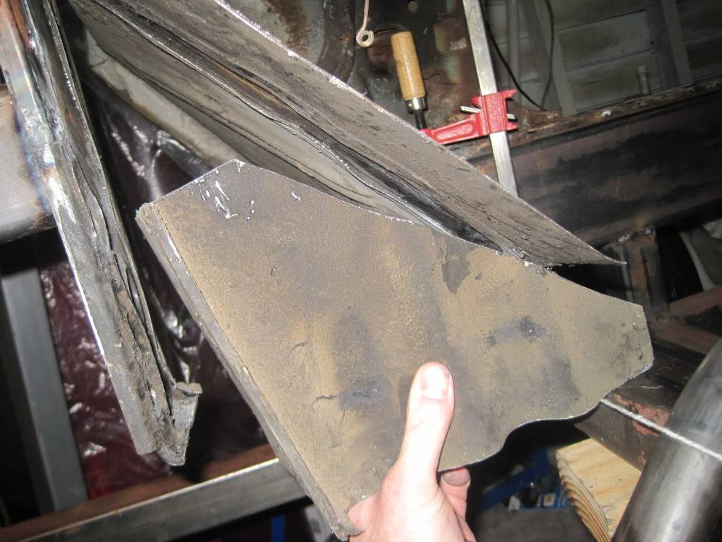

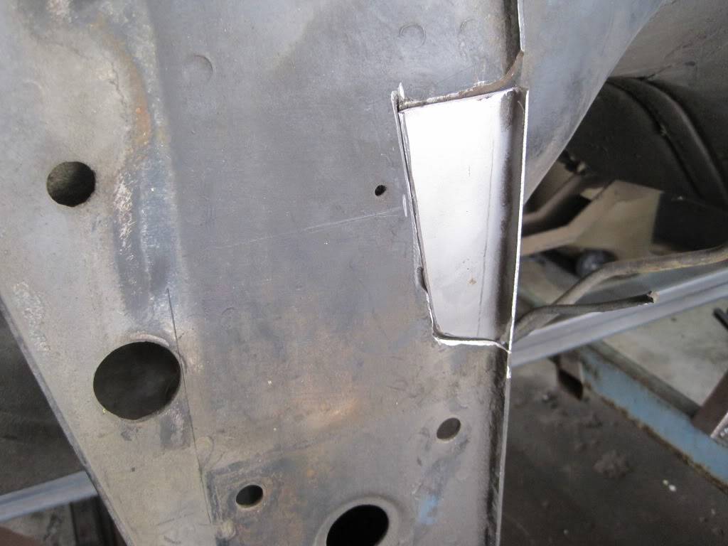

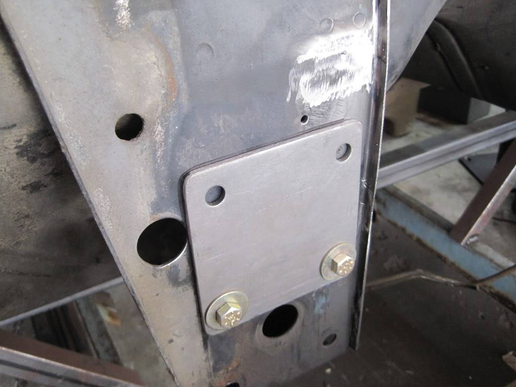

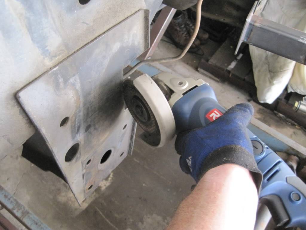

      Front Sub-frame flange repair:
      Here's the repair of where the Scott's Hotrod front clip will mount on the existing Passenger side subframe/flange area...

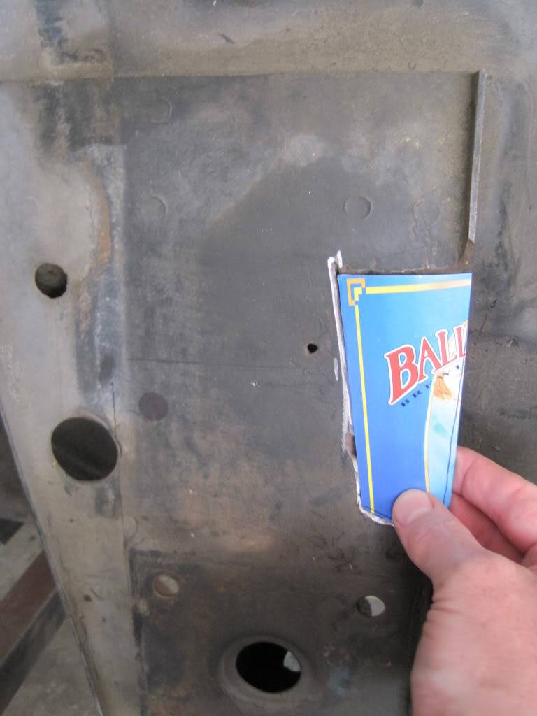

      Clean up of area:
      Ready for patch:

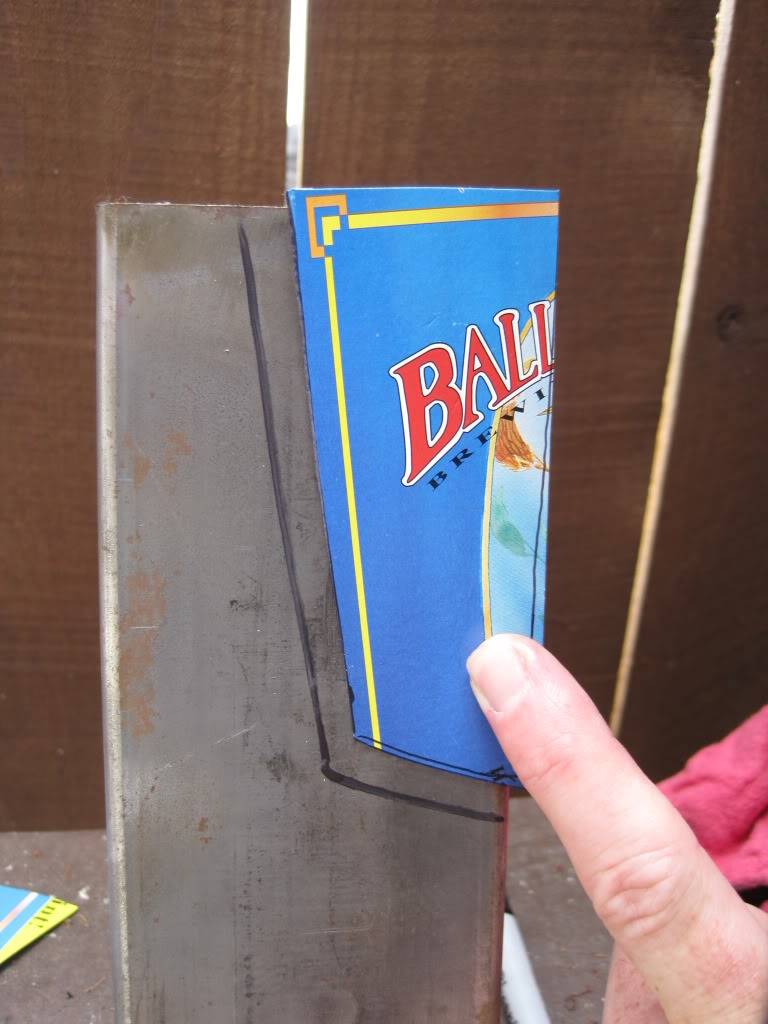

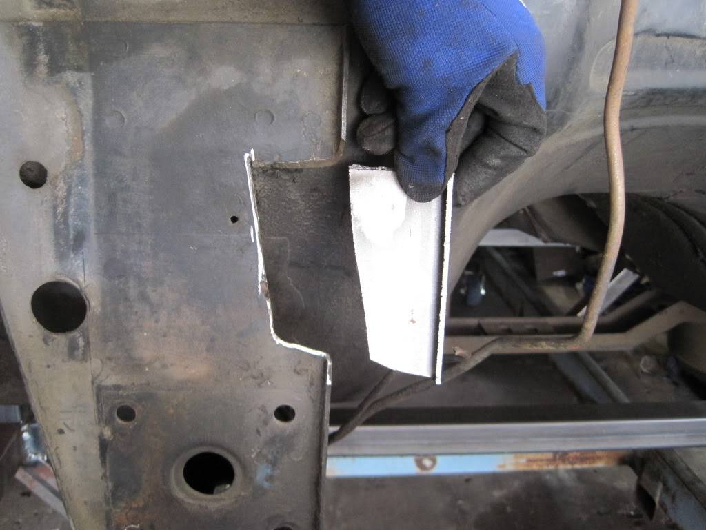

      Create patch template:
      Transfer to metal:

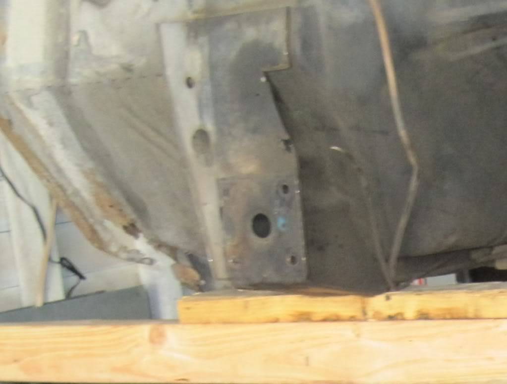

      Test fit:
      Tacked, checked, and finished:

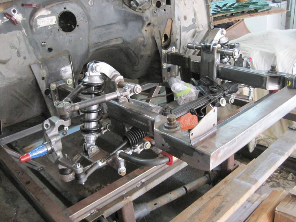

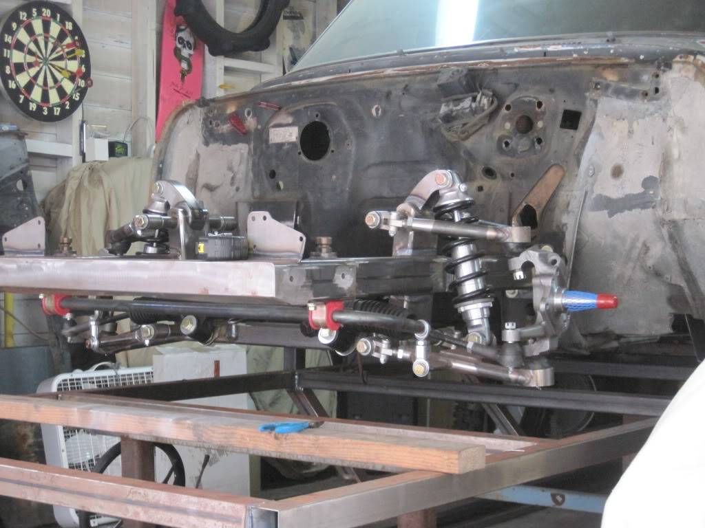

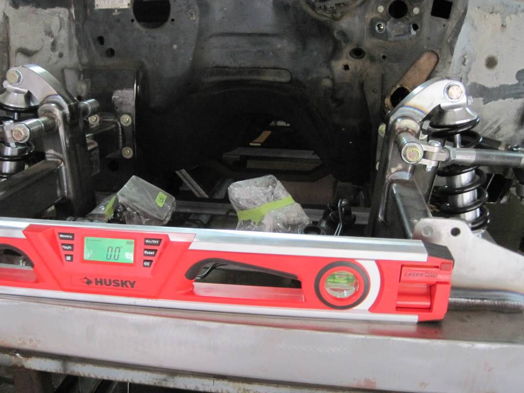

      Scott’s Hotrod IFS install:

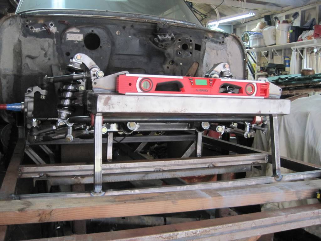

      The Scott's Hotrods IFS was next. Note that the mounting location was moved up into the car 3”, essentially lowering the front end by that much and getting that low and mean stance:
      Leveled and tacked to the table:

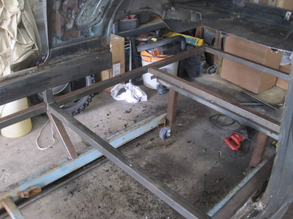

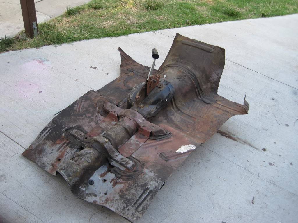

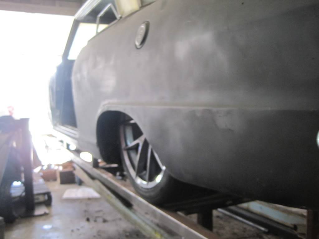

      Floor coming out:

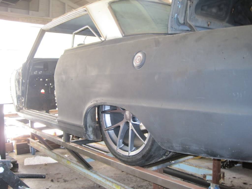

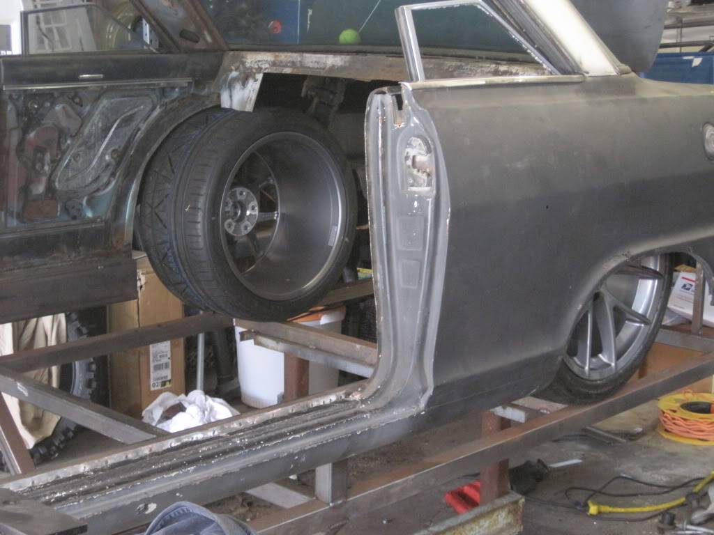

      325/30 ZR19 Mockup:

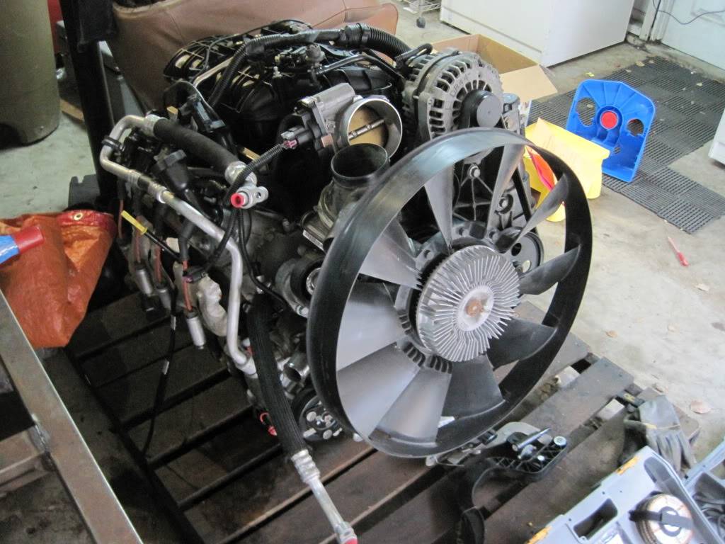

      LS2 Ready and waiting:

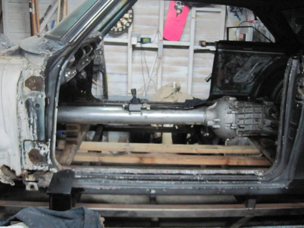

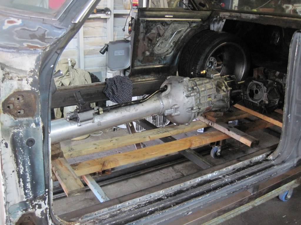

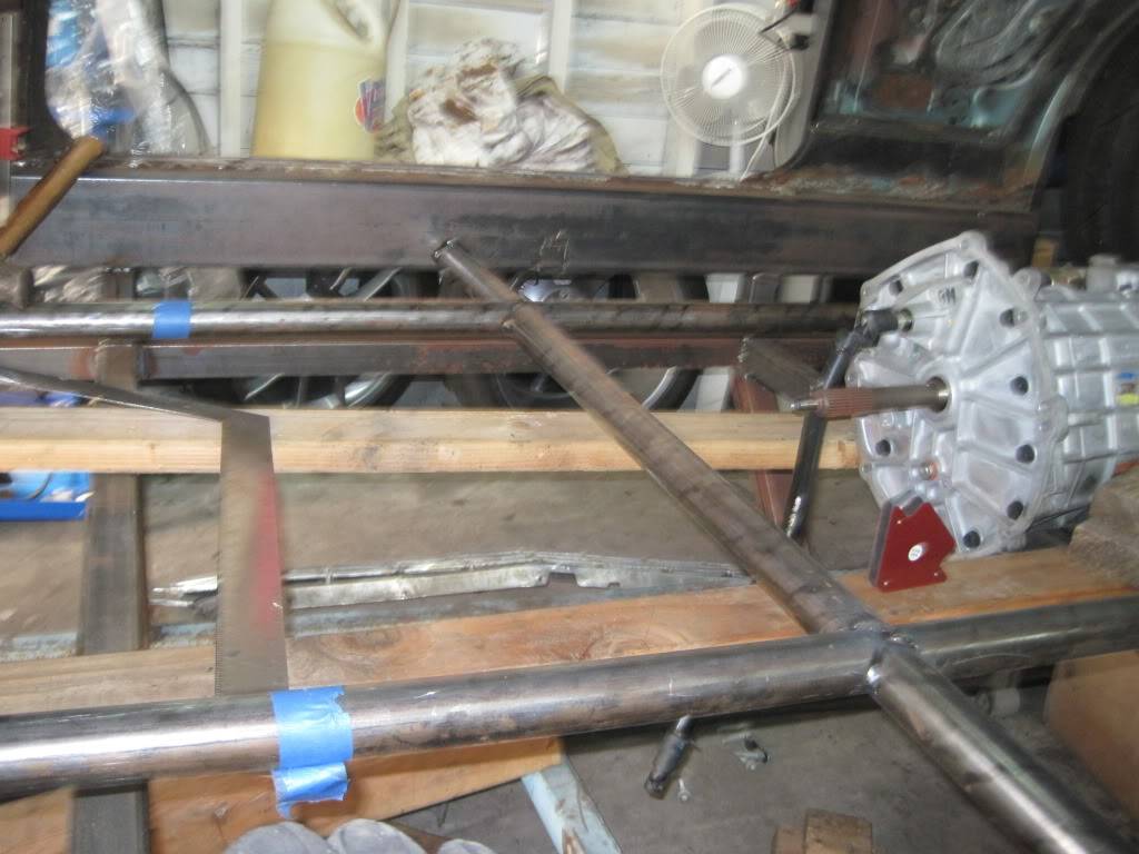

      C5 Corvette drivetrain mockup:

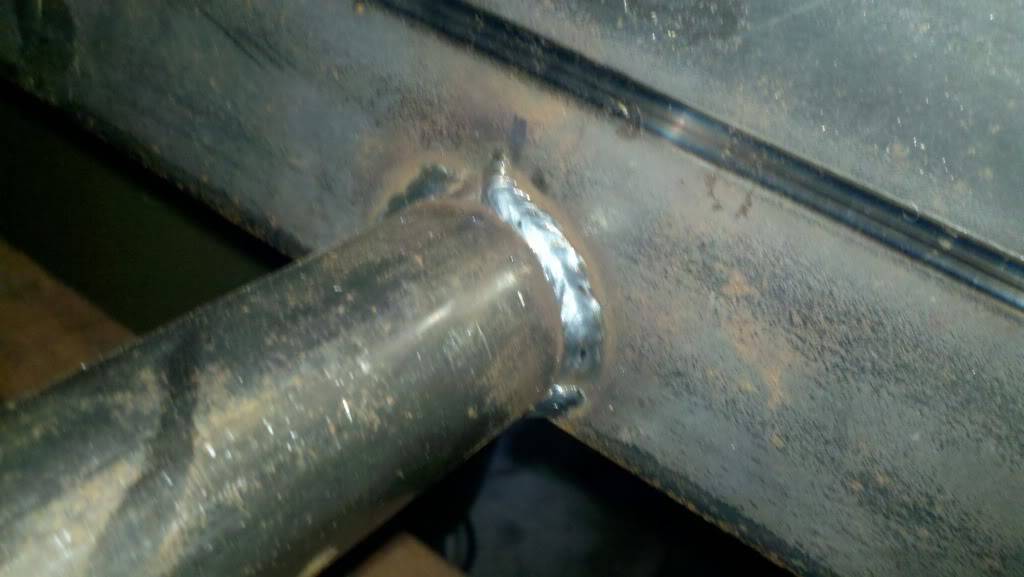

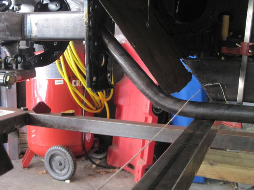

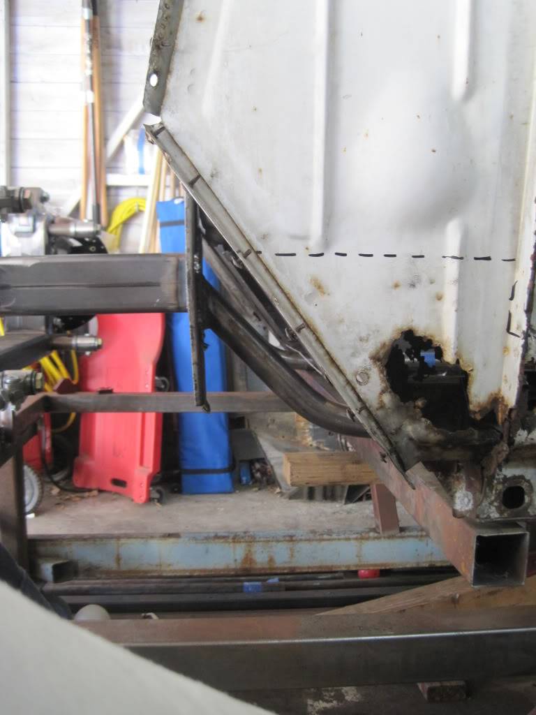

      Removing stock bracing from behind front clip mount

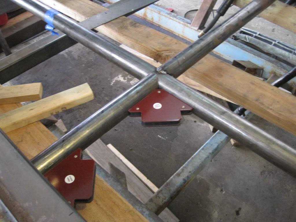

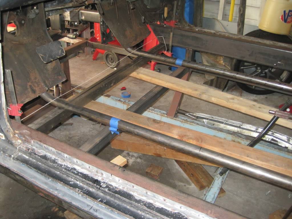

      Main tubes from front clip to rear clip area

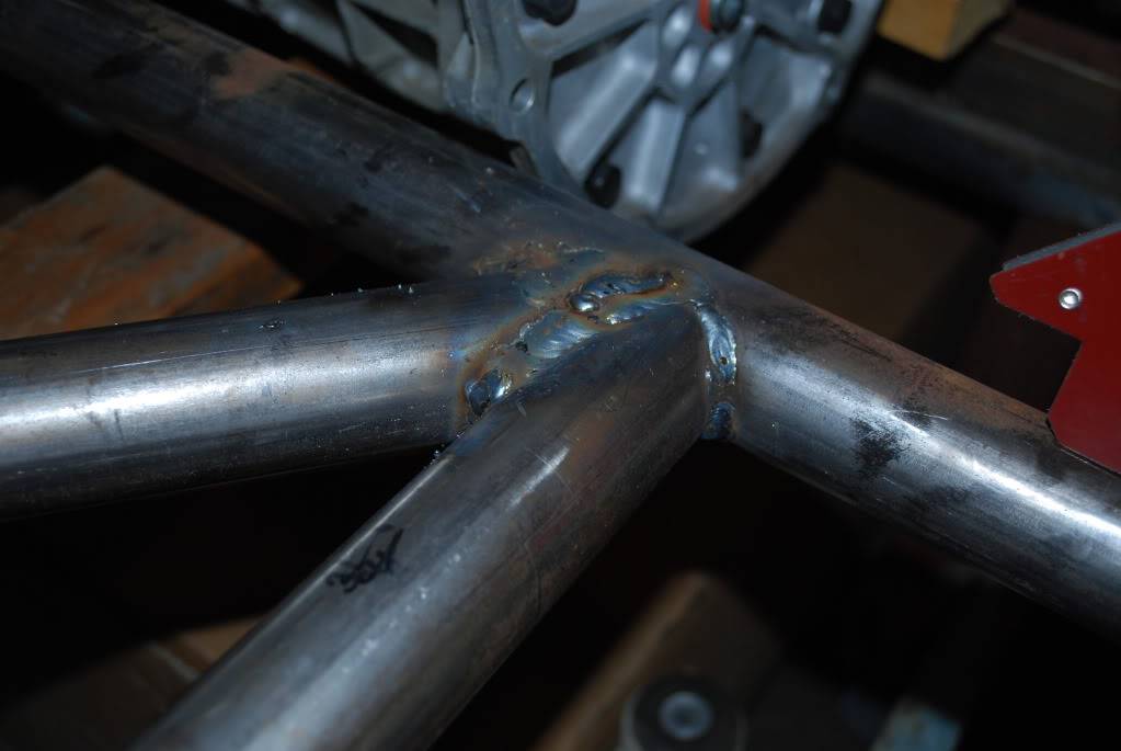

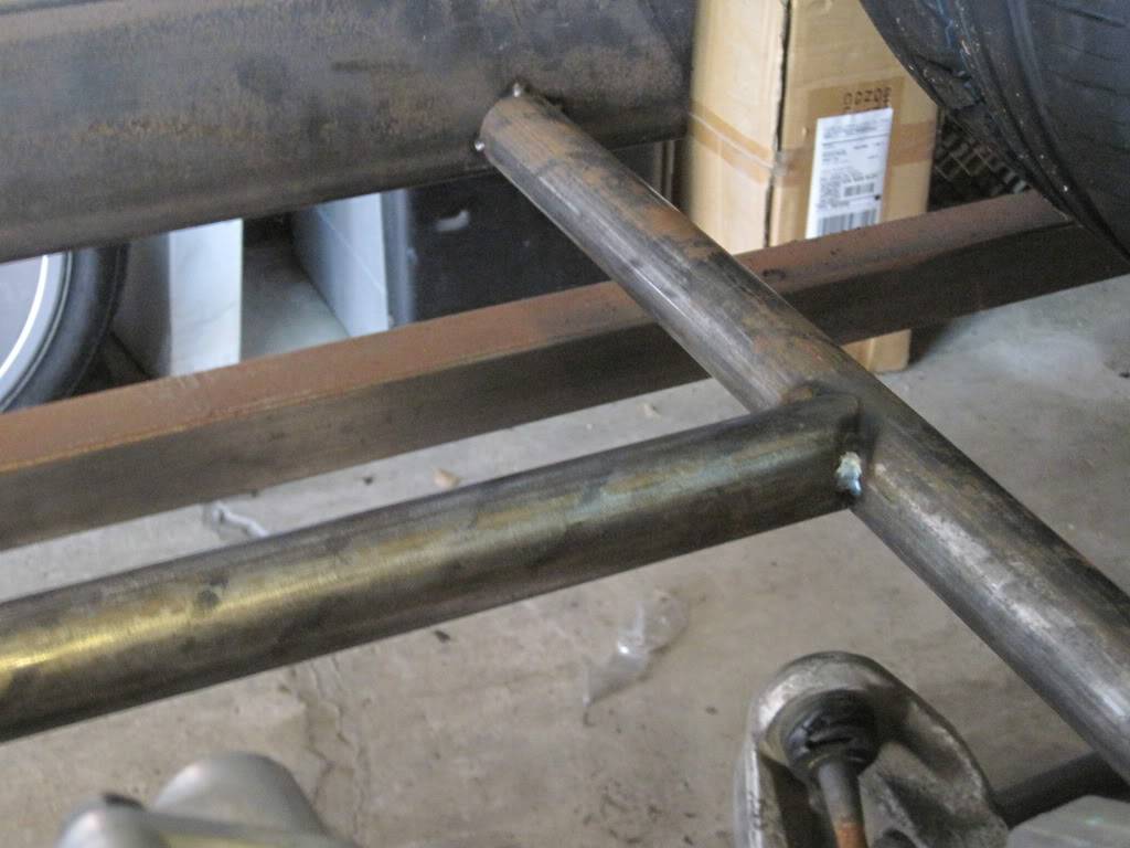

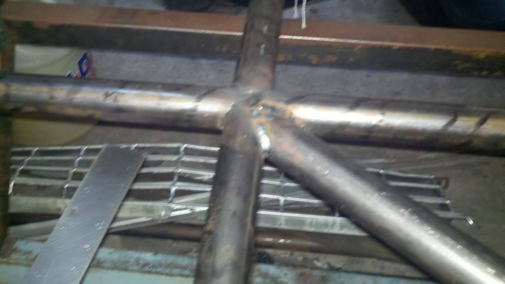

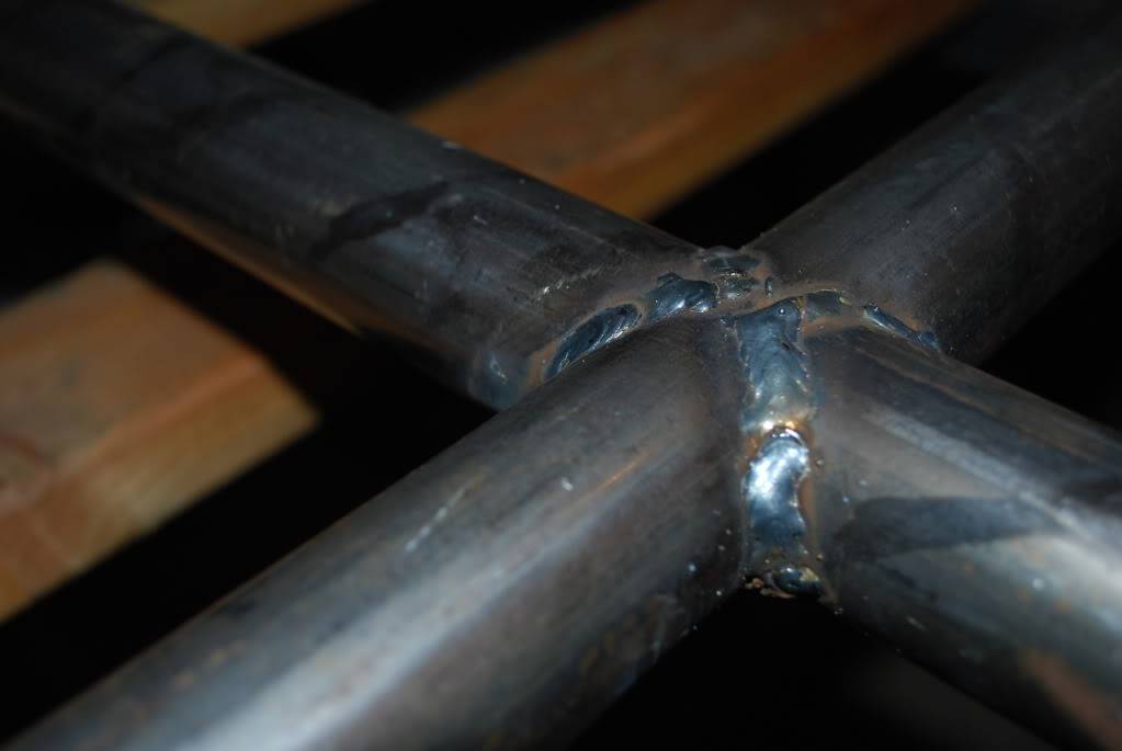

      Installing double X-members:
