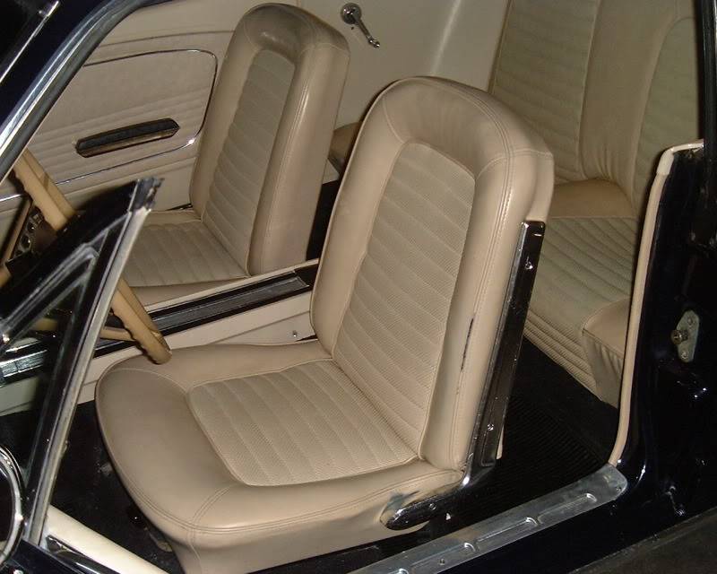

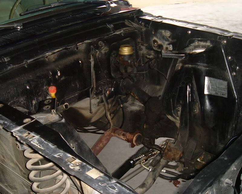

      We are starting a new project. It is a nice 66 Mustang Coupe with a 289 and automatic. We will be adding Rod & Custom coilover front suspension, rear disc brakes, Procar Elite seats, Flaming river steering wheel and column, and steel style wheels with BFG tires. The owner bought it in 1980 and was painted and the engine rebuilt about 10 years ago.
      Here is what we are starting with

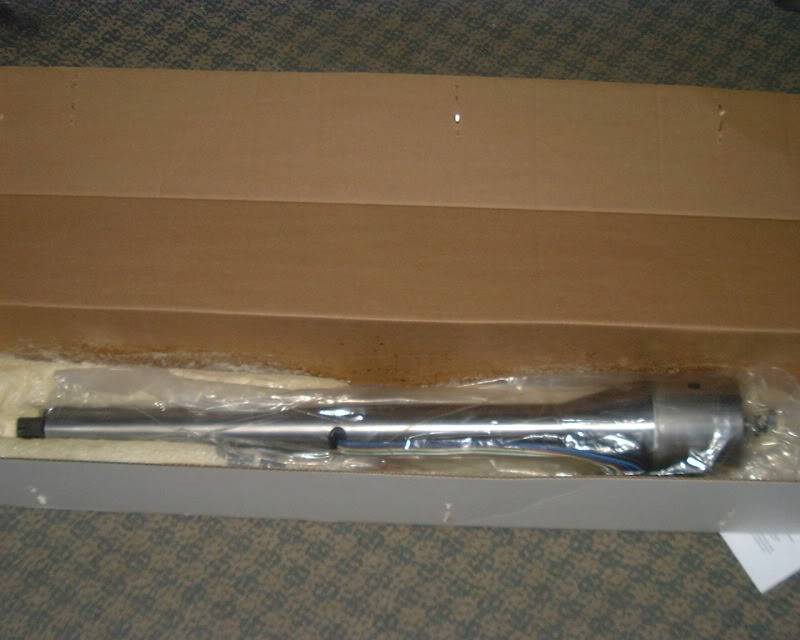

      We received a few parts before Christmas

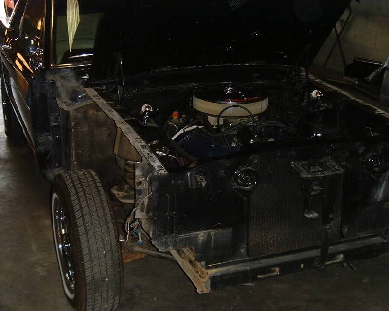

      Today I removed the front end. Next step remove the engine and trans.

      The engine was removed today we are waiting for the new suspension to come in before we cut out the shock towers. Getting ready to order an Edelbrock intake and a set of headers.

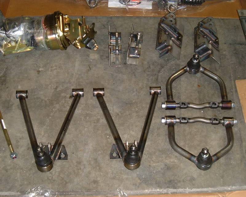

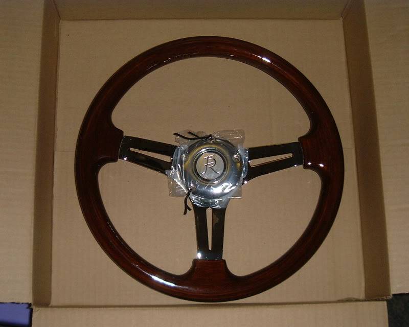

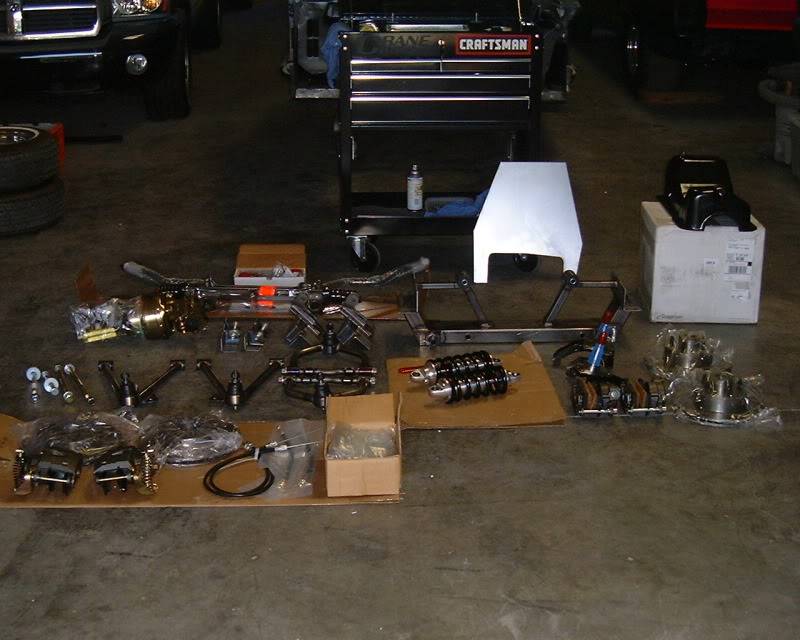

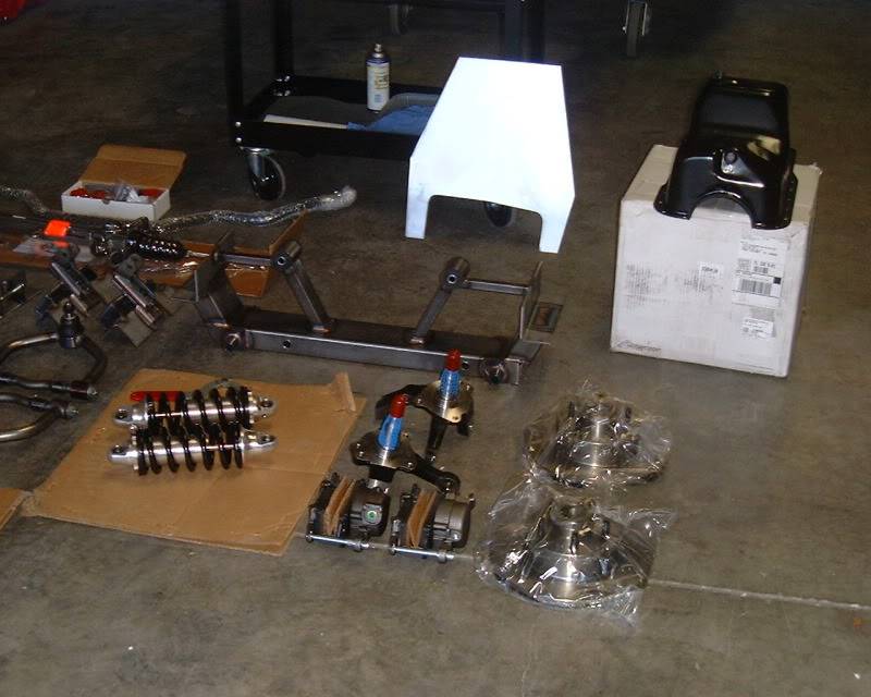

      Parts came in today from Rod & Custom

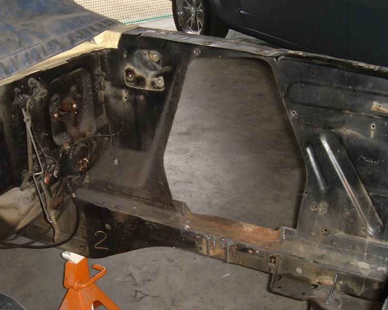

      Ready to cut out the shock towers

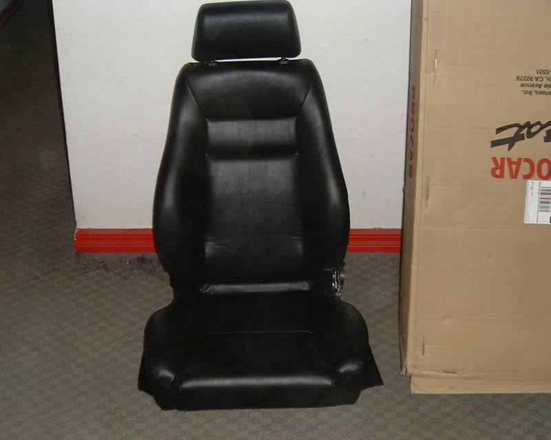

      The Pro Car seats came in today

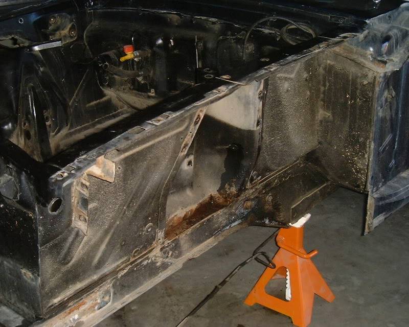

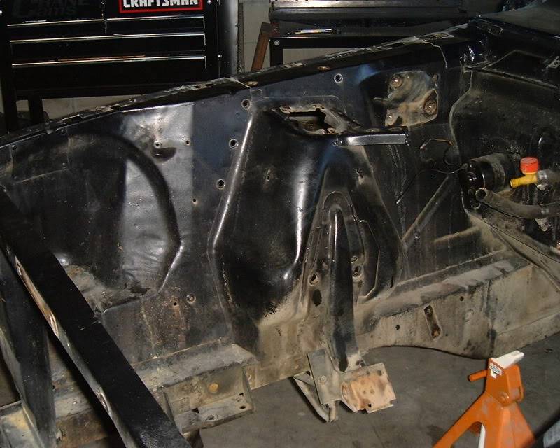

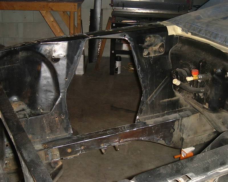

      Shock tower is out on the drivers side. Next step cut out off the strut and sway bar brackets and clean up the area.

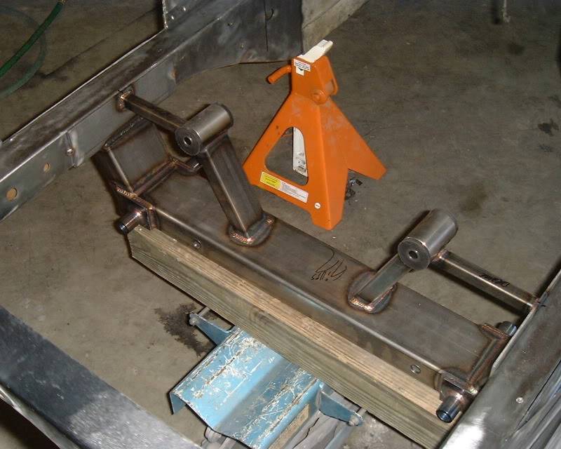

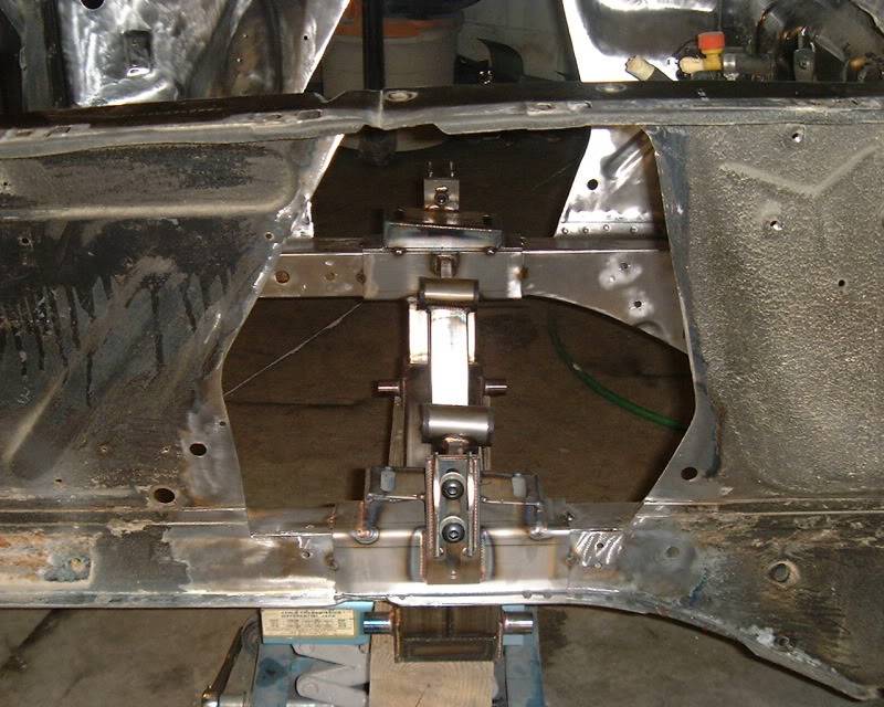

      Brian finished cutting, grinding, and wire wheeling now it is time to start installing the Rod & Custom crossmember.

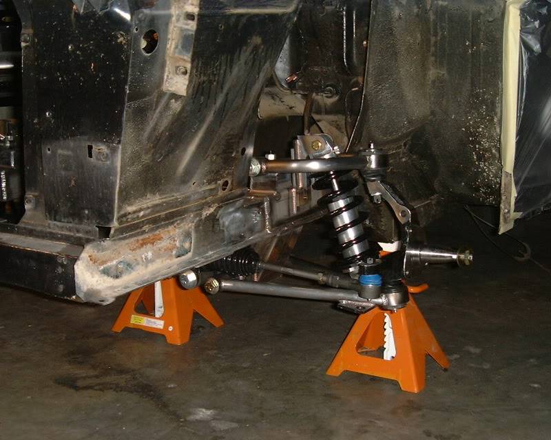

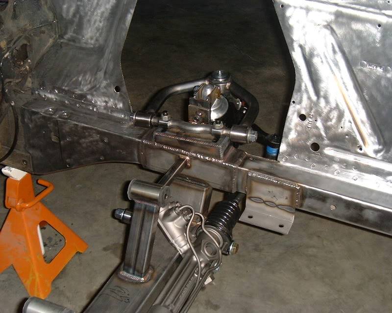

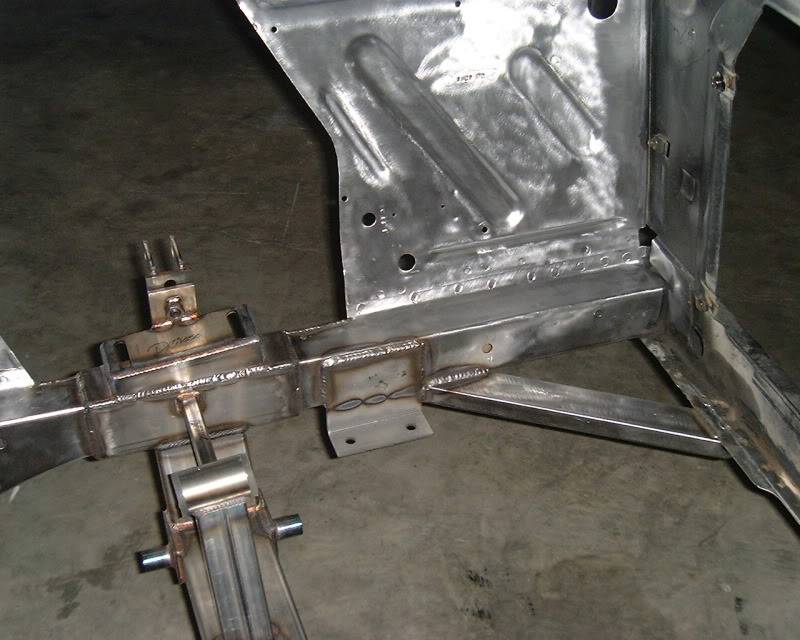

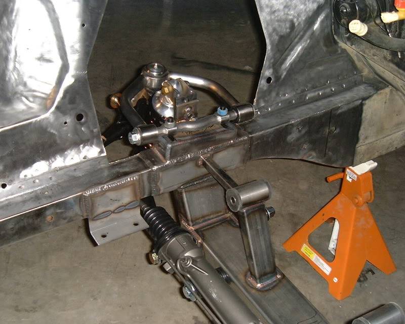

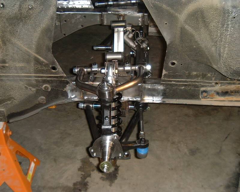

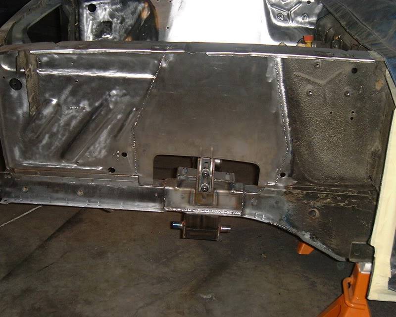

      Brian finished welding the crossmember and than we fit the sway bar and he welded the bracket to the frame.
      Test fitting the suspension.

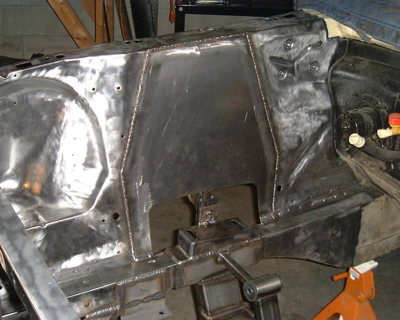

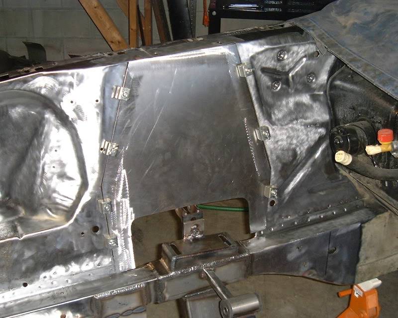

      Brian has the shock tower patches fit and tack welded in place
      Sep 2009
      Port Richey Fl
      775

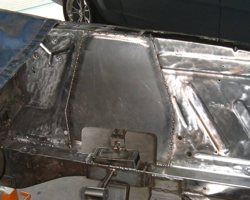

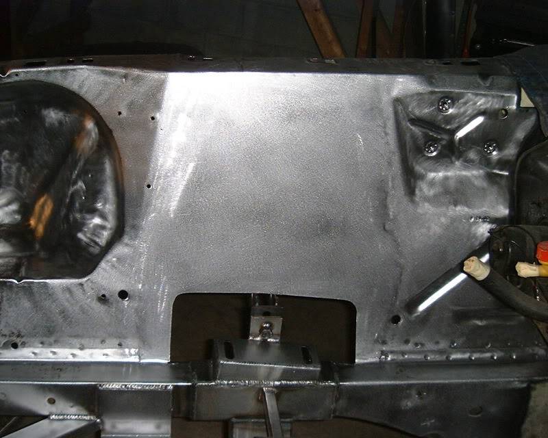

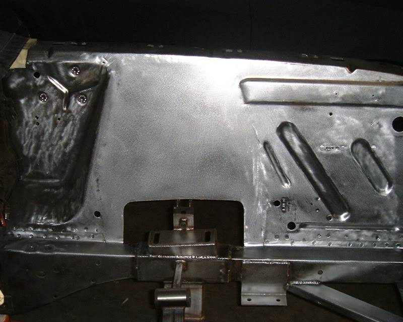

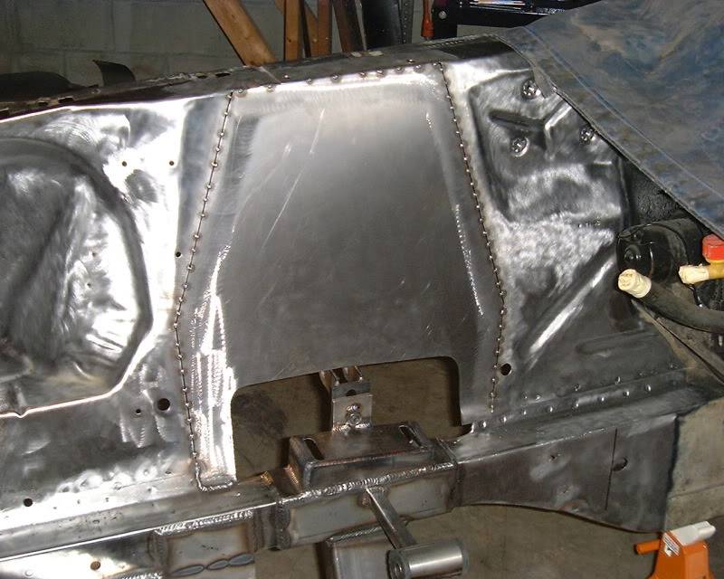

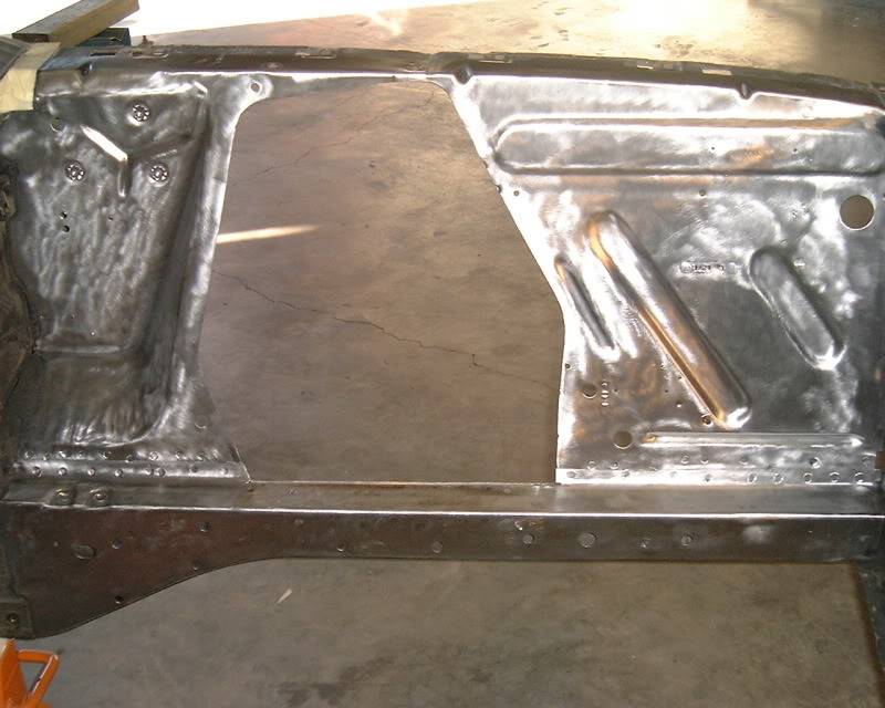

      Brian finished welding the shock tower patch
      Next step was to grind all the welds
      Back side of the fender apron
      Sep 2009
      Port Richey Fl
      775

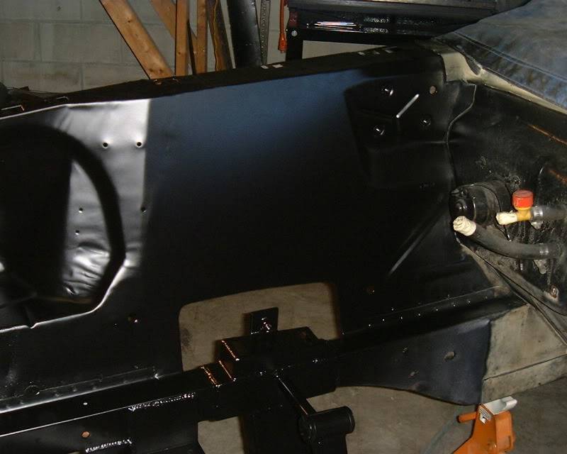

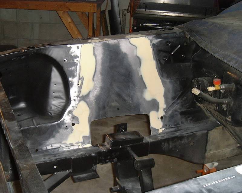

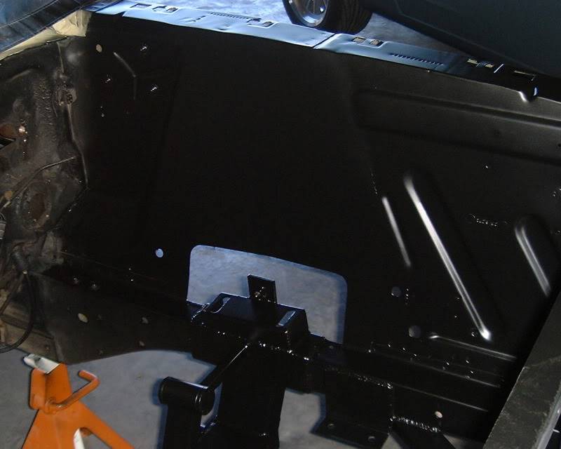

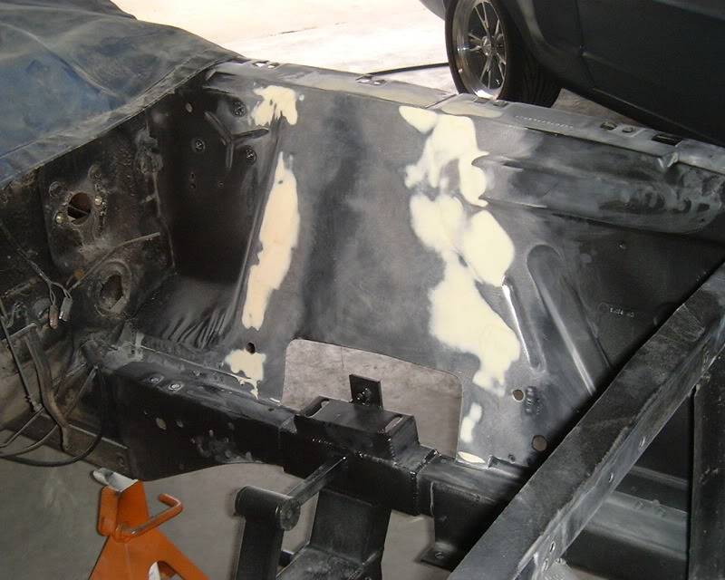

      I sprayed SPI epoxy before starting the bodywork the next day
      Bodywork is finished was going to epoxy prime again but the temperature dropped below 60 and it is to cold to spray epoxy.
