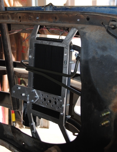

      Used some 1-1/2" aluminum channel that I drilled some 1" holes in for venting:
      Then mounted my trans, oil and p/s coolers to them
      They are a bit low but needed to be to clear the RS door mechanisms and the hood latch.
