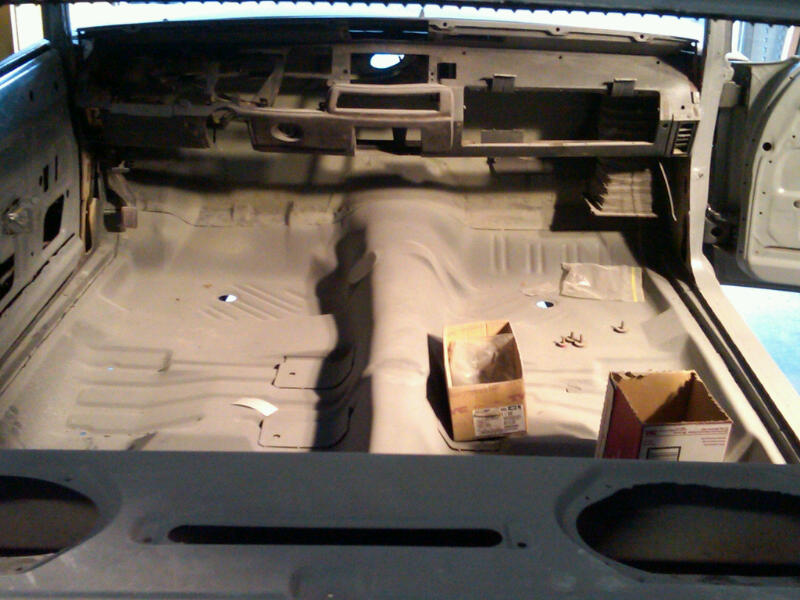

Size:  68.3 KBOK, I am very confused.... I am putting a 6.1 in with auto trans in a 68 Charger, most have seen this in project updates, it is a clean shell, smoothed firewall...etc... I am getting the engine wiring harness and ecu's from the supplier, but now I need a wires for inside the car.. there are so many choices and the prices are all over the map....
      Car will have
      A/C
      ignition in dash
      radio, interior dome light...
      The usual stuff...
      am I over thinking this??
