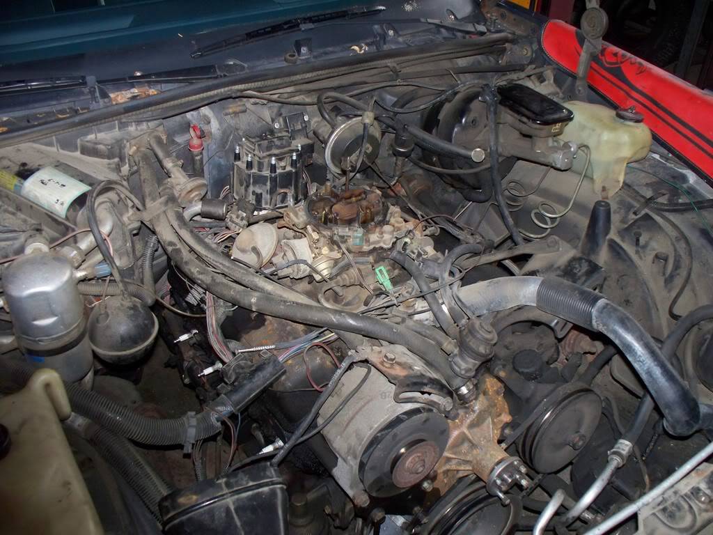

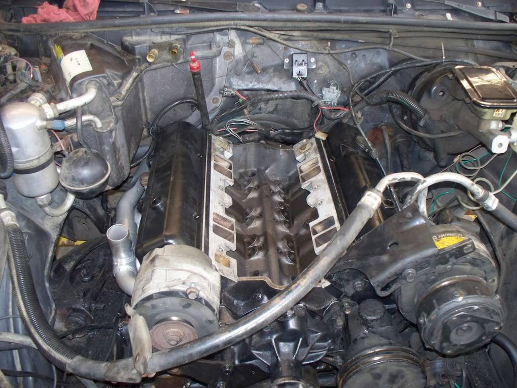

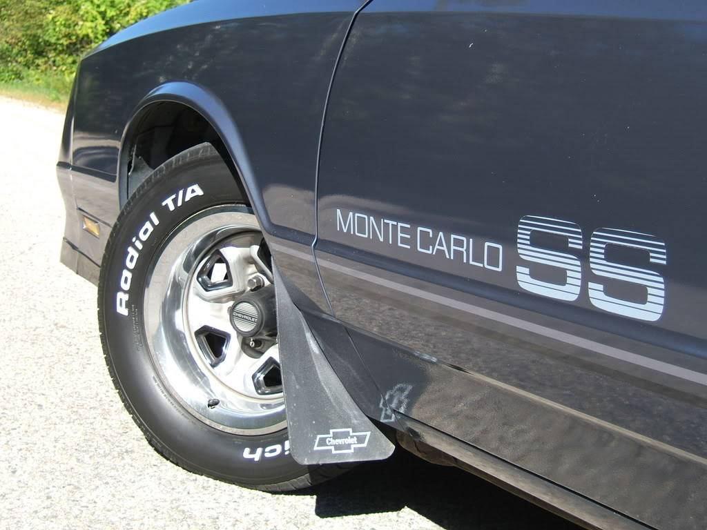

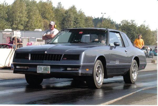

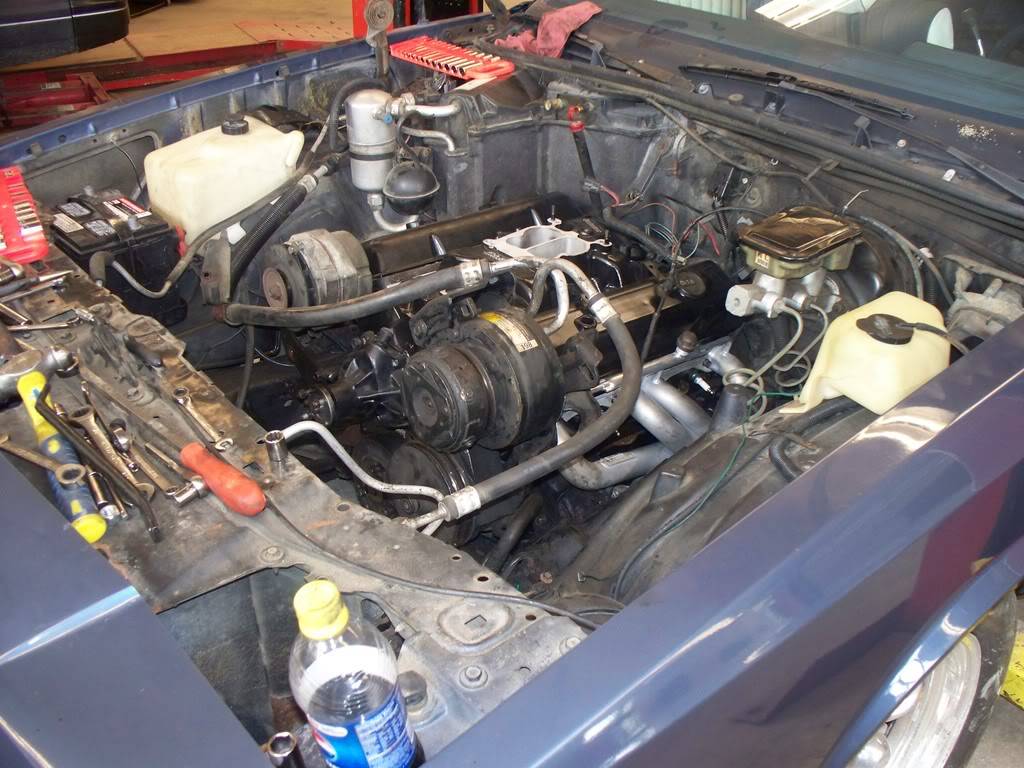

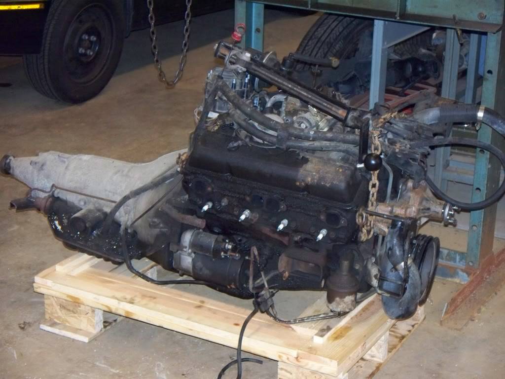

      Hey everyone, Im new to this forum but ive had my Monte since i graduated highschool in 07'. Ive learned alot since i got it and wish i had done some things diffrent. I plan on doing alot to the car this spring/summer. I have a jeep grand cherokee at the moment that i plan on selling come spring and im hoping for aroud $4k to spend on car not counting the rims and tires. Its my DD in the summer but i planning a PT style build. Any suggestions on what to do first would be very helpful.
      Car is an 84SS
      I redid the motor in colege and learned alot. Its still the 305 bored .030, Lunati bracket master 2 cam .480 lift, Edelbrock performer intake, Holley Street Avenger 570 carb, Edelbrock TES headers, and hooker exhaust.
      The front has been lowered 2" with beltech spindles and i added a mini spool in the rear to help with traction at the drags til i upgrade the rearend.
      Time line of pics and a video of the motor stock with just the exhaust.

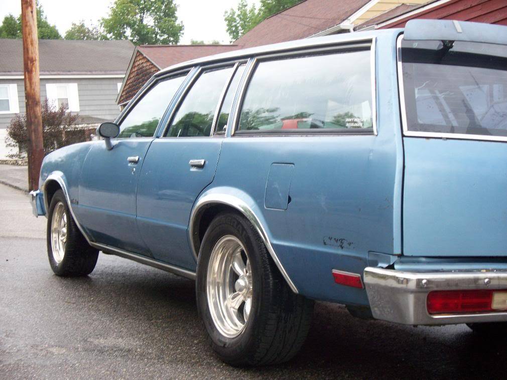

      I kinda have an addiction to g-bodies and the torq thrusts are now on my wagon.

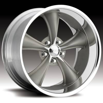

      Looking to get boss 338's 18x8 and 18x9.5 and BFG KDW 2's 245/45/18 and 275/40/18 with my income tax

      welcome aboard! good choice on the boss 338s

      The wagon is real decent on gas but it has a fuel injected 4.3 swaped in from an s-10 with 2.41 gears so its slow and good on gas. It will get the 305 when i put a new motor in the monte.
      The monte gets about 11 in town cause i cant keep my foot out of it and 16 on a trip. Its got a th350 and 3:42 gears so 60mph is 3k rpm's about. It runs 9.73 in the 1/8th mile. Its not great but i like it for the amount of money i have in the motor and the weight of the car.
