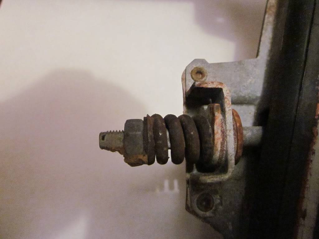

      Does anyone have assembly instructions for '67 Camaro vent windows (particularly the pivot stud on the bottom of the window)? I'm trying to re-install and either didn't document the order or can't find it. There are several spacers/washers along with the spring, some type of lock washers, and the nut.
      Any help, pics or a diagram would be greatly appreciated.

      When the stud goes through the frame: Large washer w/slit, then fiber gasket rest on pedestal. On the underside of the pedestal: fiber gasket-then "D" shaped washer that will face the outside of the vehicle when window is open-then spring-then small washer with locking tab-then nut. I will try and sent you a picture.
      Do you need a photo ?

      having problems loading a picture on this thread. send me a PM with your e-mail if you still need a photo.

      Chris
      Thank you very much. I couldn't find this info anywhere in the net.
      That is exactly what I needed.
      Problem solved!!
