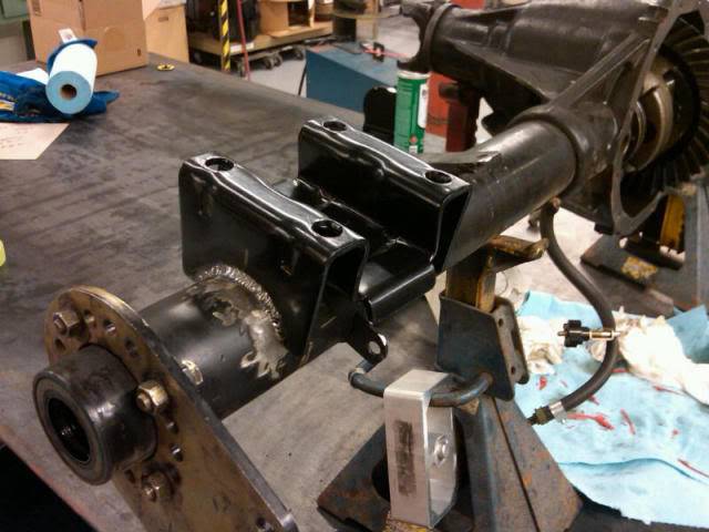

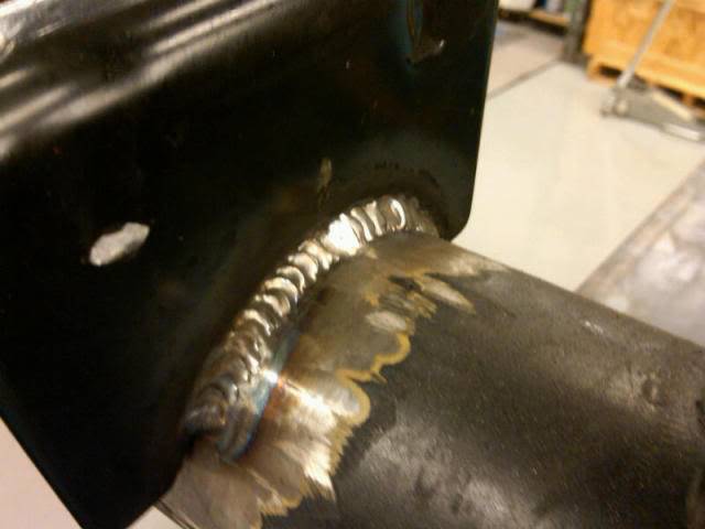

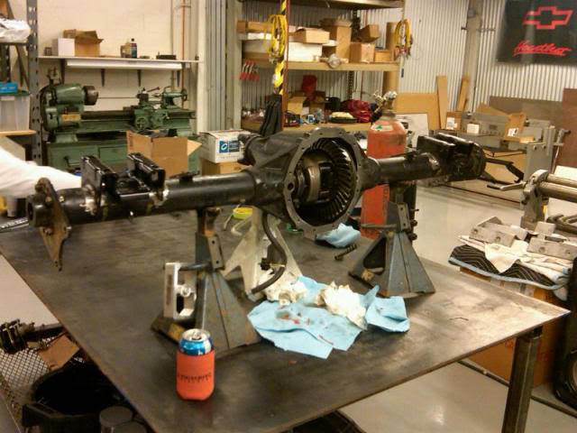

      Okay, we have been working on remedying this problem... Got the two 5/8" diameter punched holes filled and welded up. Then we spun the rear over and left it overnight checking for any seepage. After that we tossed the new leaf spring pads on there and set the pinion angle. Got them all burned in and we are starting to reassemble the rear. Below are a couple shots that I snapped on my phone. You can see the lowering block hanging on the jack stand that punched the hole. I went ahead and buzzed it through the bandsaw to shorten up the pin. I took about a half inch out of the pin. Then cleaned it up on the belt sander.

      So what are we drinking budlight?
      May 2001
      Mesa, Az.
      1,435
      Yeah man...
      No self respecting car junkie works on a project as annoying as this and doesn't crack open a convienent brew
      LOL
