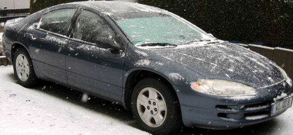

      Since Jess' Honda broke down we are looking for a new ride.
      We don't wanna spend a new Trans. into the Honda.
      We found a 2002 Intrepid, 2.7L V6 with almost 94k mls. on it.
      Is there any major issue with this modelyear?
      What about the oil sludge?
      Seller is asking $4000.00 but is willing to negotiate.
