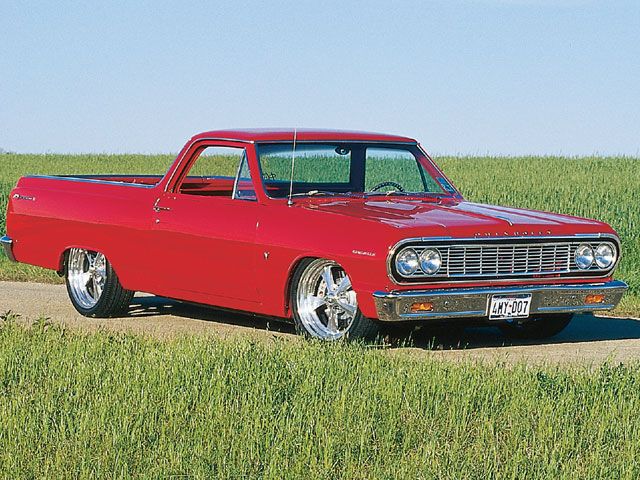

      This a 1964 El Camino I built a few years back and regretfully sold to a friend in Texas. The Elky had Airide, Baer Brakes, 18" and 20" Billet Specialties. This was a tight fit due to being hammered, big brakes, and the rear being a tight fit.
