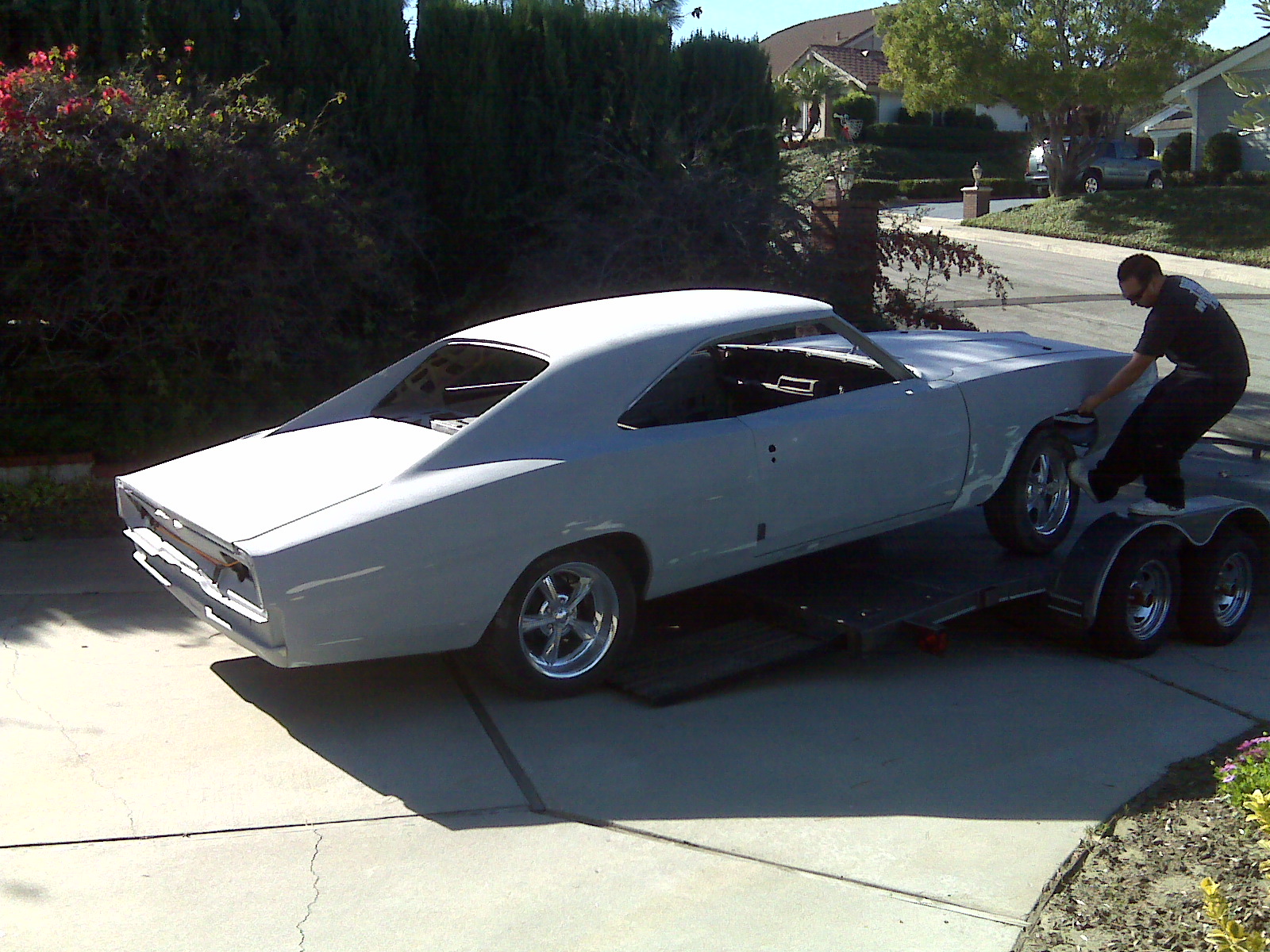

      Here we GO!!
Size:  597.8 KBPlaced my order with Bouchillion for the 6.1 Hemi Kit.. with auto trans, it comes with everything from Radiator to gas tank, headers, wiring( for engine and trans) and a bunch of other stuff, + AlterKtion...OK here we go!!!!!
