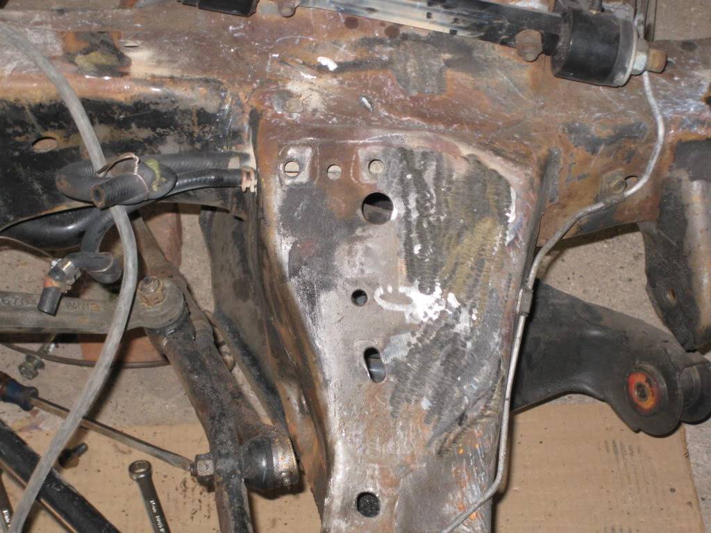

      Did a little work on the firewall today. Filled and welded- getting a little closer. Also filled in holes in the chassis too. Order the paint for motor. Jen can't wait see pick her favorite color

      I filled in more holes on the other side.

      here is some pic's of the firewall It was a pain to paint. We used P.O.R-15 and it's very thick and can't be wet sanded.

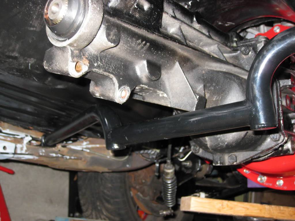

      The mount for the trans is on a 22 deg angle.
      fixed the crossmember today. I had a piece of angle steel tig welded to it. Then I made a new mount for it.
      all painted and ready to go
      here are some more pic of the crossmember and trans

      Why is the trans mounted at such an odd angle? I am not familiar with the t5's at all - are they mounted like that factory?

      The trans came out of a f-body car. I had two choices to make with mounting the trans. Choice one: mount it level and the shifter will be kicked on a 17 deg angle into the driver seat. Choice 2: kick the trans mount 17 deg. I know it looks funny.

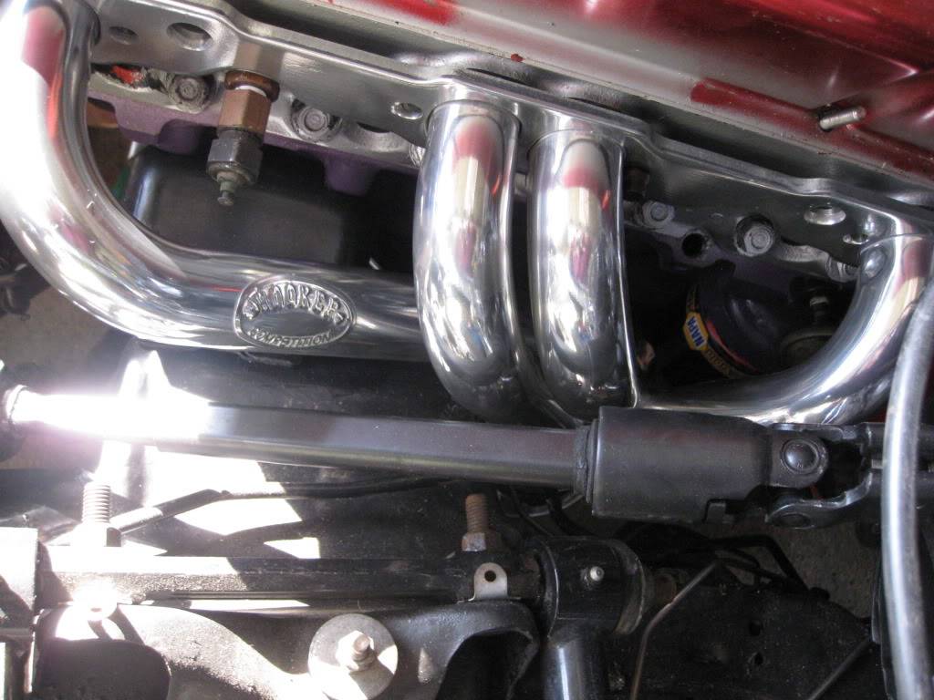

      My headers came back from jet hot coating. I 'm still upset that I had to buy 2 sets headers (f-body and g-body.
      Look they don't hit yeah!!

      looks like you used a jeep center link between the steering wheel and the steering box... i had a problem with the rubber joint by the steering wheel, really close to header, eventiually the rubber became loose and i ran a bolt thru the jeep center link and that fixed that problem... it is a bad experience to turn steering wheel and the wheels do not turn....
