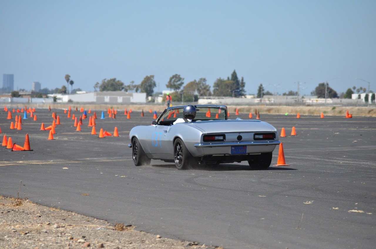

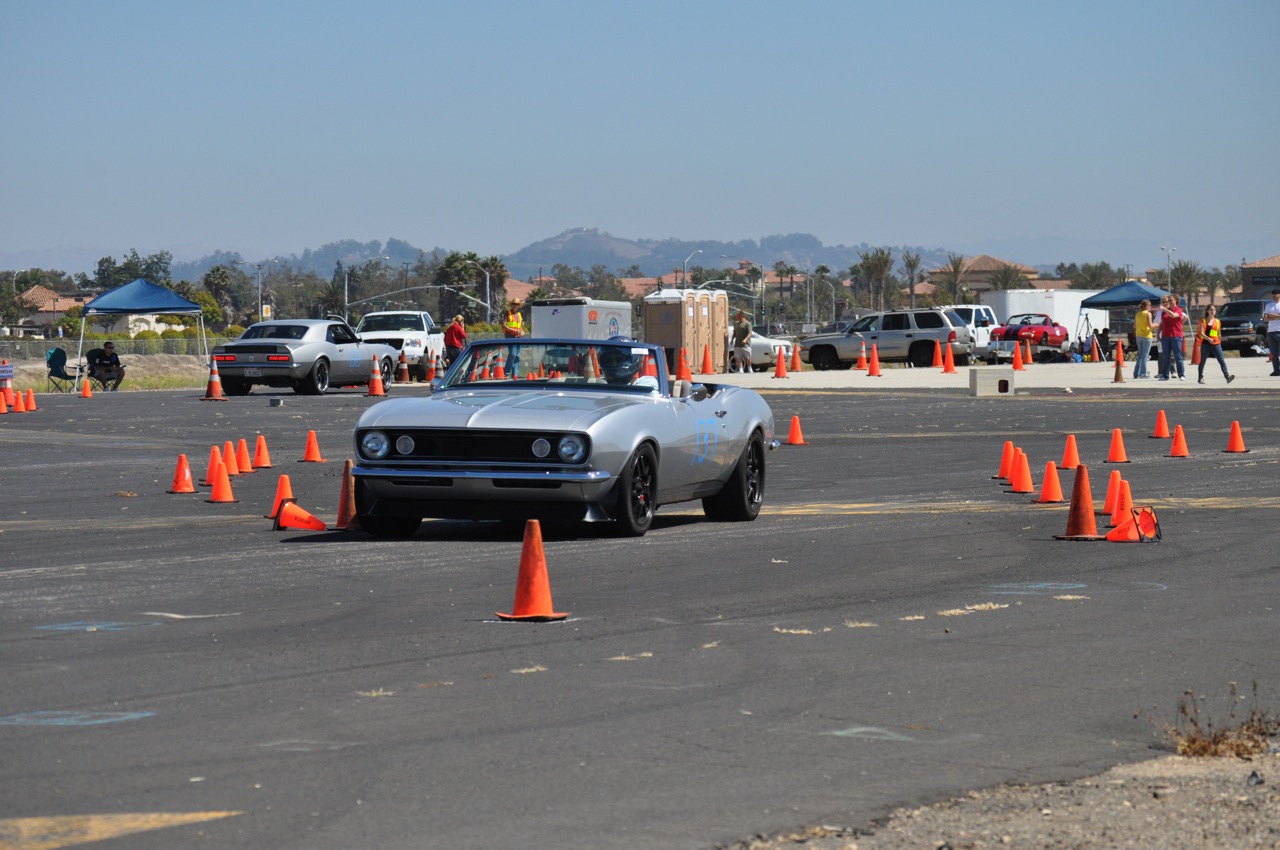

Size:  253.4 KBI have a modified Martz front clip on a 67 Camaro with LS motor, The angle of the strange coil-overs were increased creating less leverage (making car stiffer) Using a 550 front coil-over spring. I have a C Alston rear 4-link with strange coil-overs at slight angle to inner tire (also a little less leverage) Im using a 250 rear coil-over spring. I have recently run the car in some autocross and it is level as can be with 200 treadware tires. My suspension is stiff enought that the car would benifit from a slick type compond.... There has been a few videos posted on this site of my car running. Let me know if your interested and ill direct you to them.
