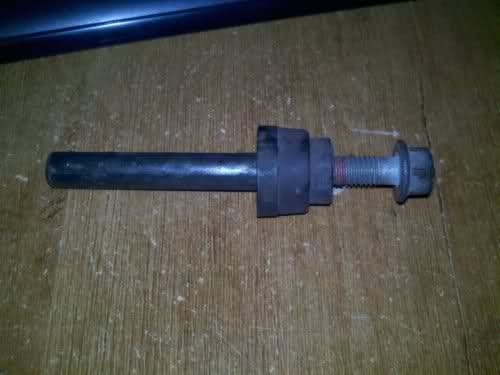

      This bad boy:
      I need everything except the actual "bolt" (with the threads).
      The old one is... completely seized, I don't think it's going to be possible to get it out, I tried everything I could think of today.

      That's the one I was describing to you - the slider pin. To the right above the rubber dust boot in your picture are flats that you can put an open end wrench on to keep the pin from spinning when you loosen the bolt. If that doesn't work, I'd first try a breaker bar and a 6 point socket and snap the bolt head off. If that doesn't work, an air cutoff wheel to cut the bolt head off will certainly do the trick. As I said, a new pin and bolt are inexpensive. Just be careful so as not to damage the abutment - those are about $50.
      Napa sells the pins. $11/pair. Kore3 sells them, $4.50 ea.
      http://www.napaonline.com/Search/Det...+50012+2012030
      http://www.kore3.com/proddetail.php?prod=10035-01
      Napa sells the pins. $11/pair. Kore3 sells them, $.50 ea.
      I have new abutment brackets, I bought from Tobin. The old ones are seized. I'll get a set from him, the local Chevy dealership wants $20 a pin.
