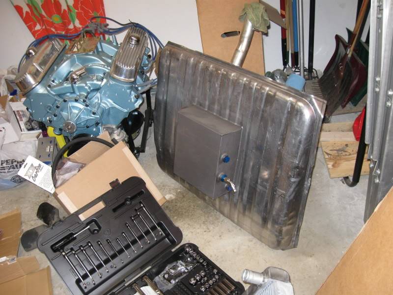

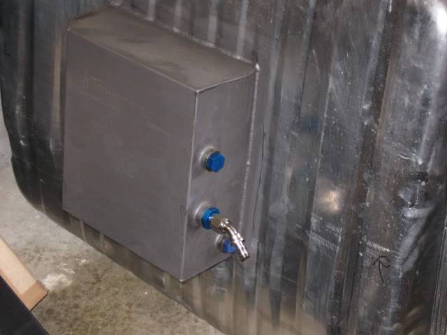

      I went the low buck but effective route. Took a BRAND NEW stock tank and welded in a baffled road race style Aeromotive sump. It has AN-10 inlet and outlets.
