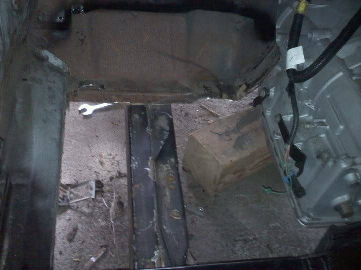

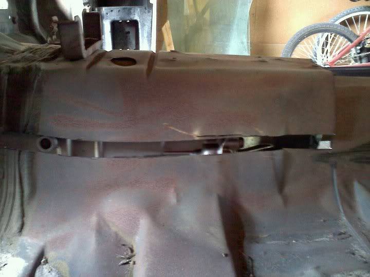

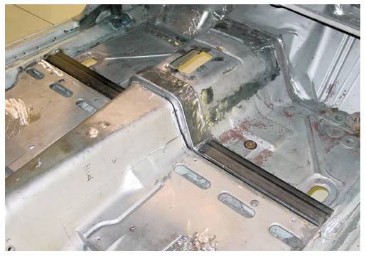

      mock up on the trans tunnel looks like i will need 1 1/2" of steel to fill in what do all of you think if i use some thicker steel from the fire wall all the way down to the cross member to tie the body in a little tighter? hope you all are still fallowing me but the cross member i want to use is the one that DSE built and cuts into the floor like this pic
      i think this will make the body stronger and help with flex also i have to make my own cross member any way so... oh ya i have a pic of the tunnel with the cut out piece on top of the trans i used some 3/4" wood blocks on top of the trans to get room for servicing and adjustment of angles cables wiring etc....... this is what the gap looks like.
      by the way i don't care how much the car weighs i will not be racing it all the time, prob just some road race and daily driving and some auto cross just for fun oh ya and all burn outs i can get away with. lol

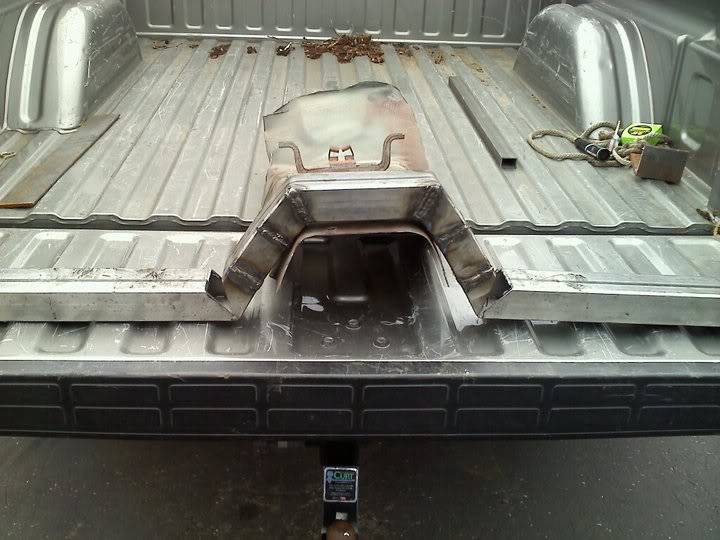

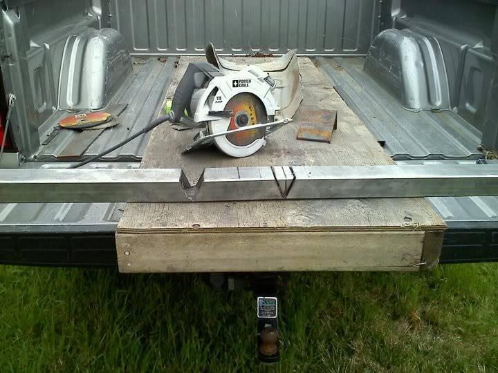

      well I'm done for the day played around with the steel and this is what i came up with keep in mind I'm not done yet so what do you think?
      start found the center line of the steel
      cut outs so i can bend the tubing
      all my cut outs made now on to the test fit
      i welded every thing all up, but the floor piece
      this is just sitting in the car i will have to cut the floor piece to fit it all in

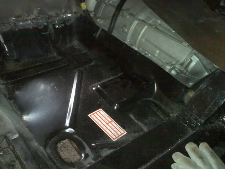

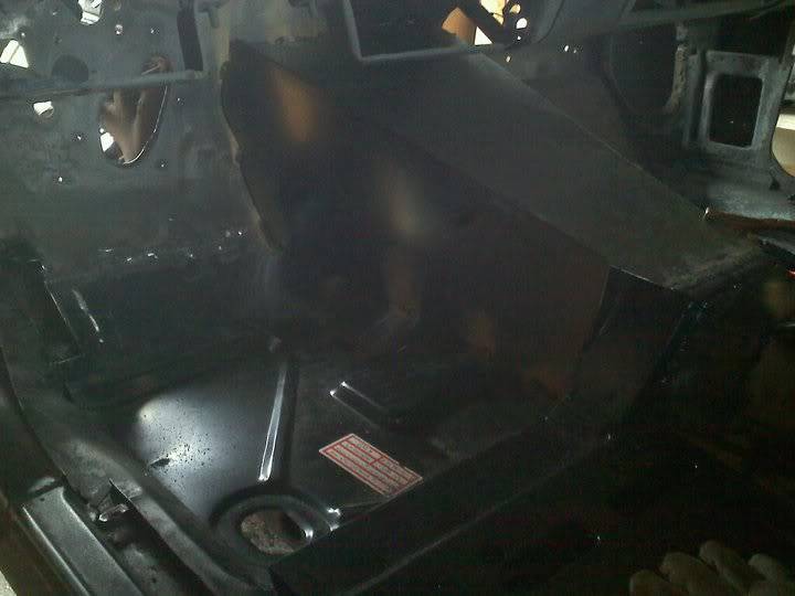

      I cut out the floor pan and fixed some rust in the firewall
      got the new pan to fit nice and tight still a bit more to do and one more piece to make and all my rust will be all gone!!!!!!!!
      started the trans tunnel fab work this will take some time. I get one day a week to work on my car and all I want is for it to be done.
