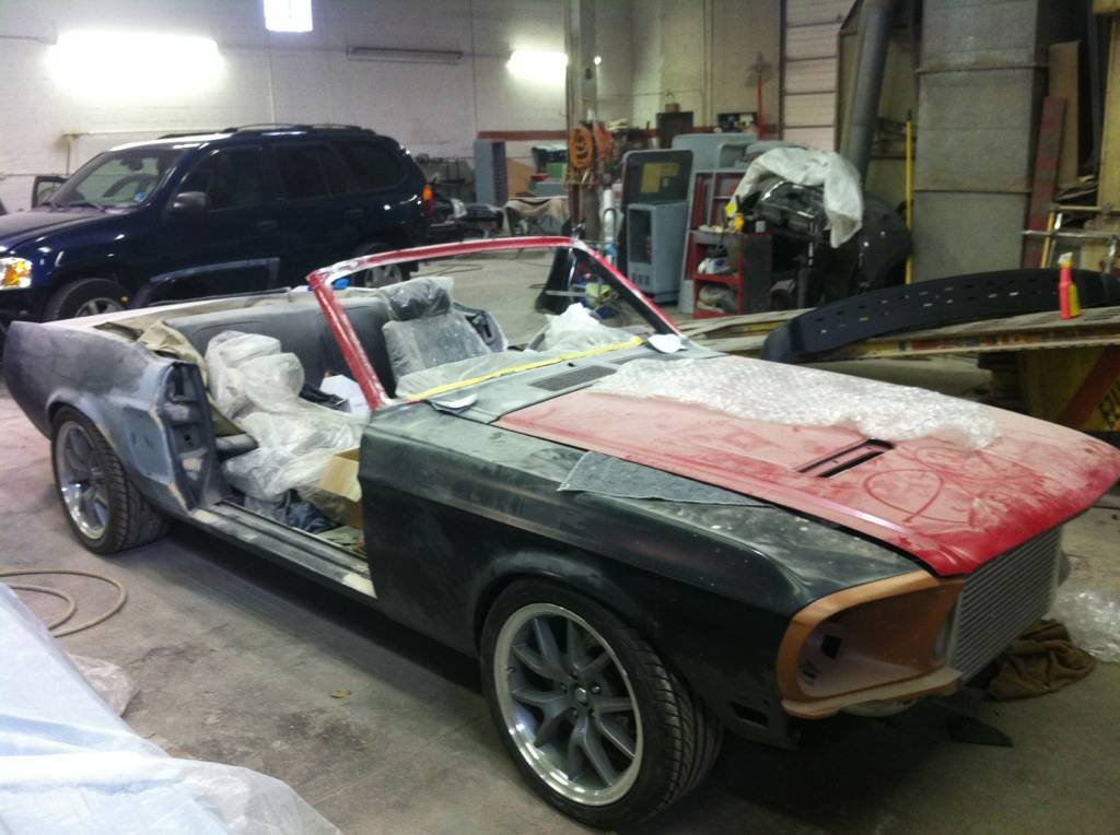

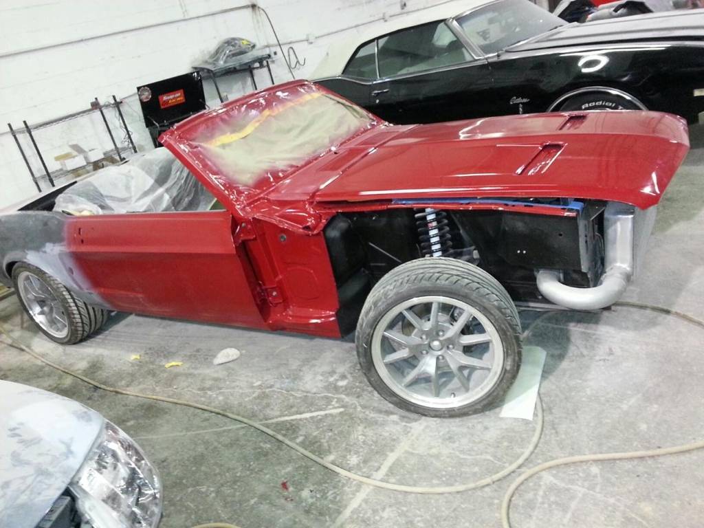

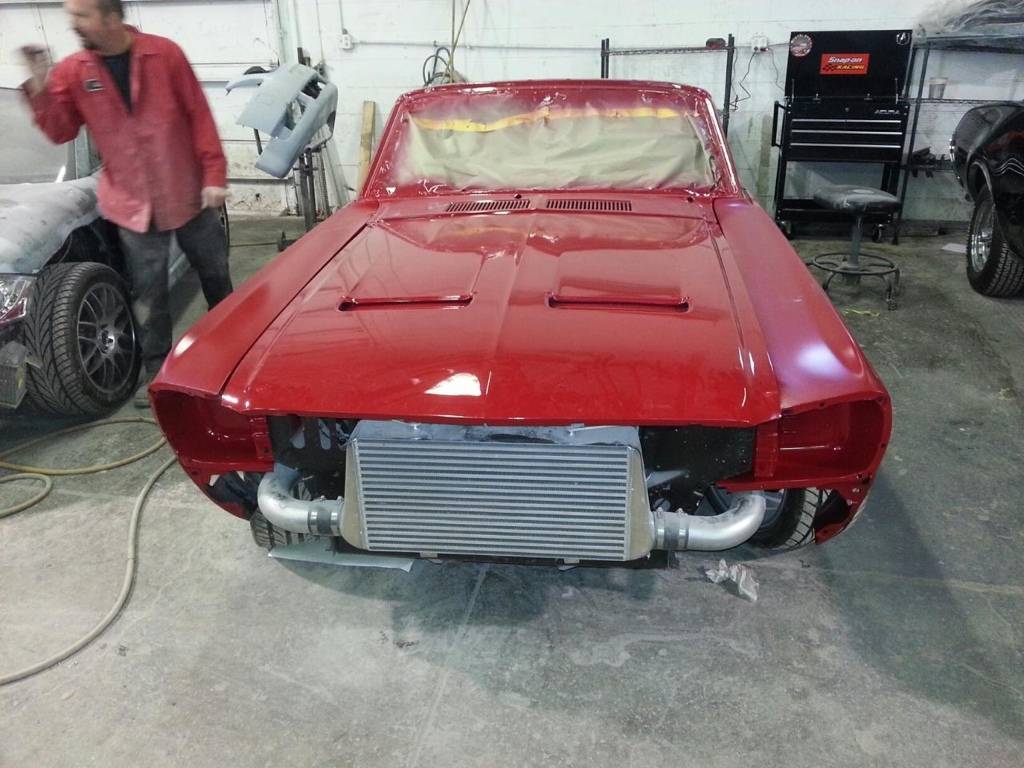

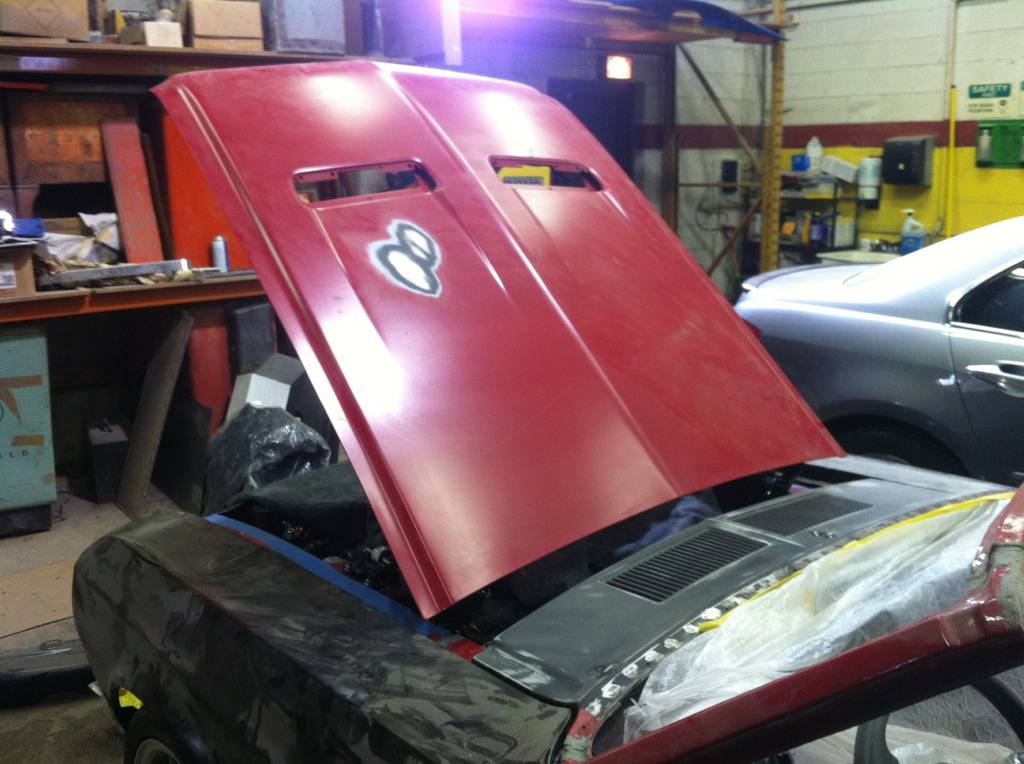

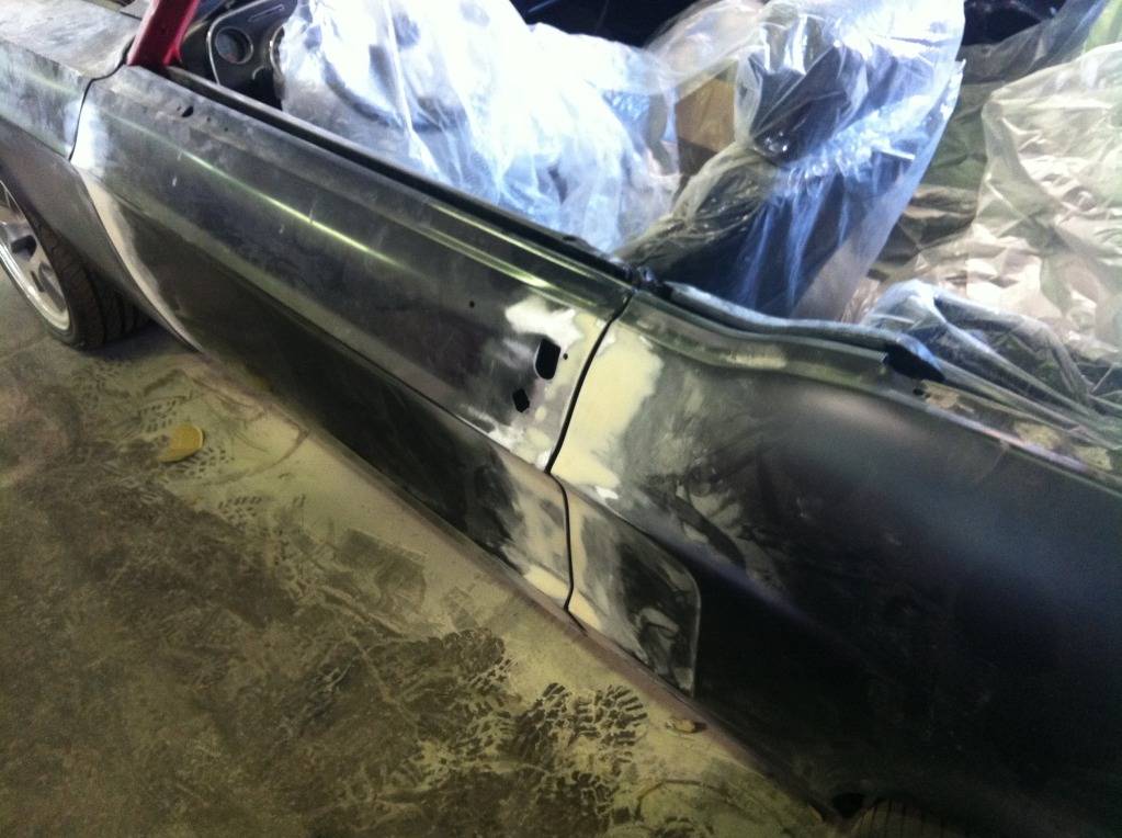

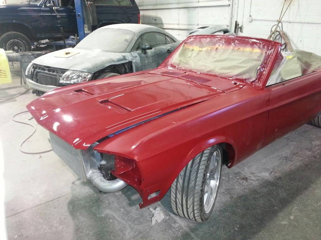

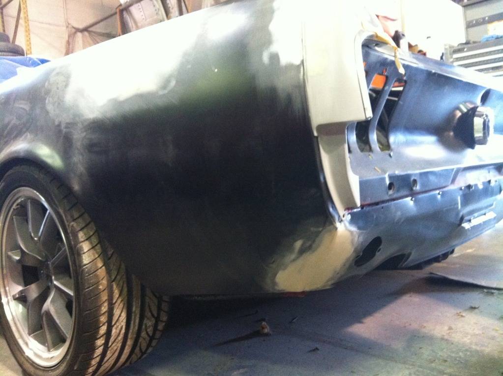

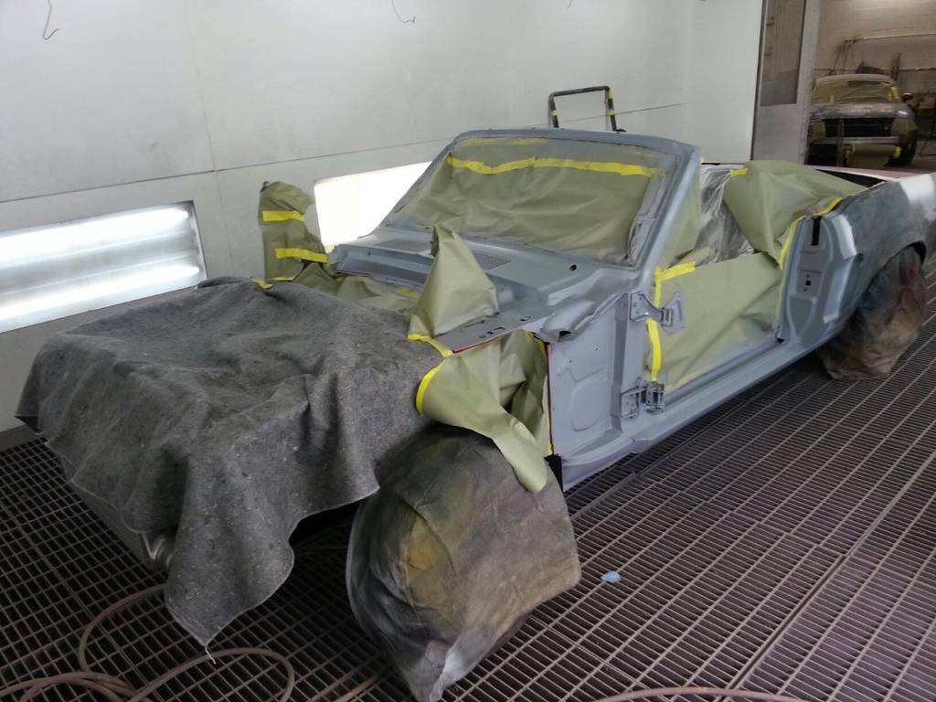

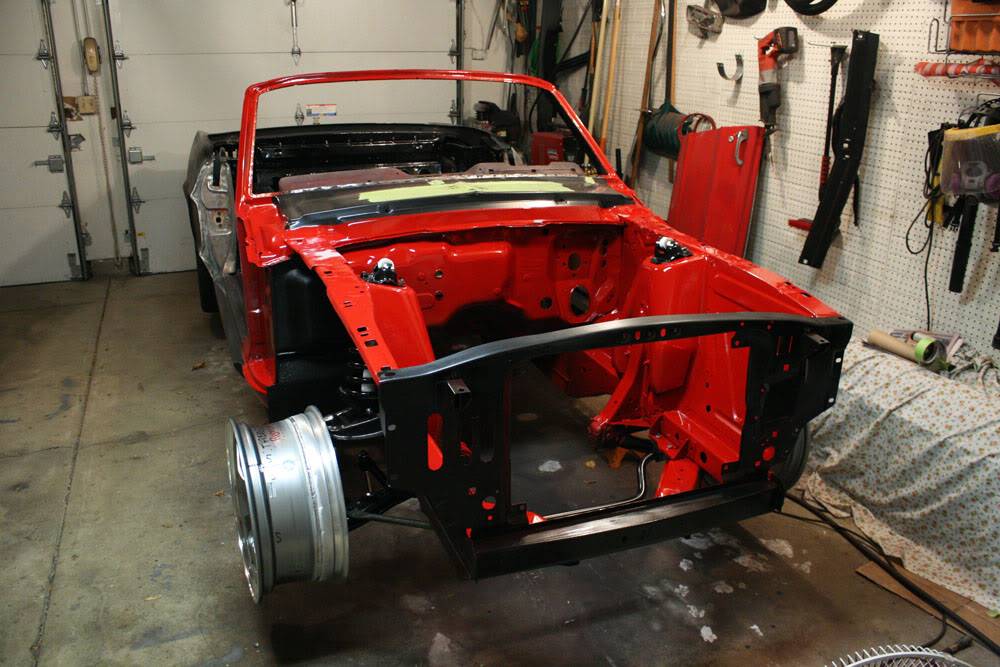

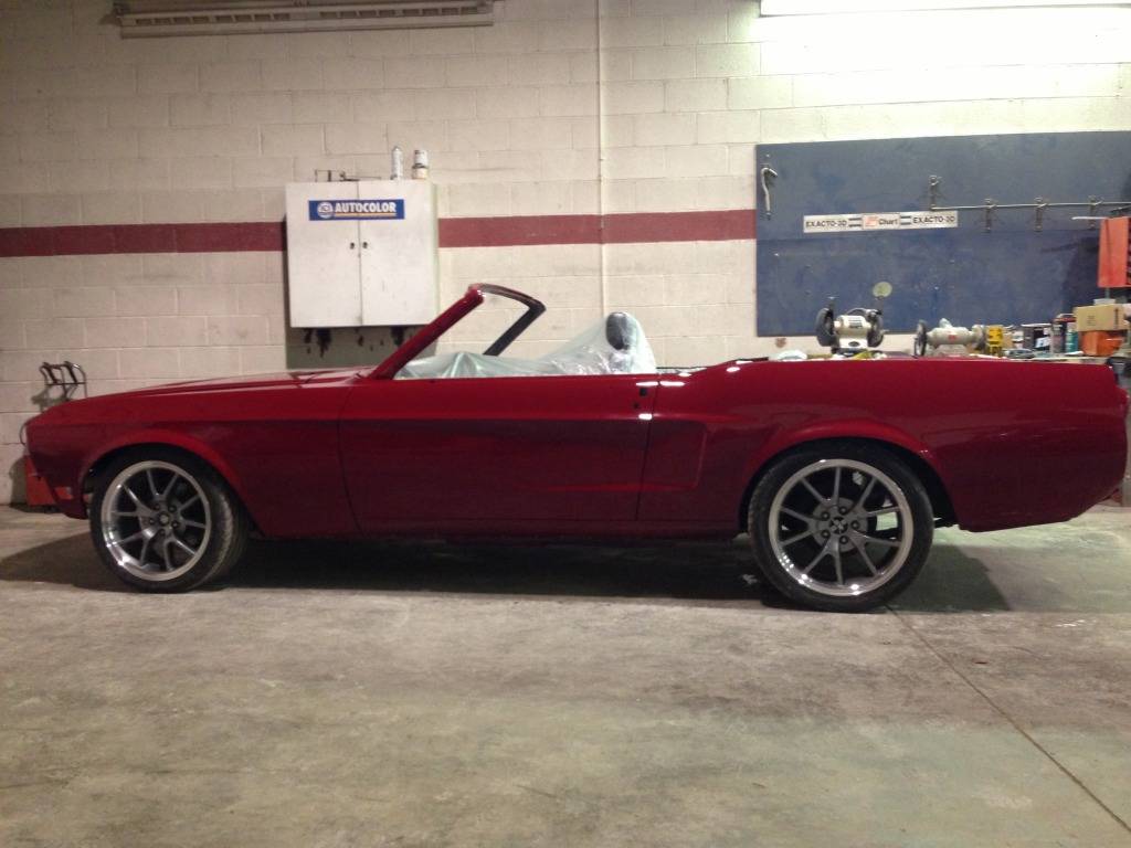

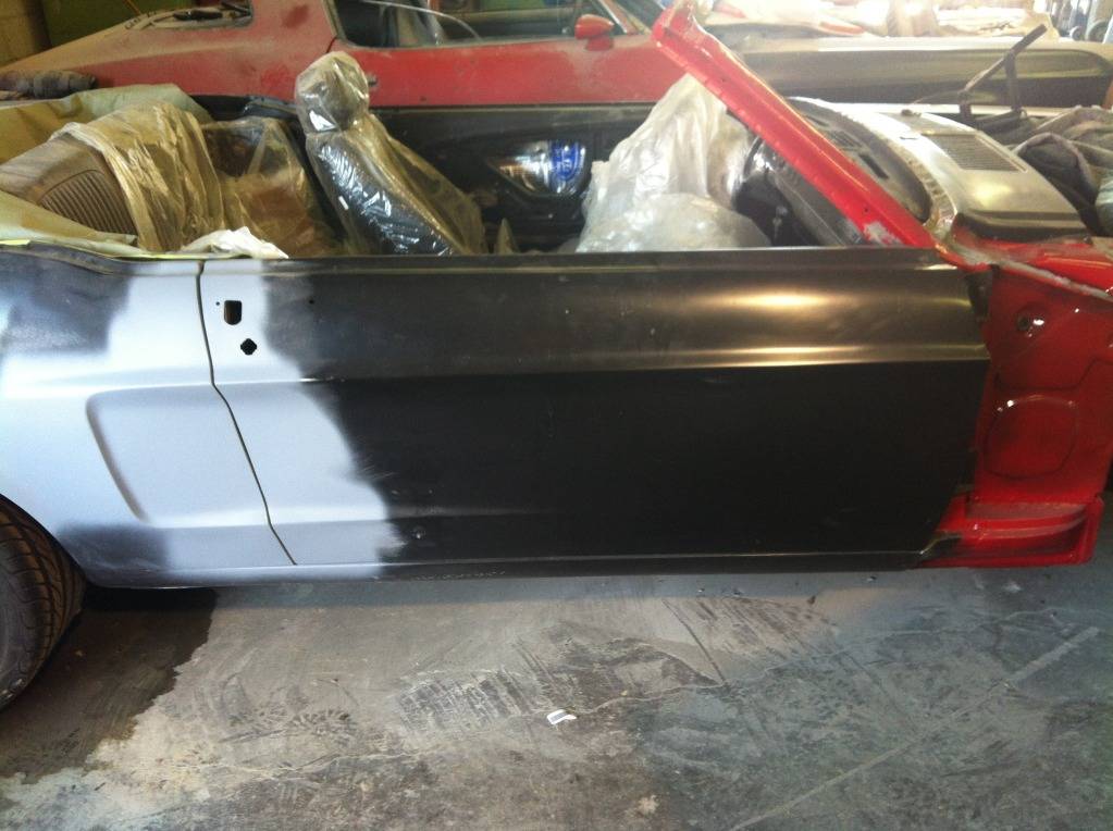

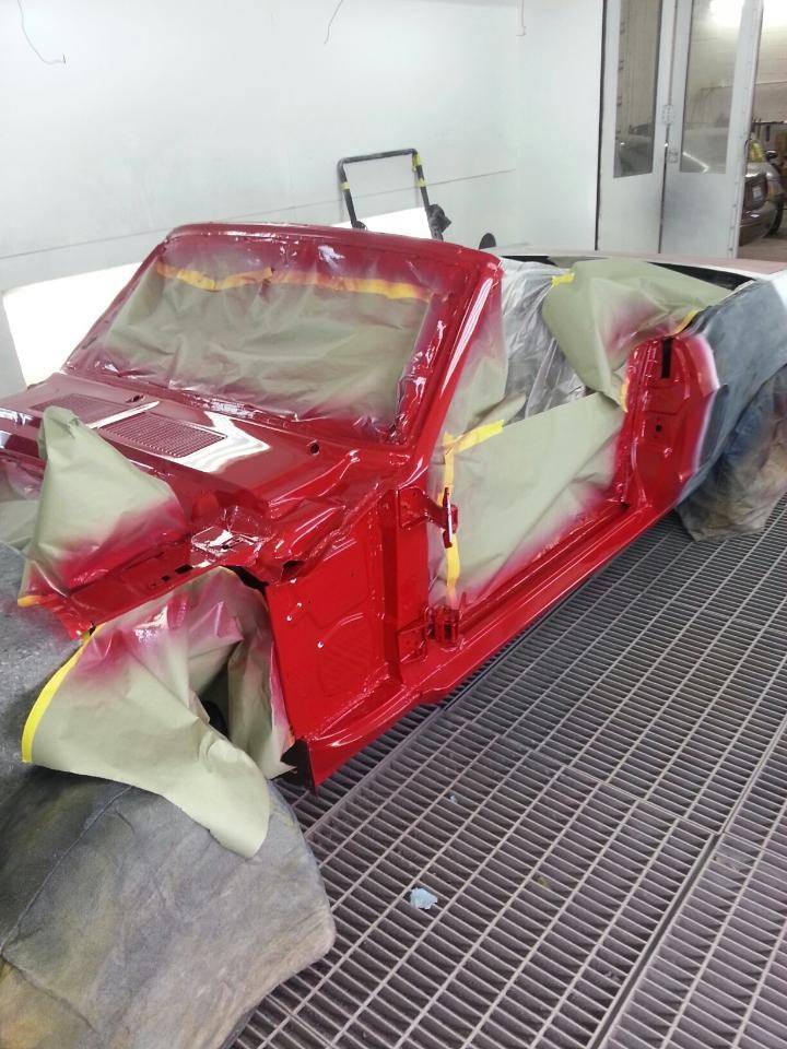

      whoa, it's been a bit on providing an update. Car has been in "paint jail" for the last 6+ months. I took a promotion a year ago and that has left me on a plane 2-3 weeks out of the month :( so at least the bodywork and paint is in the hands of a friend and his shop. I figured it was best to outsource that piece given the time needed to do it right. It's close to being finished after lots of bodywork (panel adjusting, etc..) but coming out awesome.
      Here are some previous updates before it made it to paint

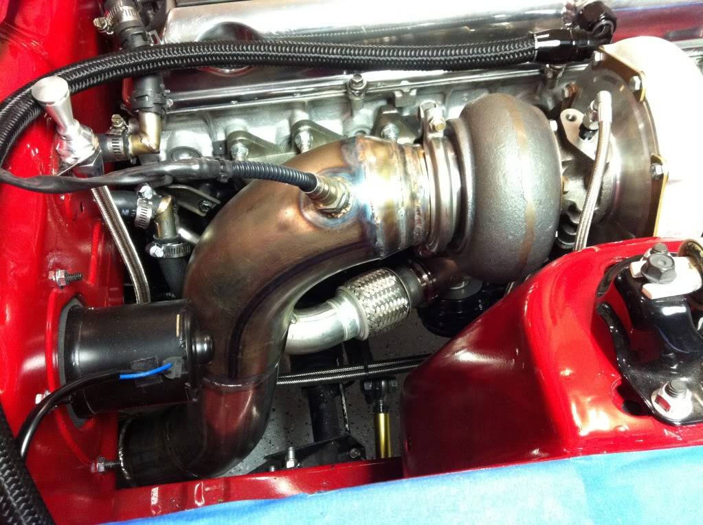

      She runs like a champ, trans is working, no leaks etc.. I have some cams to put in there now to give it some lope
      http://www.youtube.com/watch?v=qVQnK...Vxh84y0eM05FlA
      recirc of the wastegate to avoid the WOT noise
      little 4" magnaflow muffler that I made a dual 3" Y after that will go to a dual setup I'm going to make
      Car as of yesterday
      Once I get it back in the garage I can start wiring up the led sequential tail lights, headlights, put all the weatherstripping on, interior etc.. I can taste it! Getting closer.

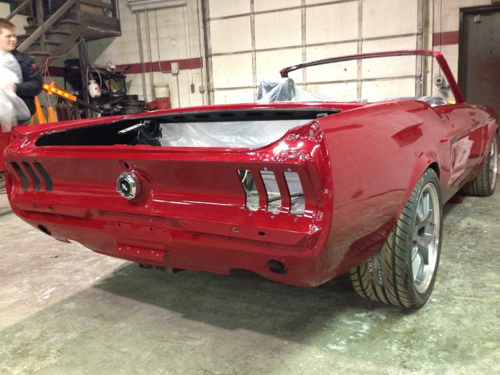

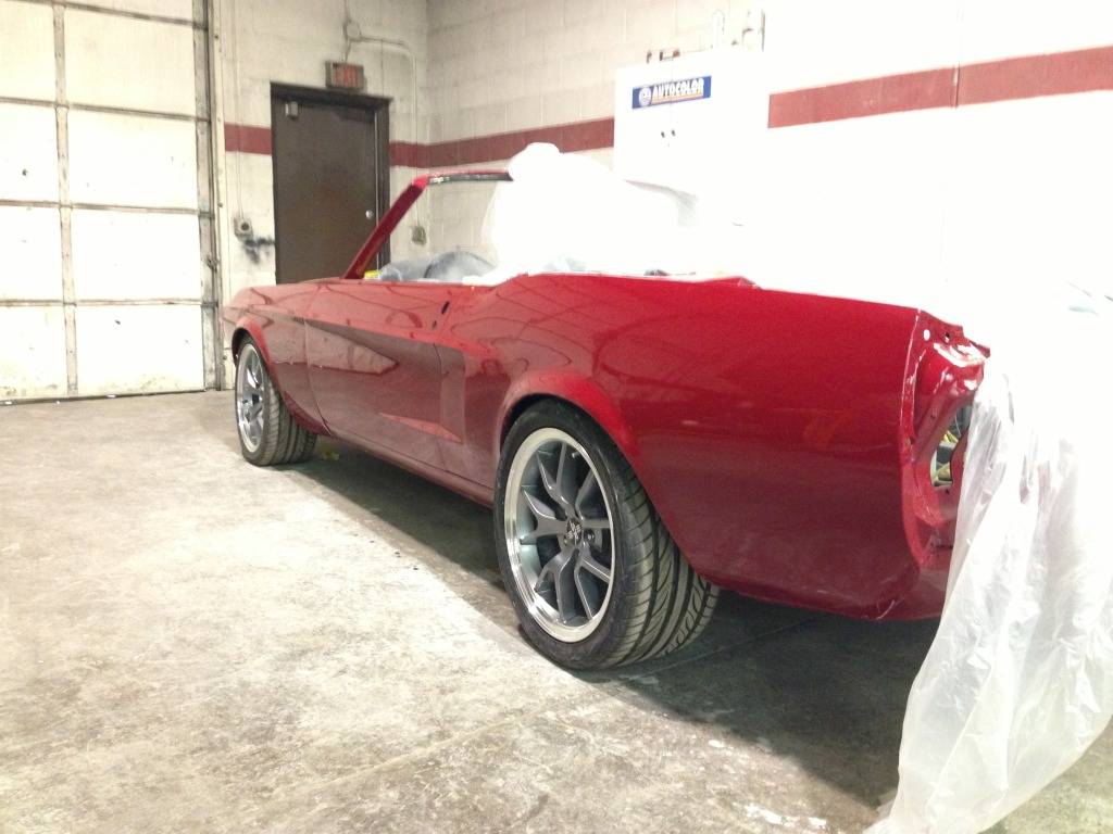

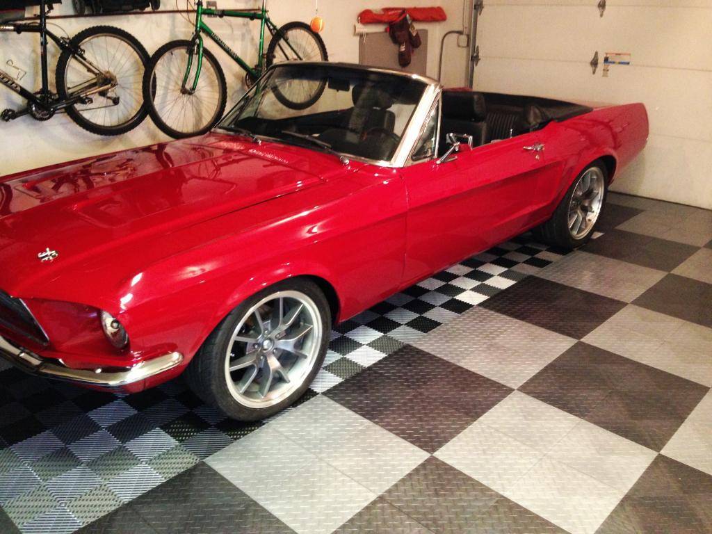

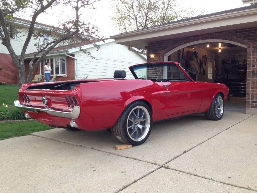

      well, I'm happy to say she's back home and I'm working on reassembling. Paint came out fantastic!!!
      Little wet sanding action
      Chrome parts are going on nicely, needed to source some items I pitched 4yrs ago that they don't make repros for but found them today at a mustang salvage yard online. They'll need to be touched up and polished (top windshield molding of the header (exterior pieces).
      Once I get some of the other wiring done I'll get it to my buddies and have it tuned. Getting closer to a summer cruise every day!
      Chris

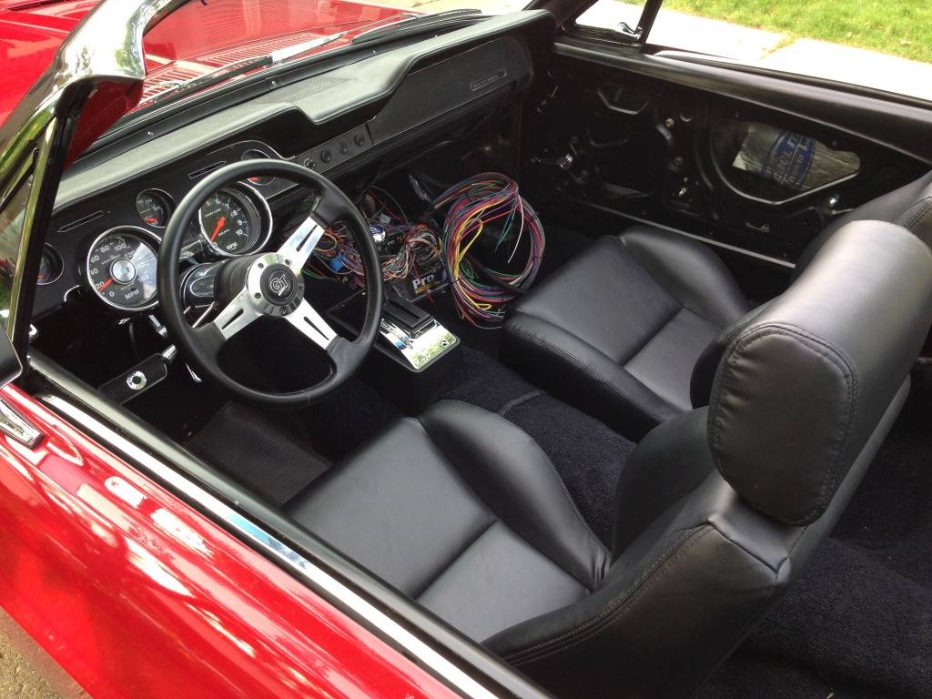

      49

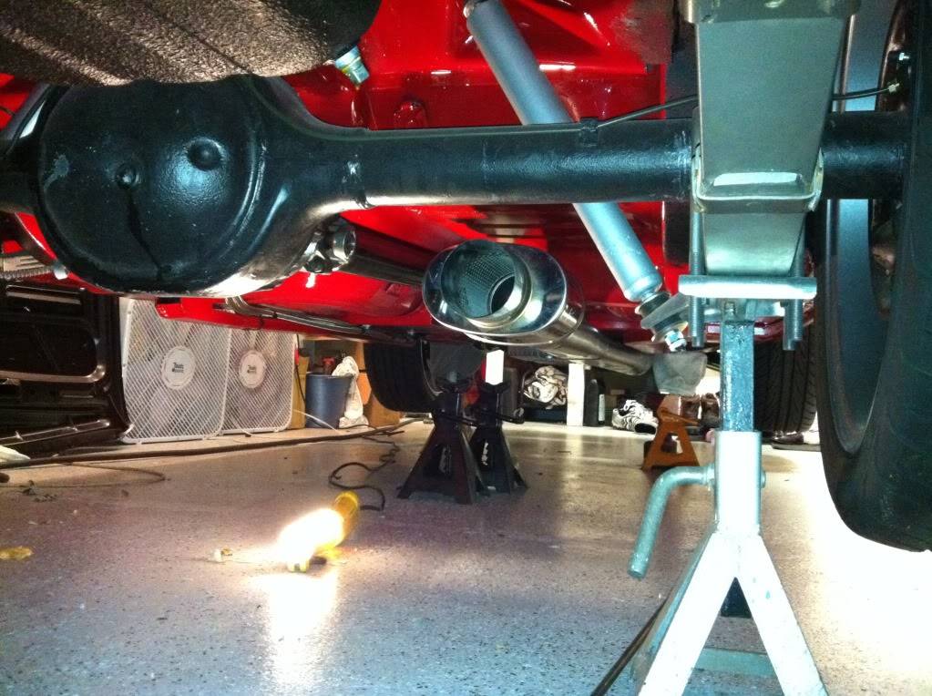

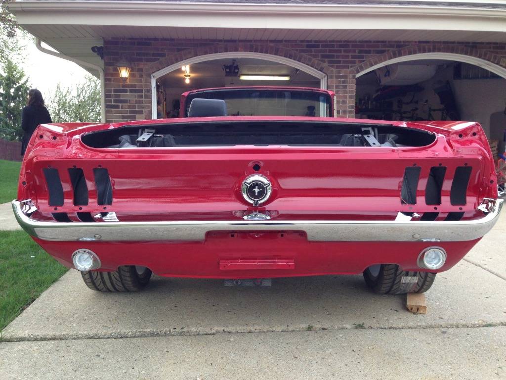

      Making some progress, fabbed up a 4" single to dual 3" exhaust for it, getting glass back in, seats, trim etc...
      Need to finish up the wiring for the headlights, tails, brakes, etc.. as well as tune it for e85.
      Here is a little walk around idling (a tad high). but DAMN that magnafuel is loud lol

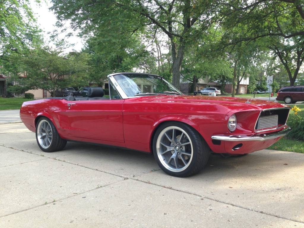

      Car looks great!! What size tires do you have front and back??
      Do you have a pic of the front wheel? I think I've got the same brakes as you on my 67 and wanted to see what 18" wheels look like.
    8. #48
      Jul 2010
      49
      I have 275's on the back.
      Here is a pic of the wheel up front with the tire off. I had it narrowed 1" to clear the suspension
      Quick trip around the block, need to get some wiring done and get her on the dyne to tune.

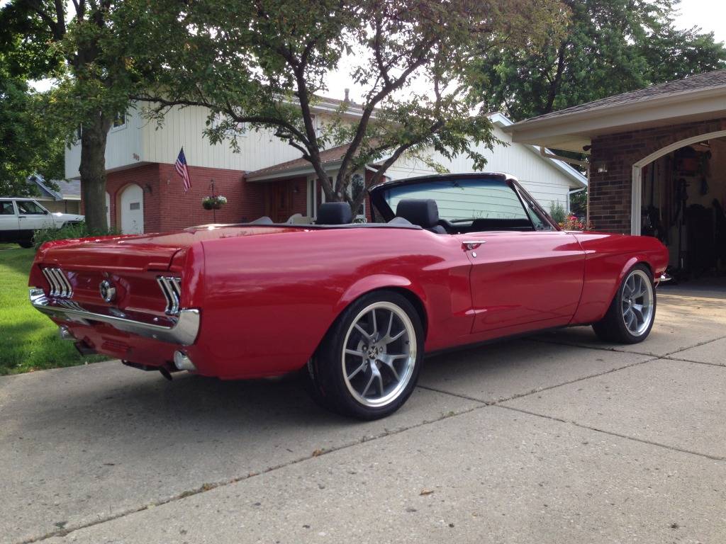

      I've been contemplating selling her and trying to gauge where the price should be set. Still needs some final work but it's VERY close to being done.
      Wiring for headlights,tails, markers
      Source rear lower seat, I have a non coupe one from the previous owner that I didn't catch until after I had the car, it just needs the lower frame and foam as I have a newer lower cover.
      Tune for pump and e85
      Also, it needs a convertible top assembly too.
      Any thoughts as to a fair price to sell it for in it's current state? With work it has been difficult for me to get time to finish, and the kids are so busy when I am home.
      Some current pics
