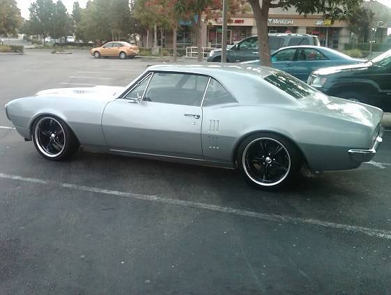

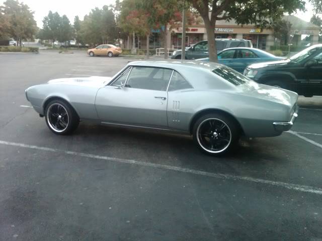

      Yeah for sure >>they be alot of f-me bombs going off as I snag a piece of pavement now and then LOL. Thanks jason Iam still debating on size and ofcourse wheel choice. It will all happen before spring..so I still have time. Here is a picture of a 68 I like this stance!!

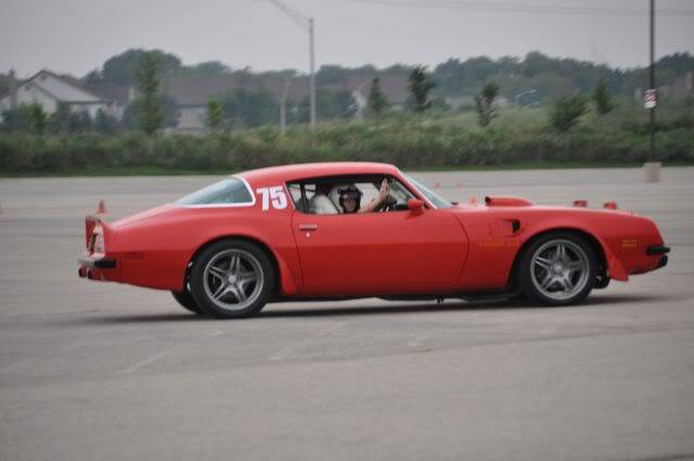

      I have just under 2" of ground clearance under my headders. I have to be careful. I sit 3 " lower than stock.
