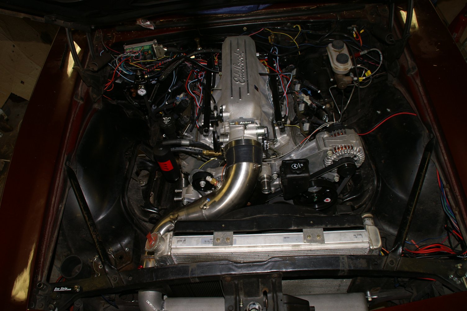

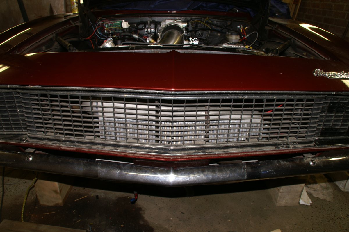

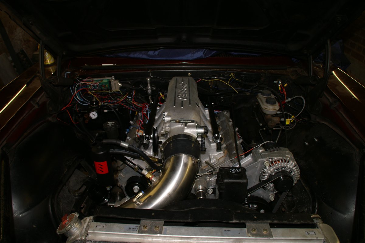

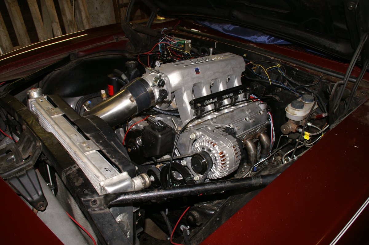

      a small update of the project:
      the LM7 is in. (I draw and built the mount adapter myself)
      with a pro-flo intake. (it fits the flat hood, only by a few mm)
      I also added an intercooler. (threadstone vertical flow)
      I managed to get the RS door-light opening even with the intercooler, and to keep the original hood opening. (I didn't want to drill holes in the hood to add pins.)
      Some pictures of the actual state.
      I still have some wiring to finish before trying to start the engine.

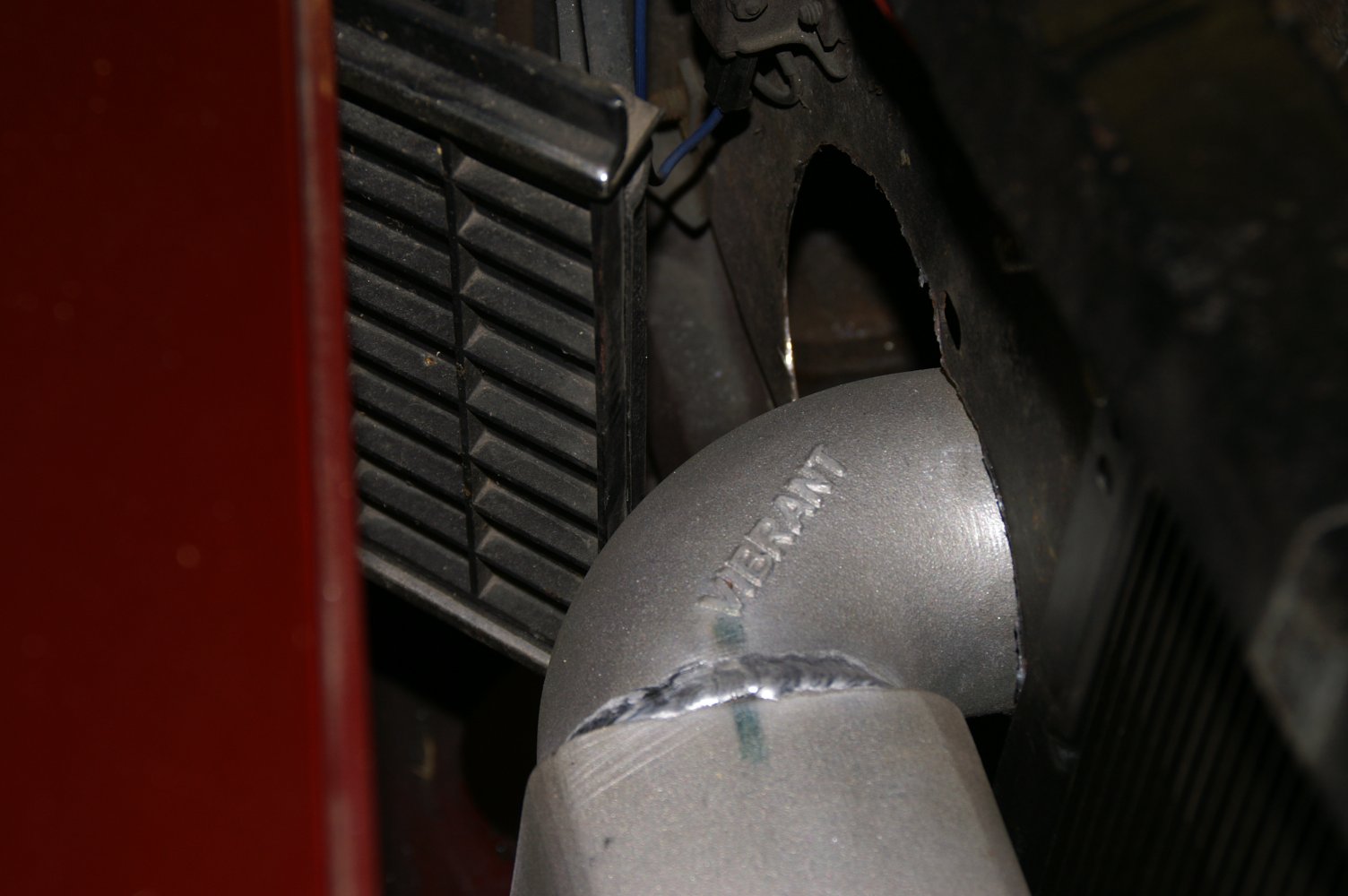

      Some more updates.
      the intake is now in place, bolted, the harness is finished, just needs to be cleaned.
      I draw a coil support and let it laser cut for the Yukon coils:

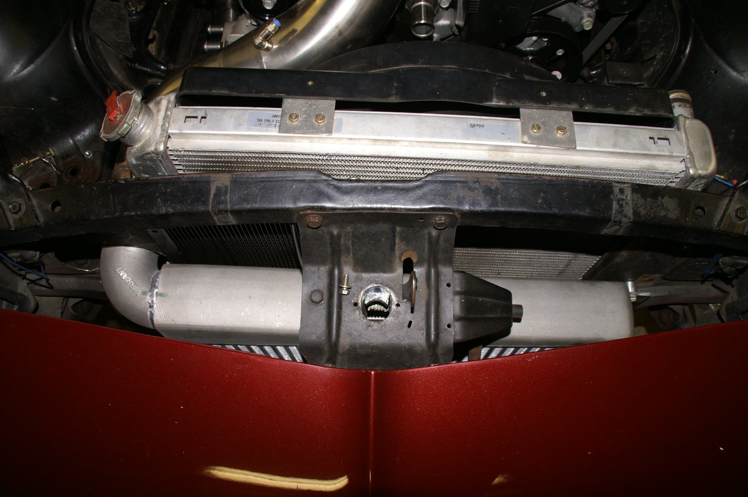

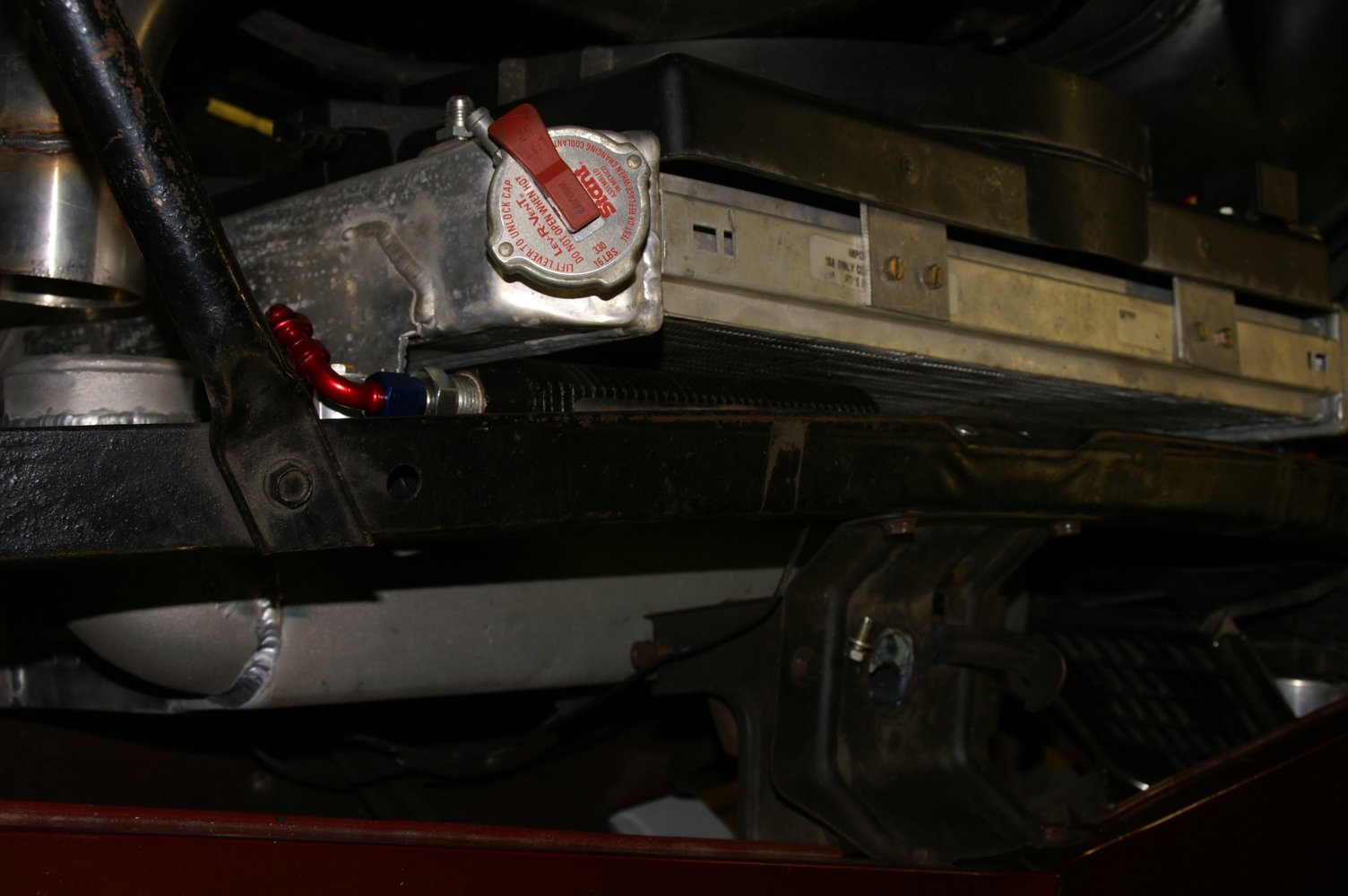

      Closer pic of the intercooler:

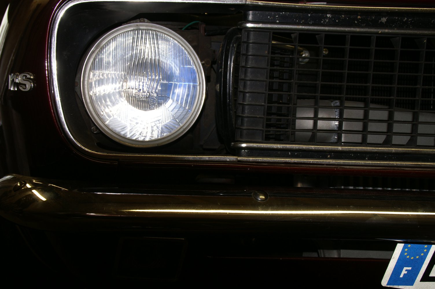

      Nearly no interference with the light-doors:
      To find a place for the ATF cooler, I had to put a spacer on the radiator to push it a bit to the back. I put the cooler between the intercooler and the coolant radiator.
