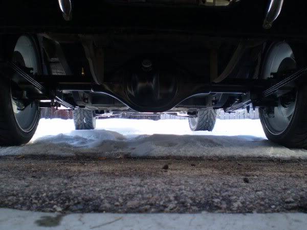

      hey cliff, ill look for you man. i have some 9.5" wide rims with 5.5" BS on my non-mini tubbed 69 with 3" lowing DSE springs and cal trac bars. also running 275/35/18 BFG drag radials.

      Quote Originally Posted by DCx View Post
      69 Camaro exact same wheel size/BS, 275 BFG KDW2s, GW Cat5s - it's close:
      (my first pic and it worked!)
