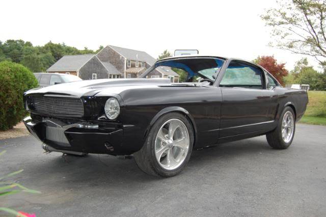

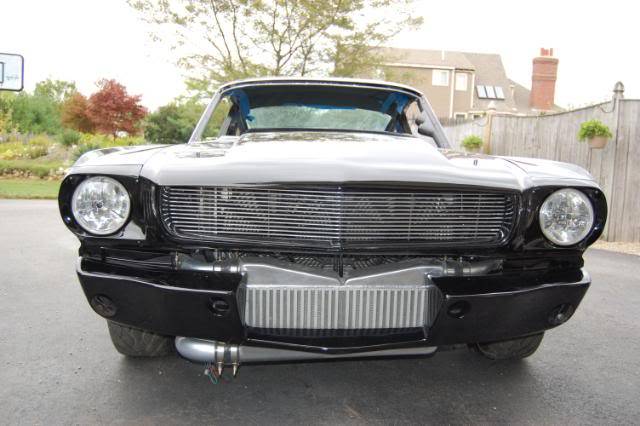

      Finished painting this weekend after shaving drip rails. Still need cut and buff. Hopefully will be able to drive it before the snow flies.

      beautiful build. i like the twin and carb setup. keep us posted with more details

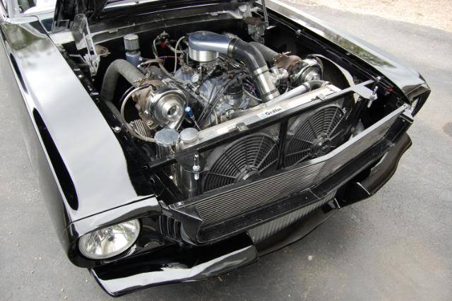

      Thanks for the compliments. 347 stroker, comp cam roller cam, performer rpm heads, holley 650 modified for blow thru, t3/t4 hybrid turbos, top loader trans, 8" traction loc/3.80 gears. Shaved handles, filled cowl vent, blended rear valence, heidts front end. Boyd Magneato wheels, 17x8 f and 18x8 r.

      Nice modifications. I'd be concerned with the 8" failing and the chassis flexing. Are you going to add any other reinforcing metal/tubing... subframes, cage, front end bracing, etc?

      This is the front end which has been greatly reinforced. Also has subframe connectors and a 4-point going in. I agree that the rear may be the weakest link. Plan on doing a 9 inch and tubs next season.

      The front looks stout from the looks of it. I'm use to seeing a cross brace and/or export brace in an engine bay.

      Thanks for showing the picture of the front end without panels. I was wondering how you managed to get everything in that small engine bay. Car looks great.
