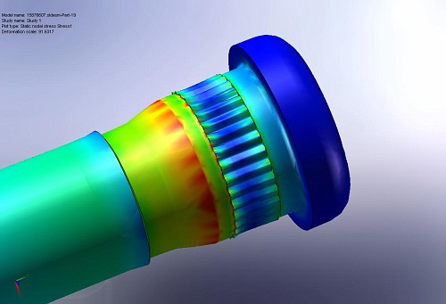

      Local guys are discussing wheel stud failure because one of the younger guys lost a wheel and it got me to thinking about reasons why. I put this together based on my experience and what I think is common sense. Can any of you smarter types tell me where I am wrong/right? Considering the safety aspect I figure it is a proper discussion here.
      *Lugs not tightened enough (I bet the #1 reason)
      *Lugs overtighted/studs previously stressed (I bet a very close 2nd). I'd think this will also over stress the head (flange) of the stud, weakening it.
      *Lugs not tightened in proper pattern
      *Lug nut wrong seat (common with replacement wheels, esp aftermarket)
      *Wrong lugs (ie metric nuts on SAE threaded stud)
      *Not enough thread engagement (common with replacement wheels, esp aftermarket)
      *Previous rim damage (nut seat damage, non-hub centric makes it worse)
      *New aluminum rims not re-torqued after a few 100 mile cycles. (seen that)
      *Wheel not properly seated at time of mounting, perhaps due to corrosion on wheel and/or mounting surface preventing proper seating. And aluminum wheels corrode too, or wheel not fitting properly over hub (esp w/aftermarket wheels)
      *Improper installation of stud (ie with impact gun instead of a press)
      *Hub/flange failure due to improper/oversized studs being installed
      *bolt pattern mis match (ie BMW wheels on a Camaro)
      *Cyclic, fluctuating loading - why the drag guys running such grossly oversized wheel studs to compensate for the shock loading at launch. Under-torqued lug nuts will almost immediately see fluctuating loads and lead to premature failure
      *Too much HP
      *manufacturing defect (poor hardening, etc)
