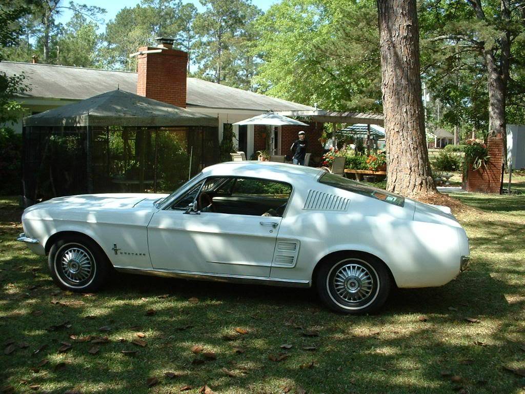

      Here is a pic of my lastest project. Bought it in April. One owner car with 289 v8 automatic. Have big plans for it and open to any suggestions or feedback.

      Yes ......leave it alone! It looks great asis!!!!

      [/IMG]I like them stock as well but plan on doing some upgrades. Hopefully tasteful upgrades that could be returned to stock later.
      Added some 17" wheels and have a Baer brake kit for the front

      DO IT! too many perfect trailer queens out there. So much more fun to build a car that you can go out and flog when you're done.
      I say Bullitt with a twist. Instead of FE power, go for something nuts like a 4.6L terminator (tricked) and T-56 trans with 9" out back on a 3 link. Big brakes and 17 or 18 inch wheels. M2 IFS and coil overs up front for clearance.

      No take the advice from someone that did it and didint like it ........
      It looks great clean it/detail and drive it !!!!!!!!!
      What ever you do DO NOT install a M2 front end!!!!!!!!!!!!!!!!!!!!!!!!!!!!!!!!!!!!!!!!!!!!!!! !!!!!!
      If you really want a M2 pm me I will cut the Heidts out of mine right now and sell it to you!!

      Great looking stang. I have no idea what you should do to it, but I hope you drive it, ALOT!

      Great looking ride. Toss some wheels and tires on it and enjoy it before you spend all the time and money trying to rebuild it. The "while I'm at it" changes will take all your time and money...

      Drive it now. The car is fun as is. I would keep it Wimbledon White an black interior.
      If you are going crazy then whore yourself out and put the new Coyote 5.0 in it.

      Leave it alone? I thought this was a board for guys who build cool cars LOL
      There are plenty of stock restored Mustangs out there and unless it was some rare, one only type, of deal, I say improve it.
      I do agree with the guys that say Don't MII these cars. The only thing you really gain is engine compartment room. Rack & Pinion? You can add it to stock front ends. Disc Brakes? same answer. And with TCP or Global West stuff, you get a better responding front end with a better camber curve than the MII stuff.
      I sold a 62 Ranchero a few years back to a Ford Engineer that worked in Dearborn. We were discussing my Falcon Convert as I was considering doing an MII myself at the time. He told me there was a group of Ford Employees that were dedicated to the early Mustang's and Falcons and that a couple had experienced cracked windshields in convertibles after doing an MII conversion. So they played in the Cray Super Computer and did some finite stress analysis on the front of the cars. What they found was the elimination of the shock towers was causing enough movement in the front end and cowl to cause the windshield breakage. Not enough to cause frame cracking or anything on non convertibles, but it did show that all the cars were moving around a bit. He also said that the Mustang's were worse than the Falcons in this regard. They concluded that doing this type of arrangement really called for adding bars from the firewall to the lower frame rails at a minimum to stop the movement (similar to most Nova front clip kits).
      As for the Fatman Strut conversion, that is really going back wards in my opinion. You get just about 0 camber gain with a strut front end. Why do you think after all those years Porsche went to an A Arm type arrangement on the 911's? I can't really think of any serious race car designs that are using struts unless the rules say the car has to keep the original design.
