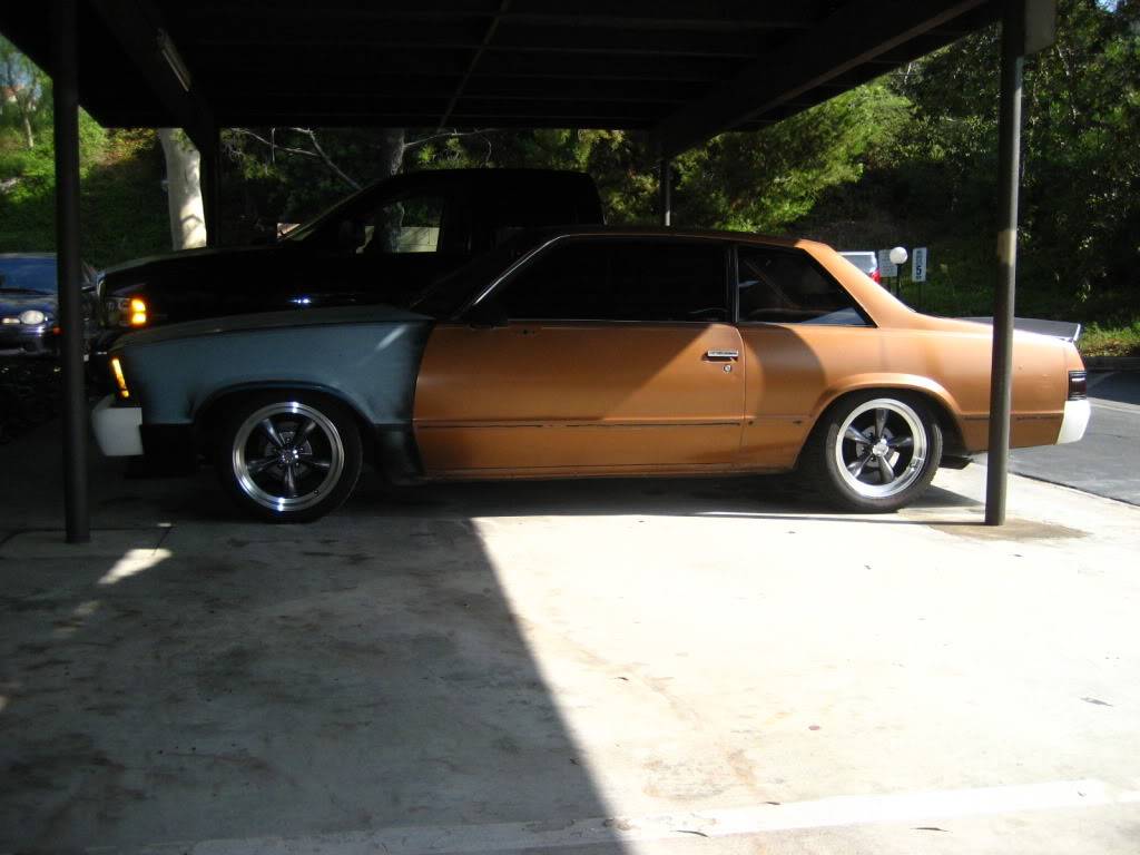

      Well honestly b/c I don't know the exact drop the car has now b/c I was out of cash at the time from getting it together so the springs are cut. But I love the stance and want to be able to get back to it, w/out having to cut springs. I'm afraid if I get the 11's they will be too tall. Plus these are the ones my buddy has on his pro touring regal with a ton of other wicked suspension and his car sits where I want mine too as well. I have zero aluminum nose parts... its still an iron headed sbc. I'll definitely check into those bilsteins. I had them on my old DD that had some suspension work and loved them. I still don't know what to do about lowering the rear? Somebody on here in a previous thread said they used the afco or tru coils for the rear but I can't find them on speedway anywhere... at least none that fit the perches. Here is the stance now... could maybe go a tiny bit lower in the back but I like the rake to it and the front has gotta be close to 3" easy.

      go with the rear CPP A-body 2" lowering springs for the rear,perfect drop I have them on my 79. kyb or bilsteins for shocks will get the job done.

      What size tires are on the front and rear of your malibu... those are 17" wheels right?
      Looks sweet!

      Yes they are 17's 17x8 all around. front 225/45/17 rear 255/45/17. also check out this site www.gbodycentral.com.

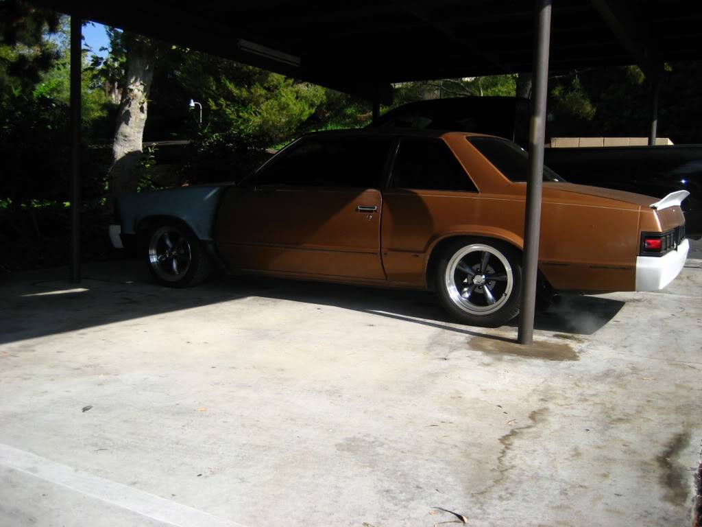

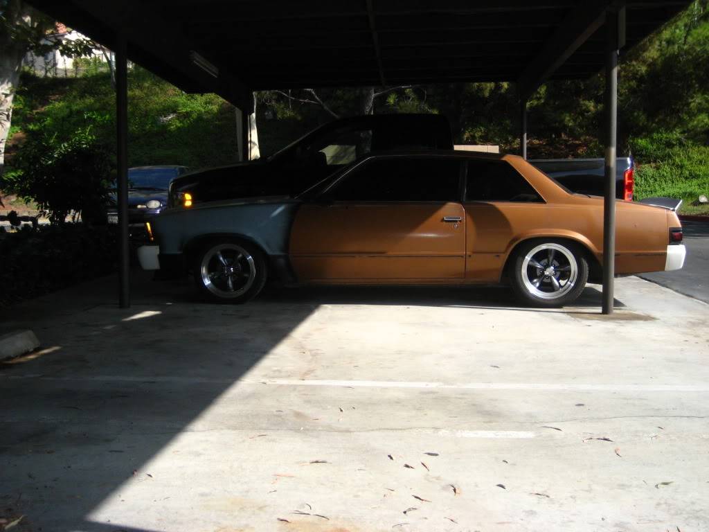

      CPP (classic performance products) rear A body 2" drop spring on a g body

      Sweet, I looked at the bu on your car domain, and it looks taller in the pics on car domain.. were they before you put the 2" drops on? If it sits like you've got it in the pictures on here with just the 2" drop springs then I'm definitely going w/those for the rear and the circle tracks springs in the front w/adj cups.

      Yes,those are before pics,the ones I posted today are the a body coils
