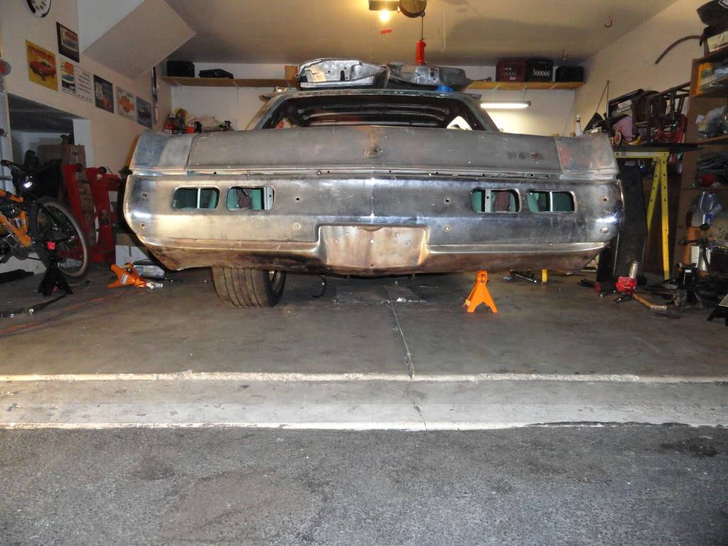

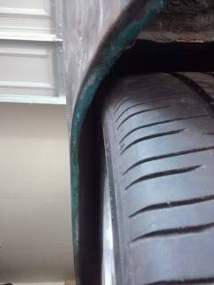

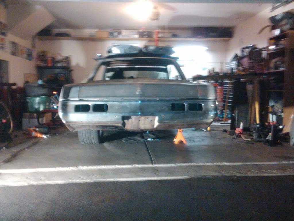

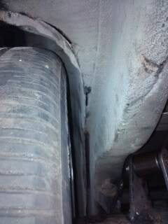

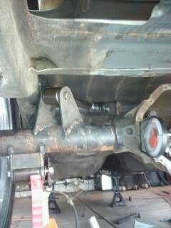

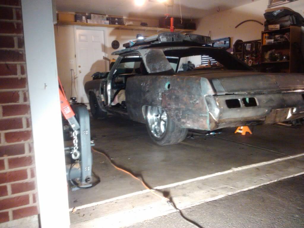

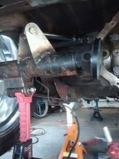

      Well I had the day off today so I decided to finish what I wanted to finish sunday. 4 Link is done minus shocks and I got to set it on the ground. I have some crappy camera phone pics and I will post more later. I did manage to get the ride height I wanted and I have room for 3 inches of up travel on the suspension before heck breaks loose on the inner wheel wells.
      285/40/20 just clears
      ride height established and I'm happy to say the roofline is 51.5 inches from the floor.
      Monday we are going to throw the doors on and roll her outside for a naked photo shoot

      I can't wait to get the drop spindles for the front she's a bit nose high

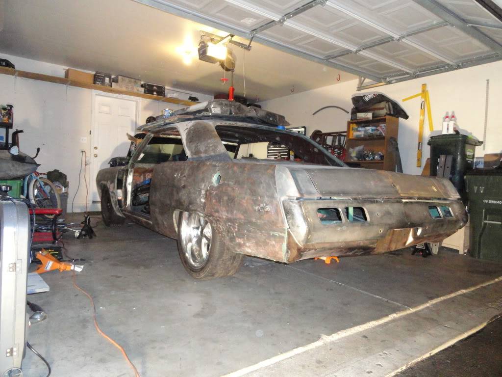

      I also forgot to mention earlier in this thread I have been tossing around the idea of taking some sheet metal out of the top. 3.5 out of the front and 3 out of the back BUT I have never done a top chop before and the rear glass really makes me nervous. I'd like to be able to cut the stock glass down but if I do commit to cutting the roof the height will go to 48.5 inches to the roof line and look sick as hell.
      Aug 2010
      Lisle Illinois
      184

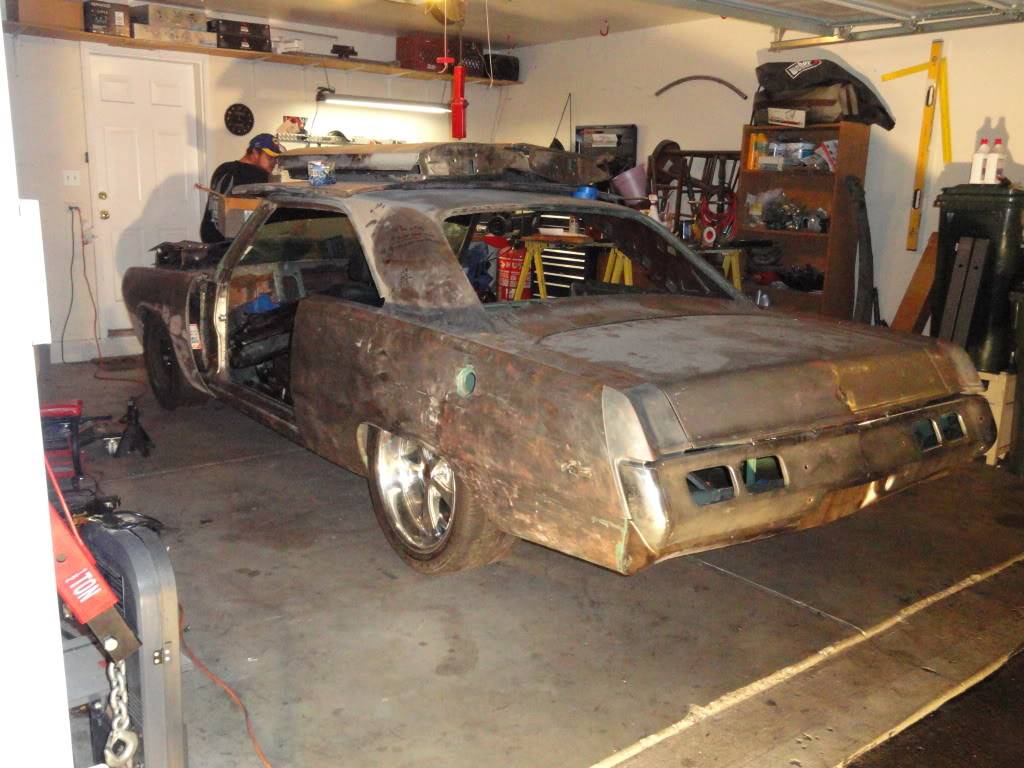

      Better pictures
      Getting a feel for my new BMW 8 way adjustable power seats, yes thats an 06 magnum center counsel

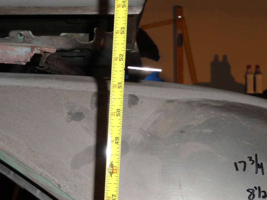

      And measurement at the roof line

      Looks good. That 285/40/18 seems pretty tight to the fender lip (assuming that's the front since you are running 20's out back). Will you still have clearance at full lock?
      Will Ellis
      Build Thread
      Aug 2010
      Lisle Illinois
      184
      thats the rear lip
